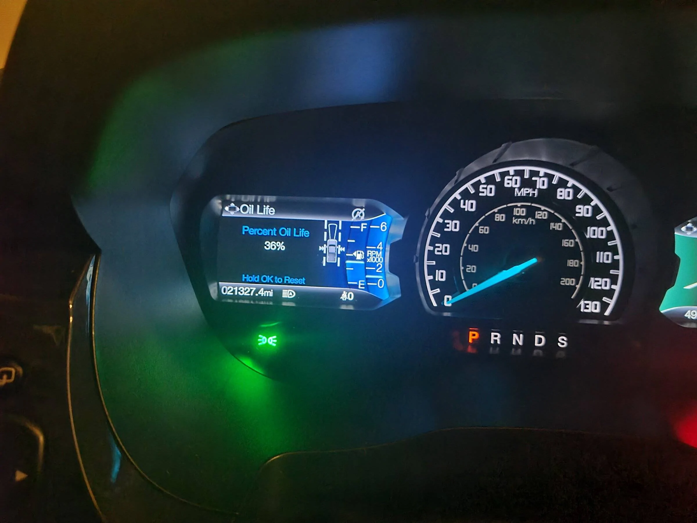

I change my oil at 5k. The IOMs on my last 3 Ford's always say 50%life left. This over the life of the vehicles, regardless of primary driver or conditions.
From what Ford says length of trips, temps etc, do come into play. But for the life of me I can't replicate that in reality.
I just took an 1800 mile all interstate road trip. Which pushed my current oil change interval out by at least 1k miles. My truck is not babied in normal driving at all. So IF conditions come into play I would expect my IOM to still be showing roughly 45-50% life left. If not, and it is purely mileage/time I would expect 35-40% life left.
I'm headed out for work in a bit. I'll report my findings. Betting it shows 38% life remaining.

I was wrong. 36% life after 6327 miles. 1800 of which were pure highway.
Normally with my aggressive city driving I'm at 50% after 5k miles.
The Ford IOM only measures time and mileage.
