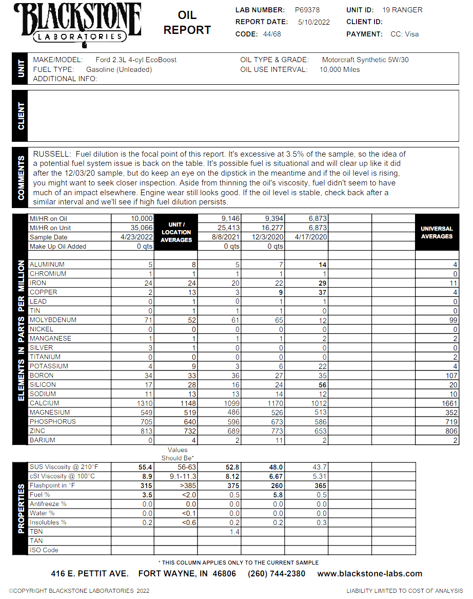

The correct answer here is 10,000. There's fuel dilution in the winter months, and none when my 8 month OCI spans only warm months

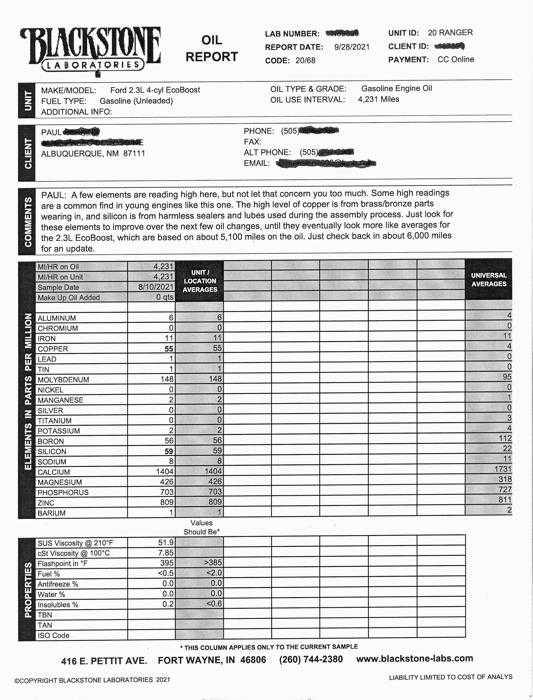

5,000 miles under normal conditions. Two different Oil Analyzers at Blackstone Labs told me that they haven't seen any evidence yet that oil with 5,000 or less on it has revealed any particular issues regardless of the type of oil as long as it meets factory specs. I questioned this when they did my 1st analysis at 4231 miles.
