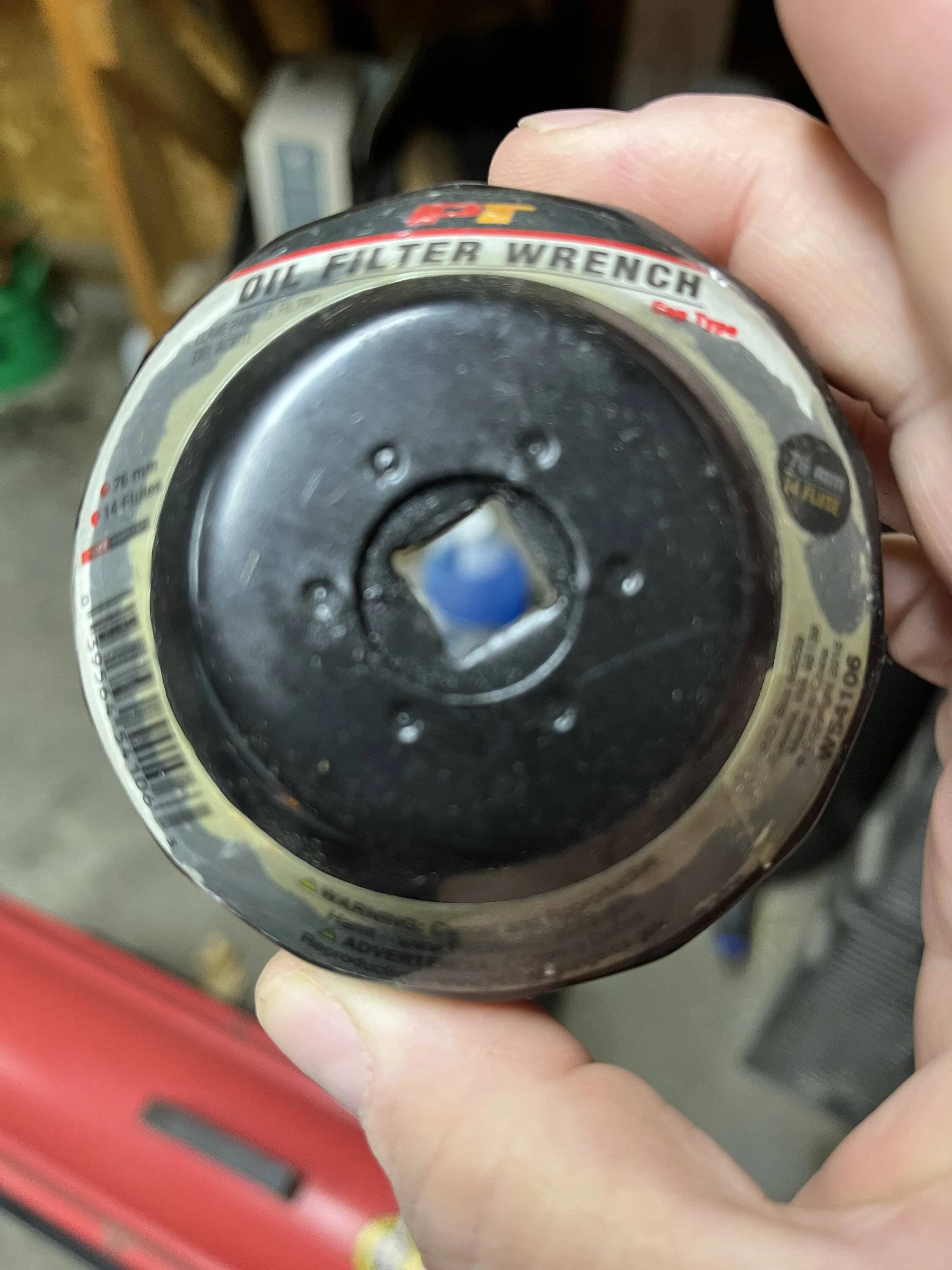

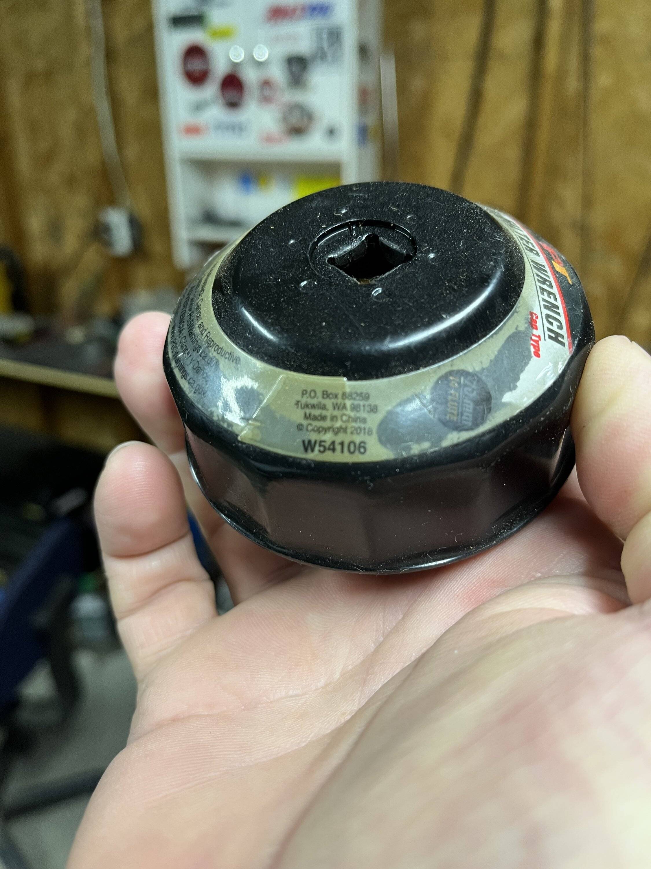

Thanks! Two things I’d like to solve are an easier to remove skid plate (is tilting the truck easier to get to the drain or would the ValvoMax help with that also) and an oil filter wrench. Man, both of those make this not a 10 minute oil change in tight driveways.
With the Valvomax no removal of the skid plate is necessary. A clear plastic tube is included that hangs down to your drain pan. I have a filter wrench that on a long extension loosens the oil filter. I dont remove the tire or turn the wheels to remove it. Not that far of a reach. I think the wrench was $6 frim Autozone. I'll check the # on it and post it up this pm when I get off work! Hope this helps!

Thank you. I am stock but have 32” tires (from the factory). That wrench would be awesome, no rush but would be nice to have for every future oil change.

Warming the Ranger up decided to take a pic real quick. This wrench fits the Motorcraft filter perfect.

Thank you!
