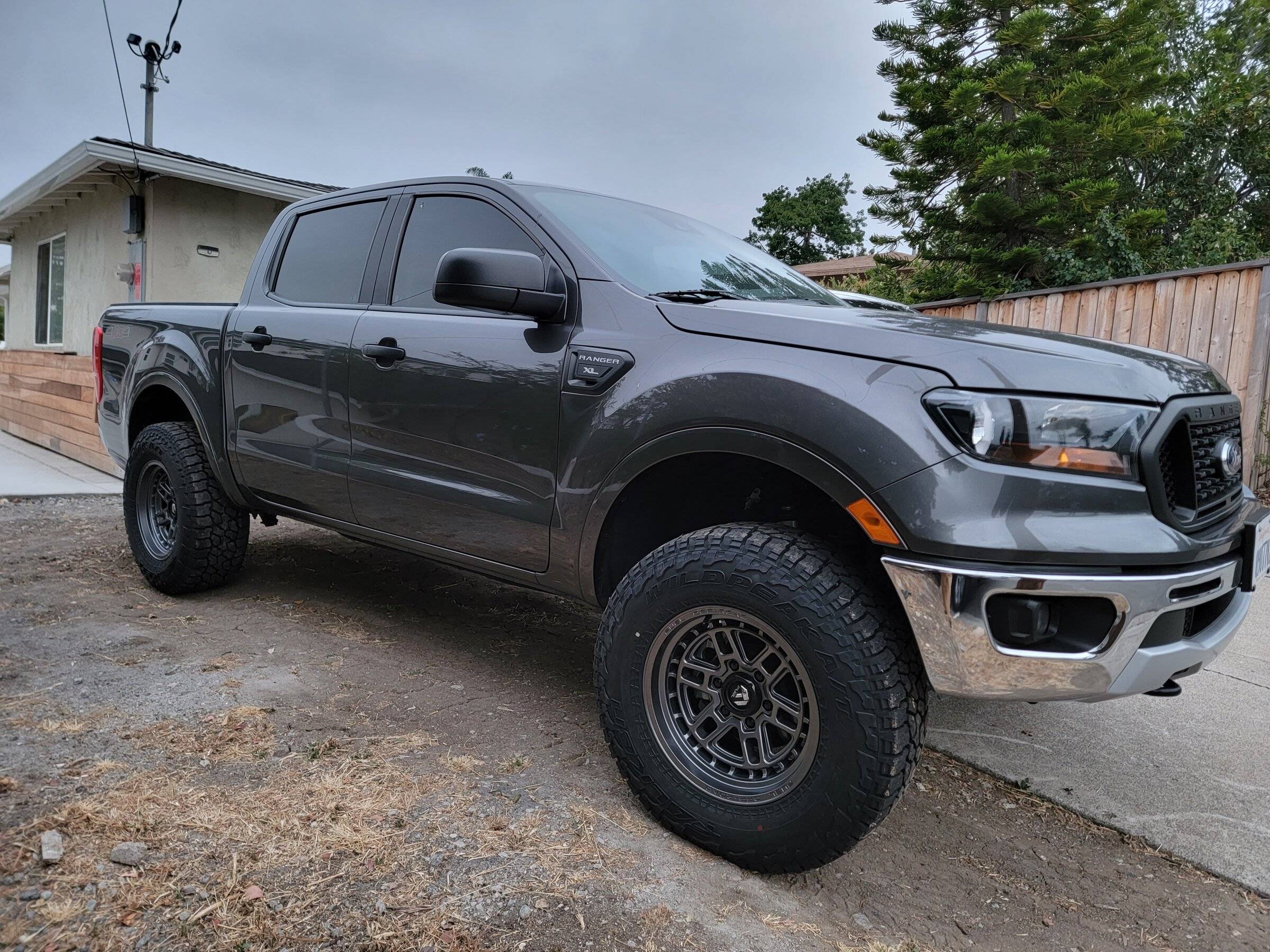

Here's mine with the FP Fox 2.0 lift and Firestone Destination XT 255/75R17 tires instant.
That looks perfect—exactly what I'm looking for with my truck. It's interesting that the FP Fox kit comes preloaded at the correct height while the regular Fox kit does not. I'm dreading another trip to the shop just to have them take everything off, adjust slightly, then reinstall. In fact, I don't think my current rake really warrants that much time and expense. I'm hoping just a new set of tires will make the difference

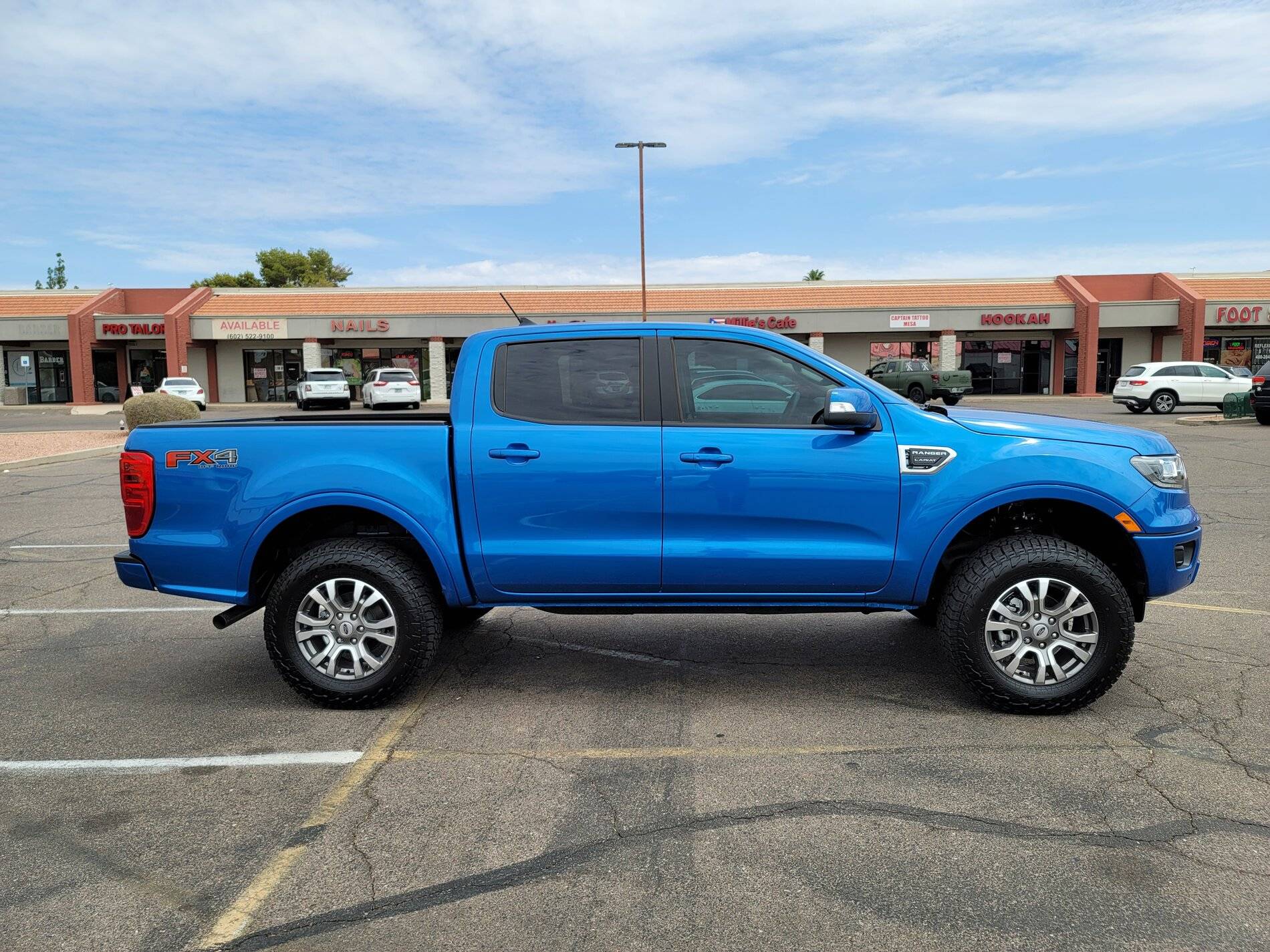

Truck in stock form the day I drove it off the lot

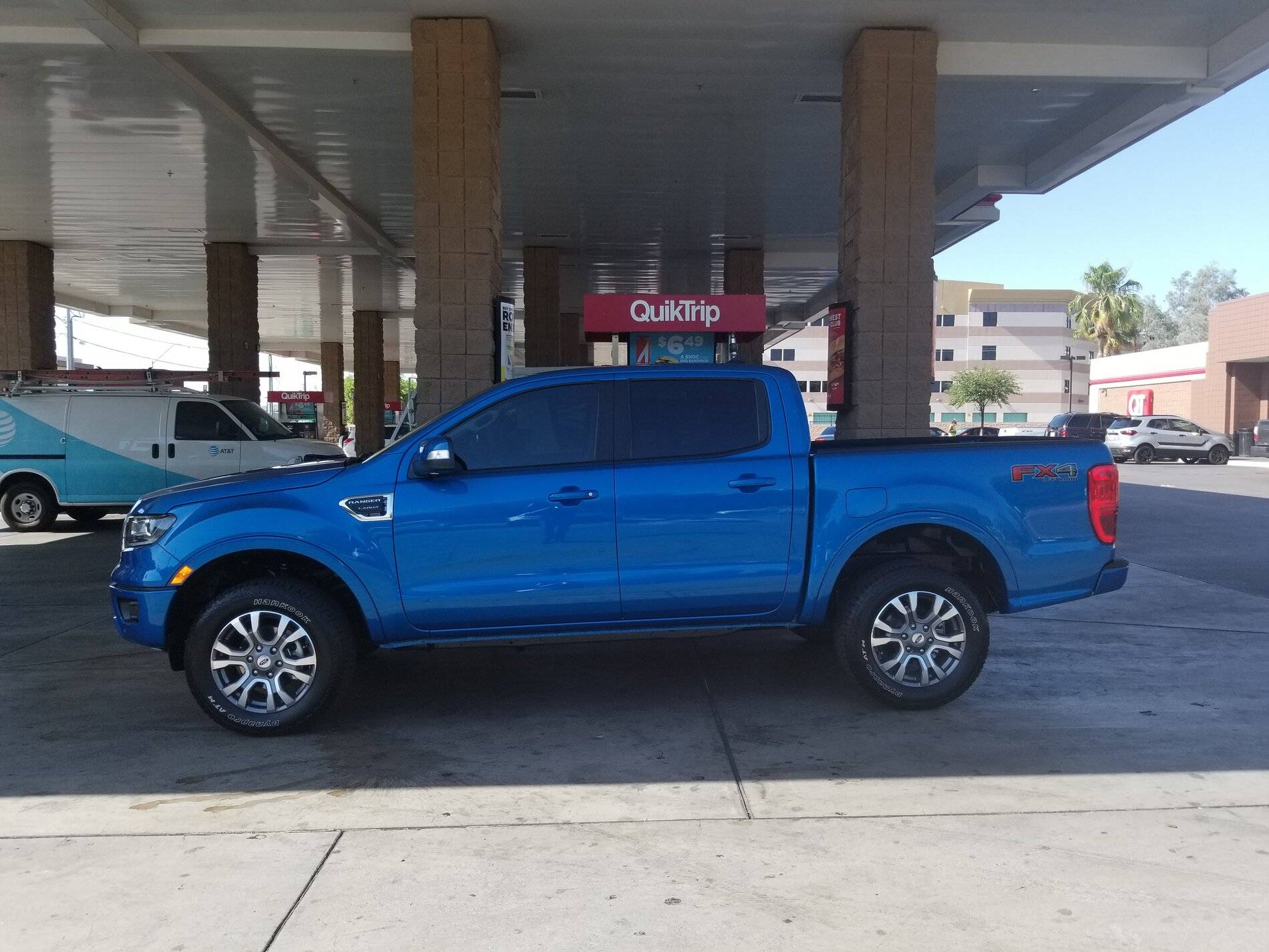

Truck with Falken Wildpeak A/T3w 265/70R18. 2" taller at 32.6"

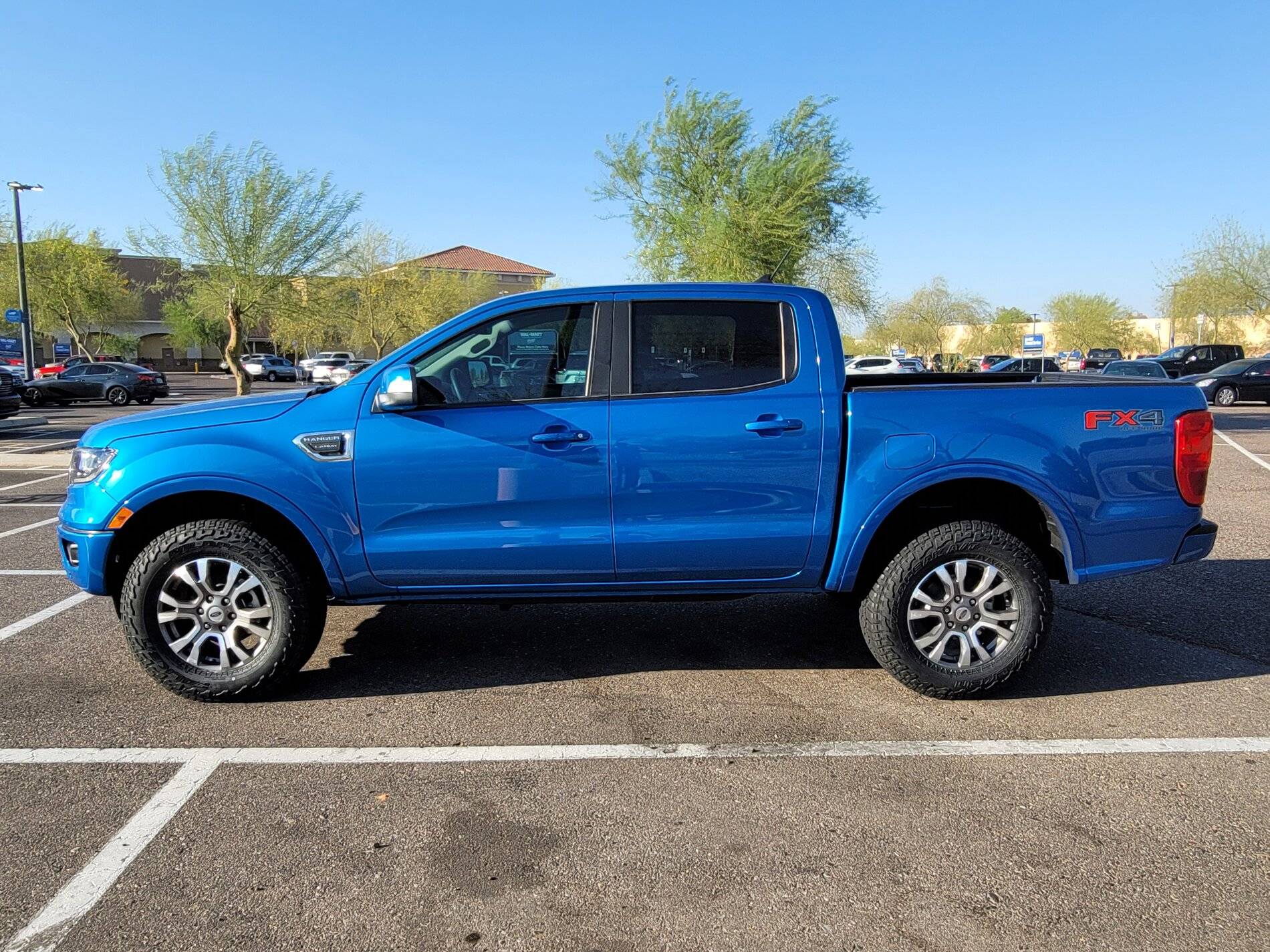

Truck with the Ford Performance Fox 2" Leveling kit and the Falken Wildpeak A/T3w tires that are 2" taller than stock.
So far I like the ride much better than stock. Firmer without being harsh so far and got rid of that floaty feeling. No more bouncing on bumps like before. Just got it done this morning so I'll need to get it in for an alignment real soon. The sooner the better. I will also now need a set of new rock sliders to help me get in. What a way to justify rock sliders to the significant other. Gee honey, the truck sits to high now so we need rock sliders because it's harder to get into the truck. LOL

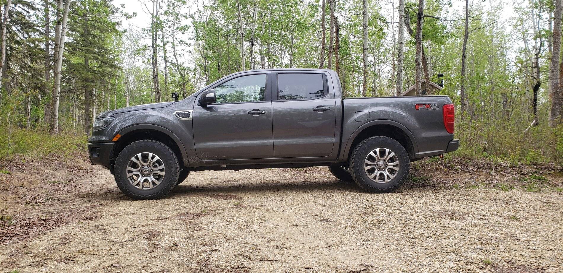

It'll end up looking somewhat like this, ignore my glider.
For the OP I'm led to believe your front coilovers were not adjusted properly for the full level/lift when they were installed. Mine has the Ford performance version of the Fox 2.0 that are adjusted correctly when you receive them.
So this is the Fox 2.0 on the highest adjustment settings? With the spacers? Also, what size tires are those?

It's the Ford version of the Fox 2.0 kit as sent by fox, I did not adjust anything and there are no spacers of any kind.
Tires are 265/70 r18

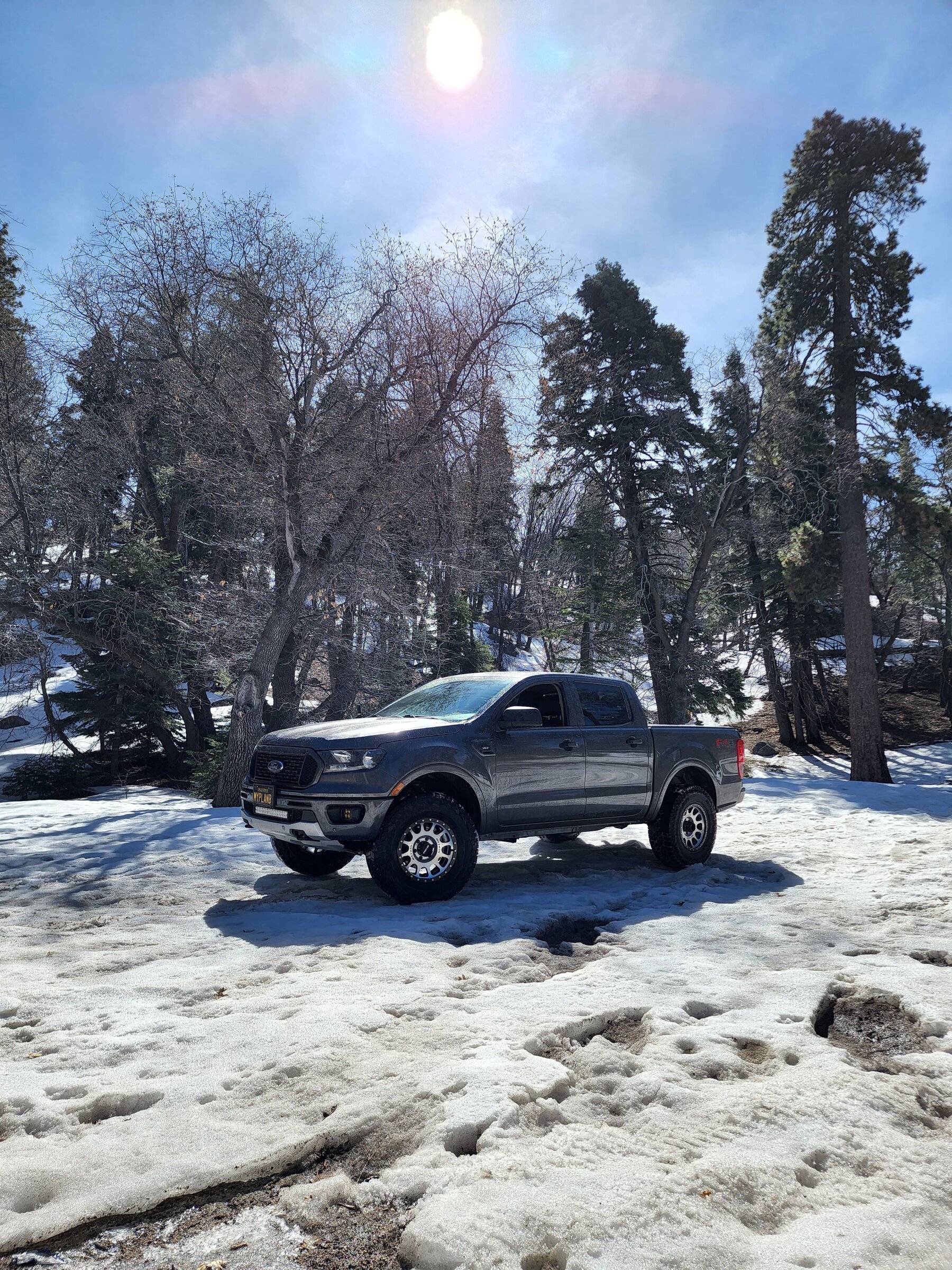

People will tell you the Fox's are ajusted at 2" of lift out of the box, but I can tell you from first hand knowledge and dealing with this literally daily with customers, they are not. It's really a crap shoot. Fox doesn't give a measurement either.
One note is these can not be adjusted on the truck, as they are a aluminum body, and you can destroy the threads.
This is my truck when we ran the Fox 2.0's. (on 4th Shock set up now) These are set at about 2" here.
