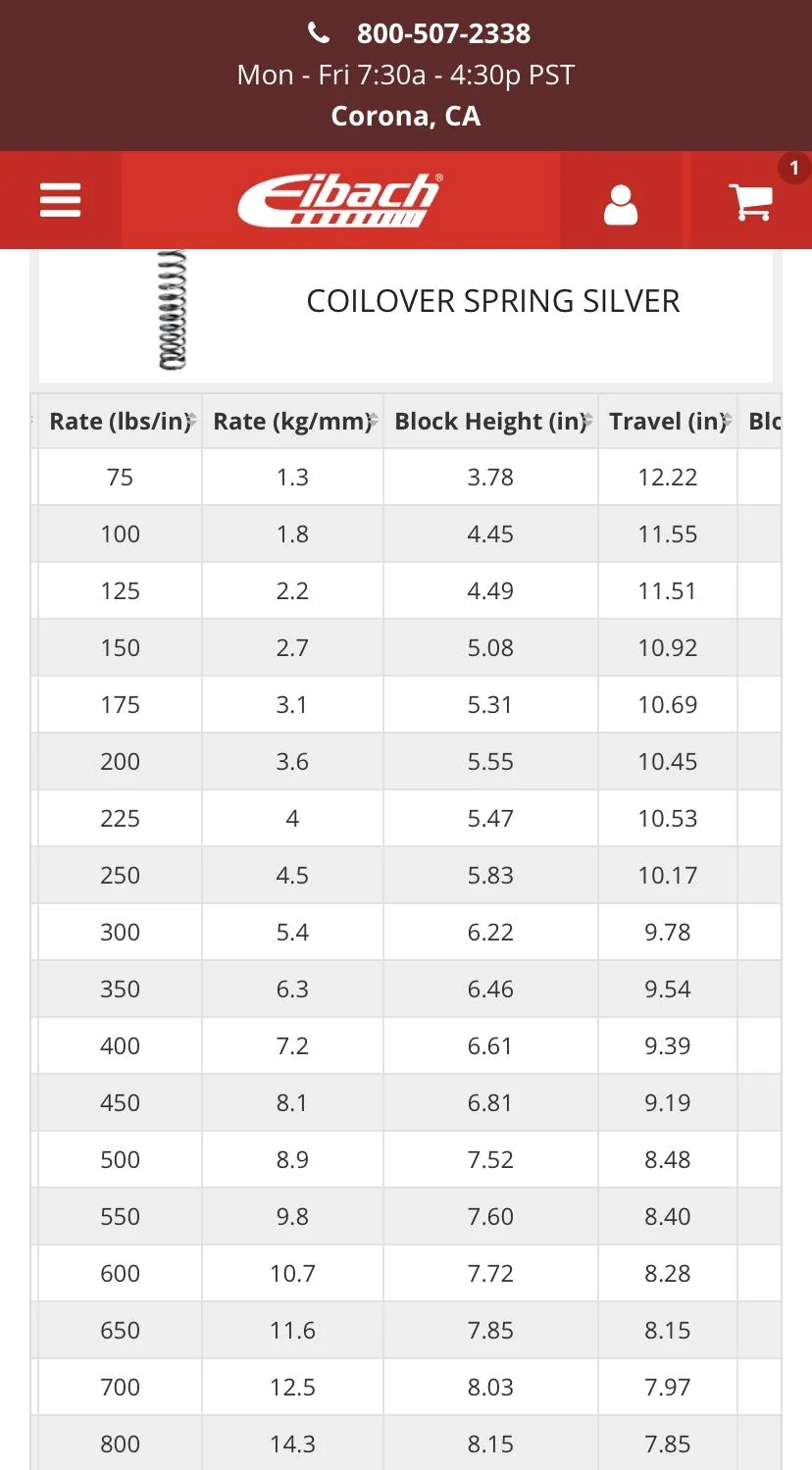

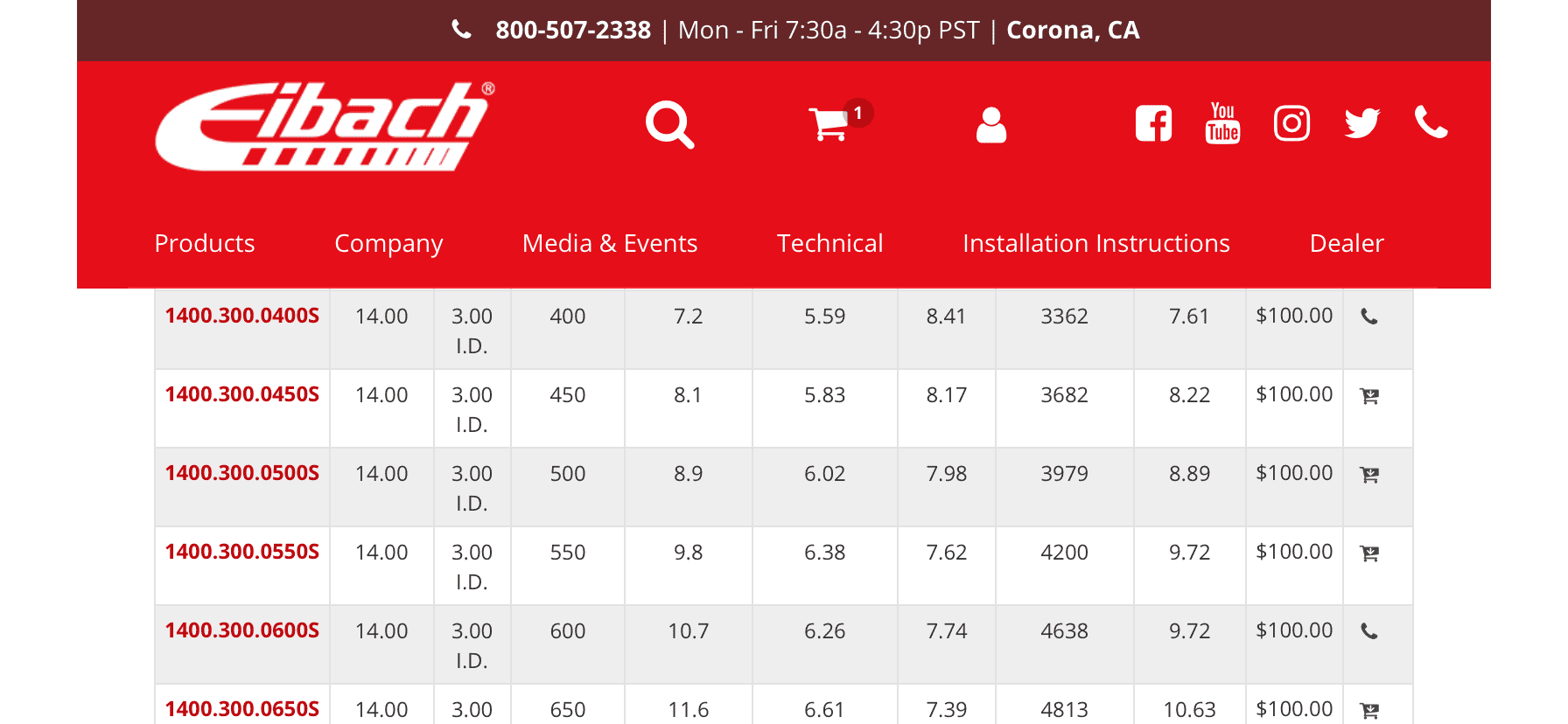

I think it’s useful even for other applications, like Eibach or Bilstein front shocks that comes w/o springs. So Fyi one of the screenshots show the options of the 14” spring, and the other the 16”.

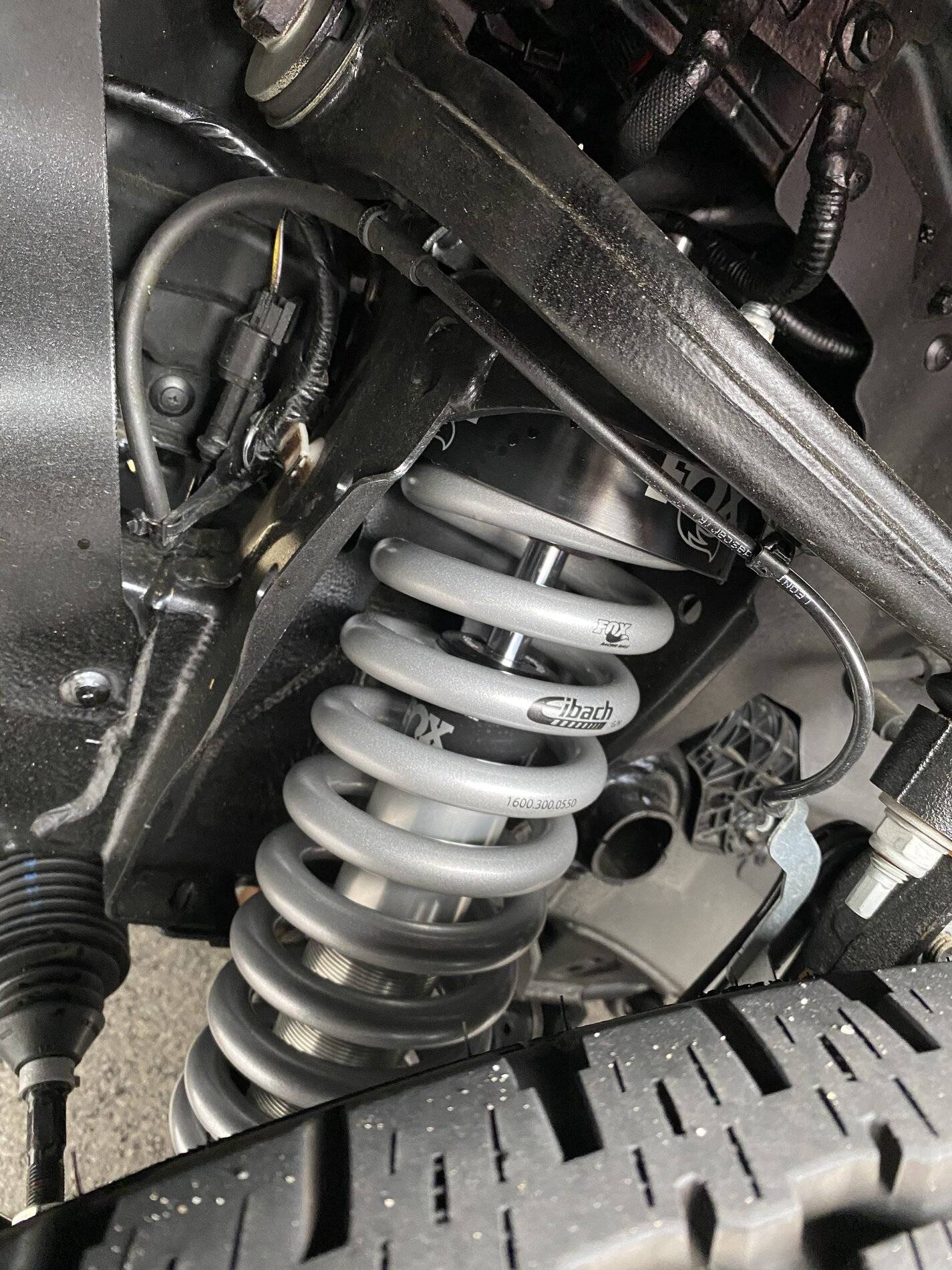

Question for the Fourm, I got the fox Ford performance installed a couple months back and I was wondering if anyone else has noticed that it’s a fox/eibach colab. All the photos I had seen on here do NOT have Eibach logo on the springs, but mine does.
