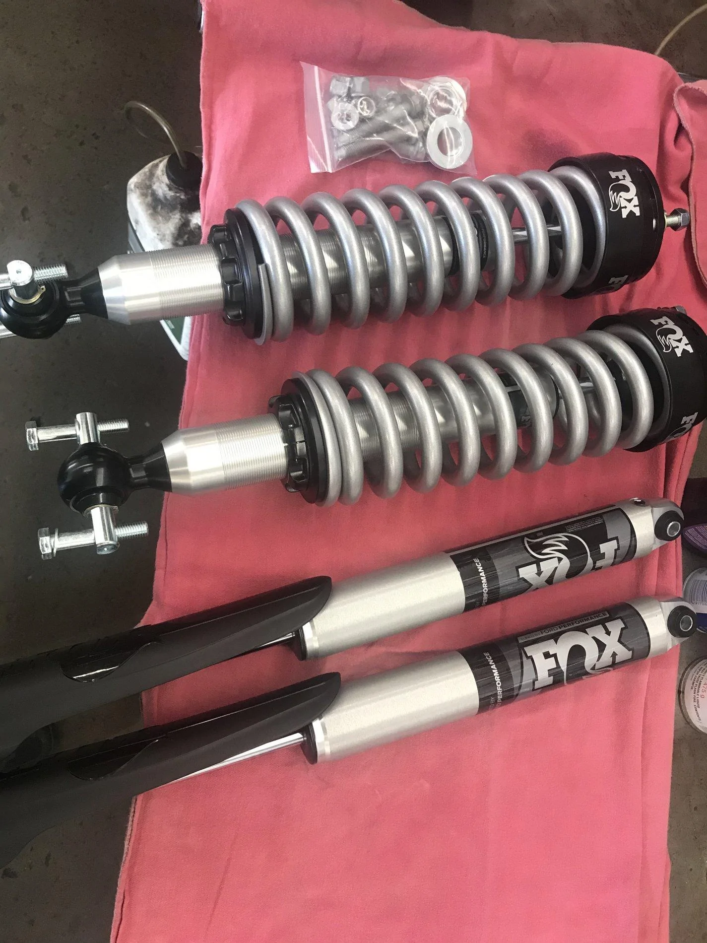

I just received my coil over kit from Stage3motorsports yesterday.. they look so pretty lol.. I will be installing them this saturday on my 2WD, but I think im going to turn the collar down before I install them. I was really only looking to go up 2" cause I want abit of a rake still, but Im still debating what to do, im to excited!
Have you taken yours off road yet to see how well the suspension holds up? And has it dropped at all since you installed them?
Haven’t noticed any drop yet. From my estimations, I should try to lower the collar maybe 3/8ā€. Don’t forget to use a spring compressor or take it to a shop before turning the collar, per instructions.

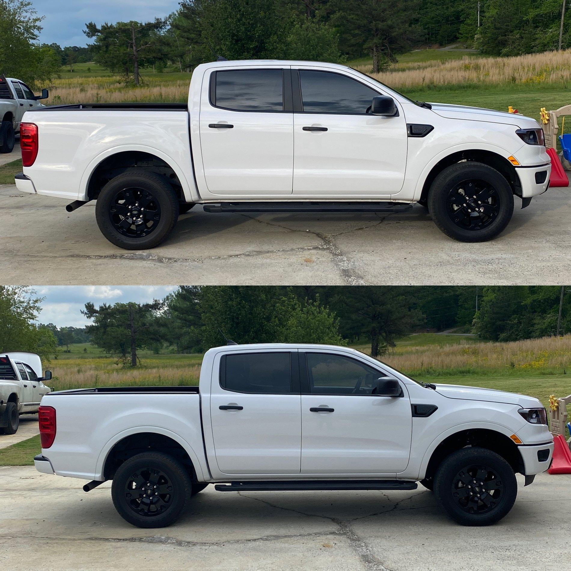

I just got mine installed on my XLT 2wd. I did not adjust the coil overs at all, raised it about 3 inches. It’s perfectly level now. This is the kit from Stage 3.
Gotta say I think it does more with the 2wd than the 4wd trucks.
