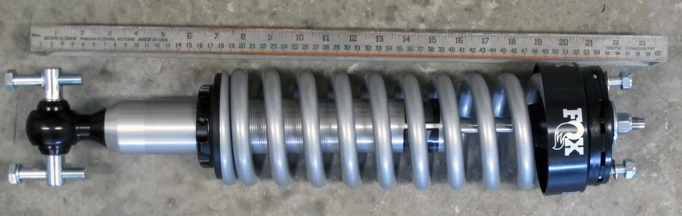

Based on the part numbers printed on the Eibach springs, both are 3” ID. Both are 550lb/inch spring rate. The overall length of the springs that come from the Ford performance kit are 16”. The overall length of the springs supplied with the aftermarket kit are 14”.
Fox lists the front shocks supplied in the aftermarket kit as 20.5” in overall length with a 4.47” stroke.
If we do make the assumption that the overall length and stroke of the Ford performance shocks are the same, then that would mean that the aftermarket kit would actually offer a softer ride than the Ford performance kit.
This is keeping in mind that the internal valving on the shocks from the 2 different kits are certainly different. Which is softer/firmer will really only be discovered once someone gets both shocks in a dyno or gets a better answer out of Ford/Fox.

This is a pic of the Ford performance front coilover. Draw your own conclusions.
I think it's the opposite. A longer spring will have a softer ride. The question I have is some of us want a better suspension with no or at most a 1" lift, so which kit is better? It's just preload on the spring that sets the ride height.
Hard to say which is better, to my understanding you can set either one to stock ride height but with a softer spring over stock it may be advised to have it no lower than 1 inch.

The preload would have to be the same for any spring to sit at the same height (has to support the weight of the truck). Beyond that the "rate" is rate of increase as you compress the spring. I don't believe either of the Fox kits would have a softer rate than stock when set to the same height, but that is the question.
I can guarantee the springs on the Fox kits are softer as they have much more travel than the factory shocks and springs. I have the Old Man EMU lift and bothe the front and rear springs are softer than factory for flexibility but can still hold the same weight(engineering at its finest). I have also had to set my toe carefully ads the toe would go out A LOT when my fat ass would get in. I think the only shock kit that uses the factory springs is the Eibach kit.
Incorrect.
Take 2 identical shocks and put a 2” longer spring of the same rate on one of them, the one with the longer spring will ride stiffer.
Spring rate is calculated as pounds per inch. Preload it more and the rate increases.
