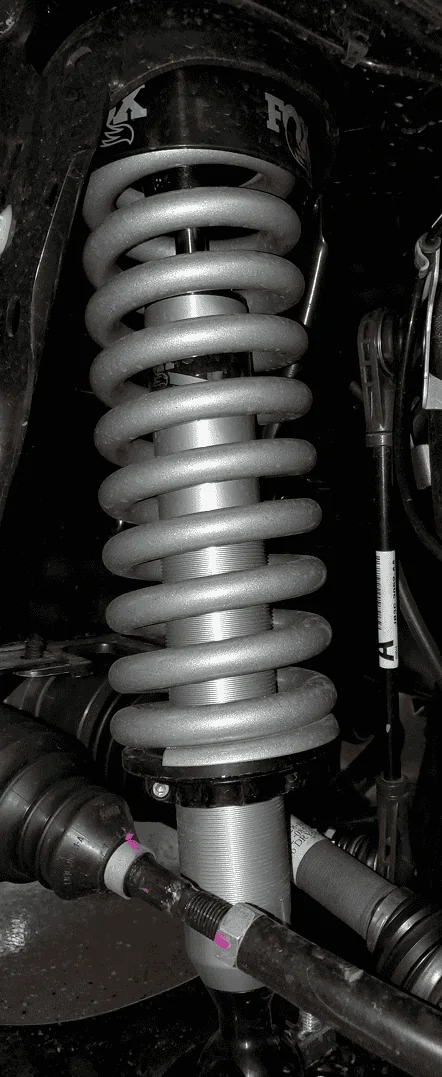

My Ford/Fox kit was made 9/2019 and installed out-of-box by my dealer pre-delivery 7/2020. No adjustments. Kits were in short supply at that time.

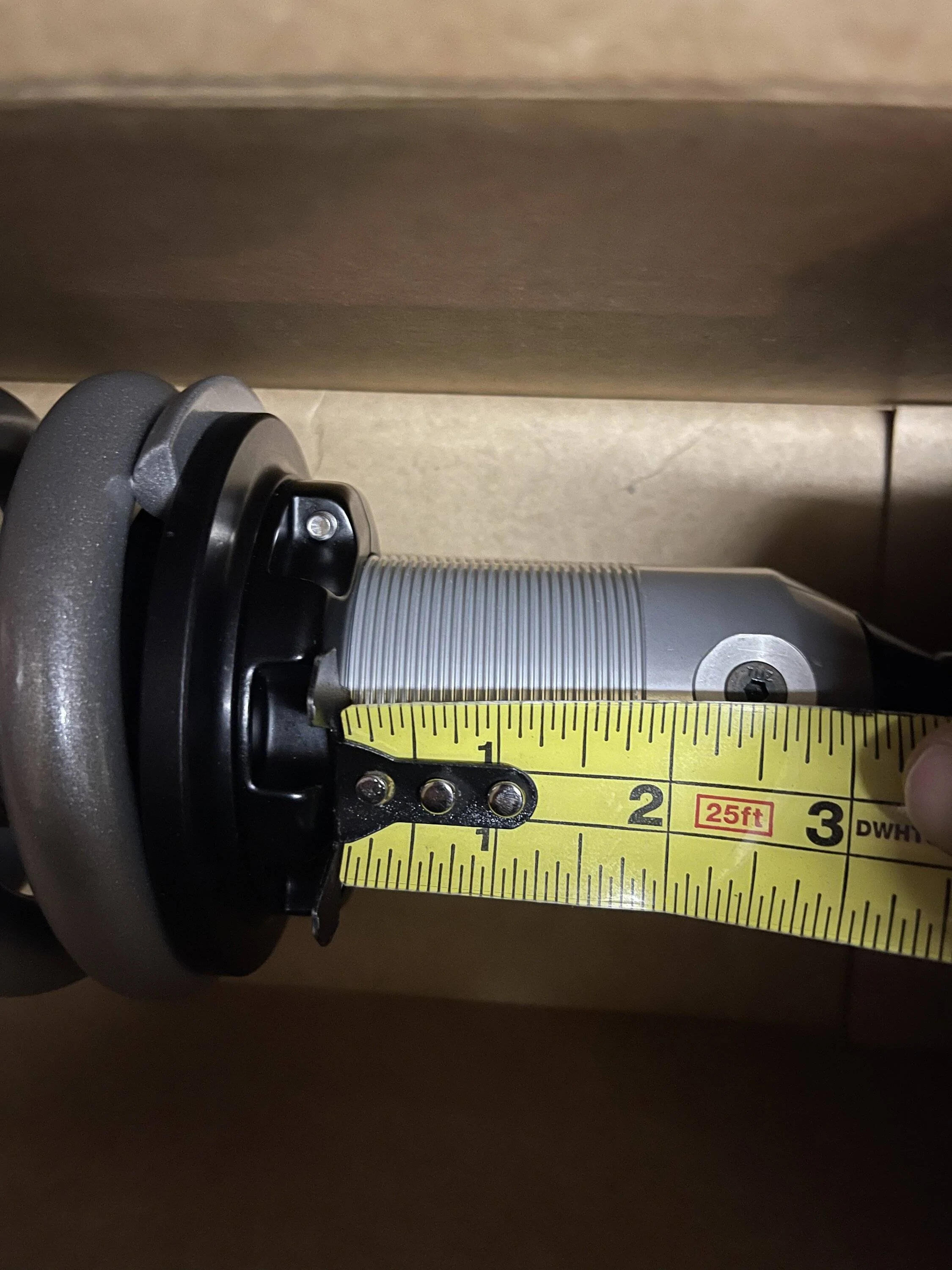

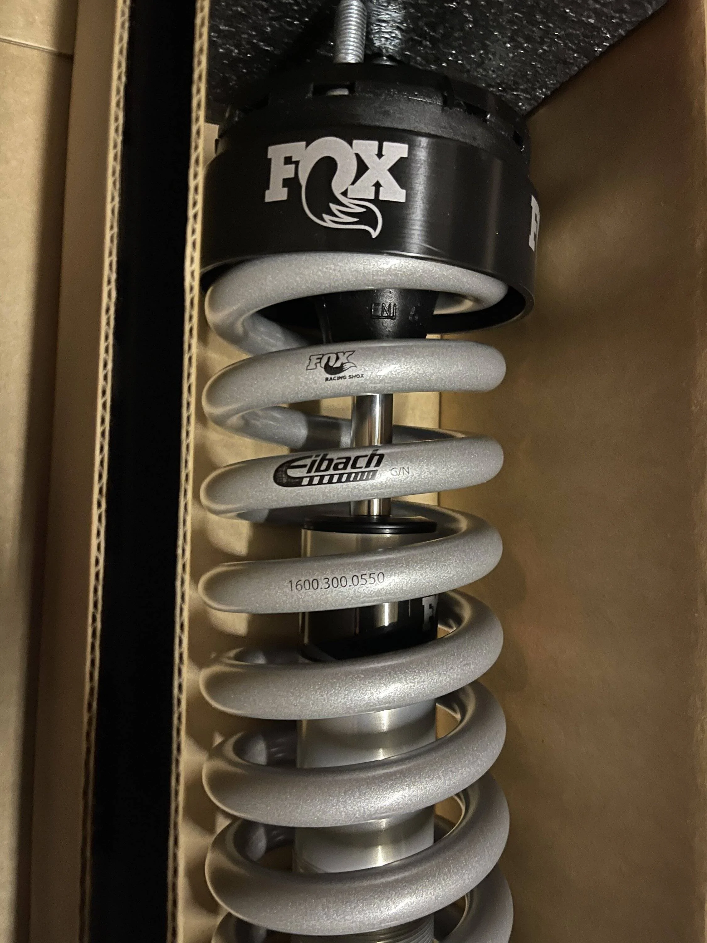

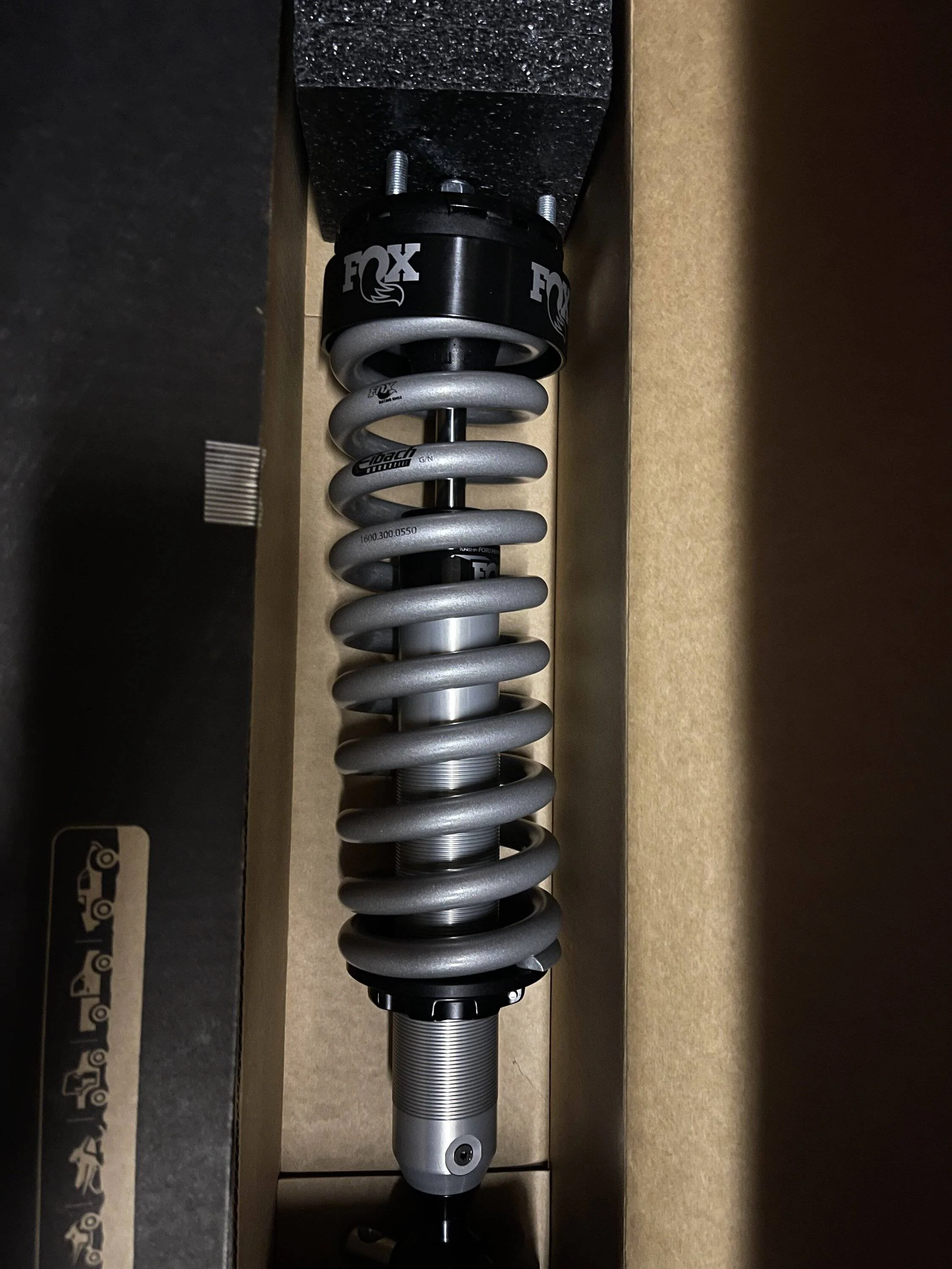

Attached are photos of the Ford Fox 2.0 kit. If anyone has the Fox non-ford ones we can compare. I am also interested in the Fox only preload setting from factory. The Ford ones seem very minimal.
The Ford Fox preload setting is less due to the 2" longer coil spring. The Fox aftermarket setting is higher because the coil spring is shorter.
Something many have commented on is that the preload settings of the Ford Fox kit seem to be right on the money whereas the Fox aftermarket kit is much more inconsistent.

What amount of lift did you get without adjustment?
