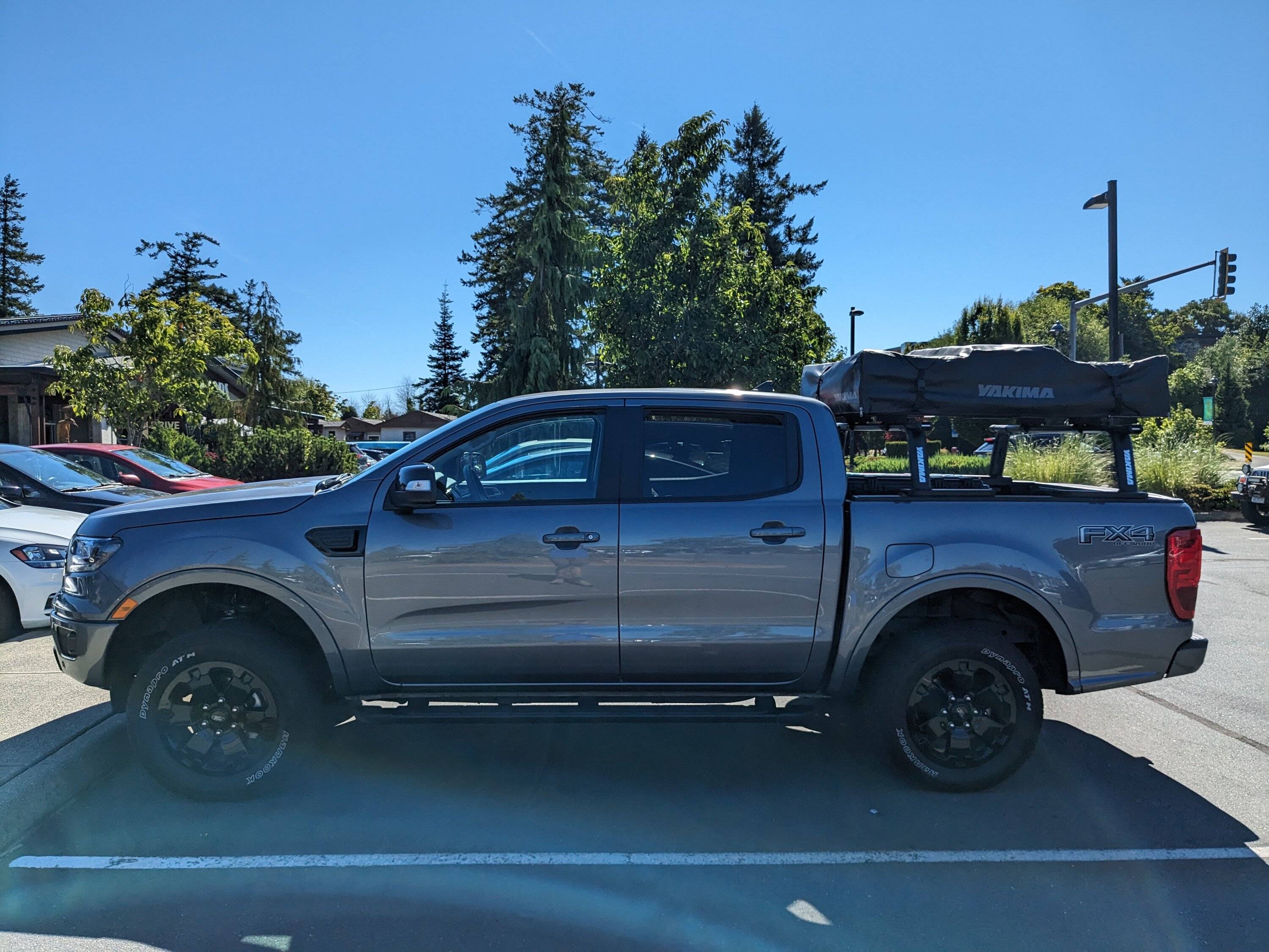

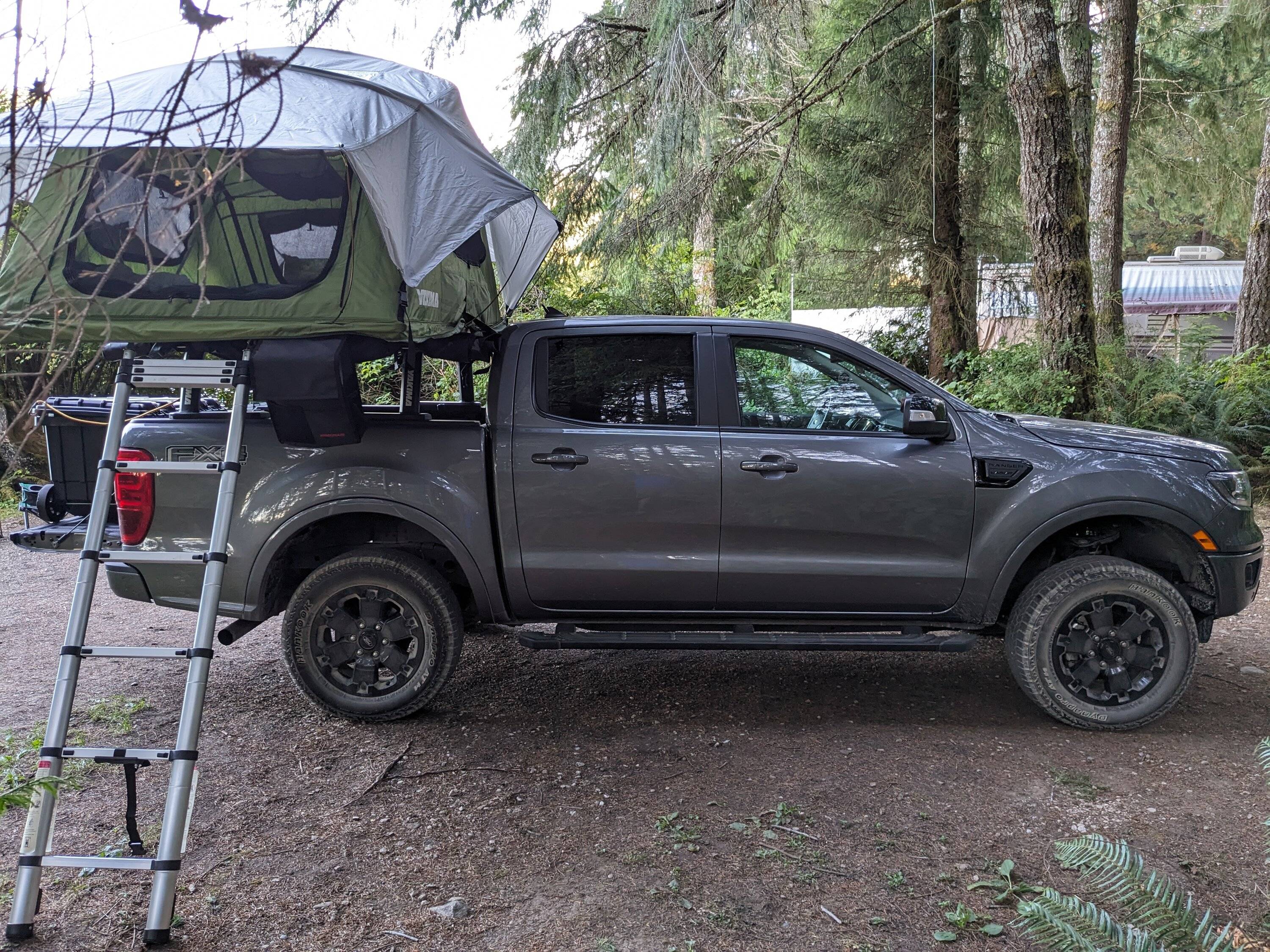

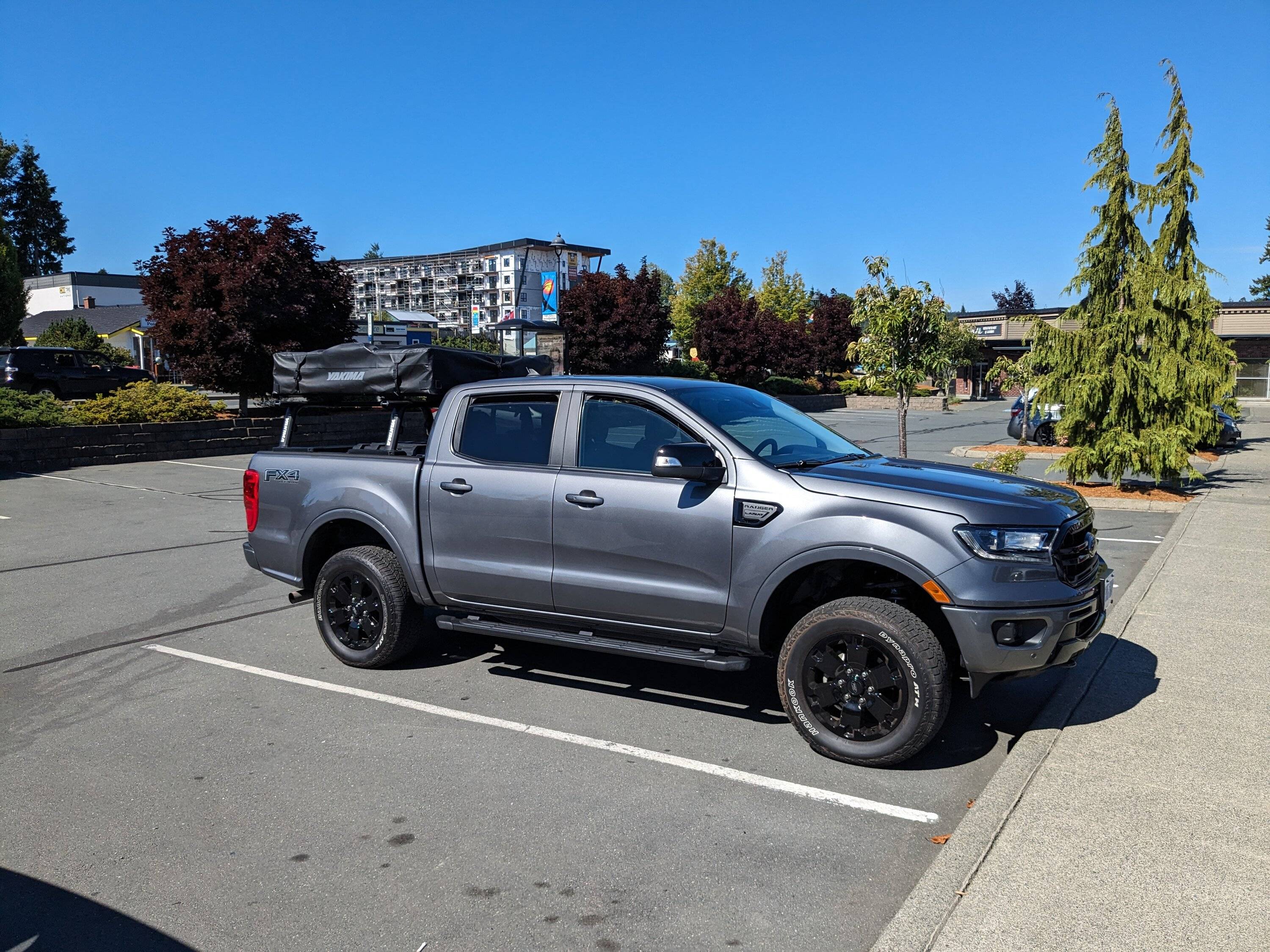

Here are some pictures of the current setup.

Lowering isn’t all that difficult while mounted with the right setup. The shop you had it done at should be able to dial that in as you do have the adjustment

My inclination would be to go back to the shop and explain it to the boss, like you explained it to us.
A good shop should want to stand behind their work and most are acutely aware how important it is to have happy customers.
Frankly I think the truck looks awesome as it is, but only you are important in that opinion.

Sadly FOX 2.0's on this truck can't be adjusted while on. I can hardly see it. I would not worry.

Looks good to me in the pictures. If you put a level on your step rails, is it showing lower in the back?

1-1.5” to me is a perfect range. you still get good down travel and alignment is easy.
truck looks perfect. still stockish, but you can tell it’s leveled too.

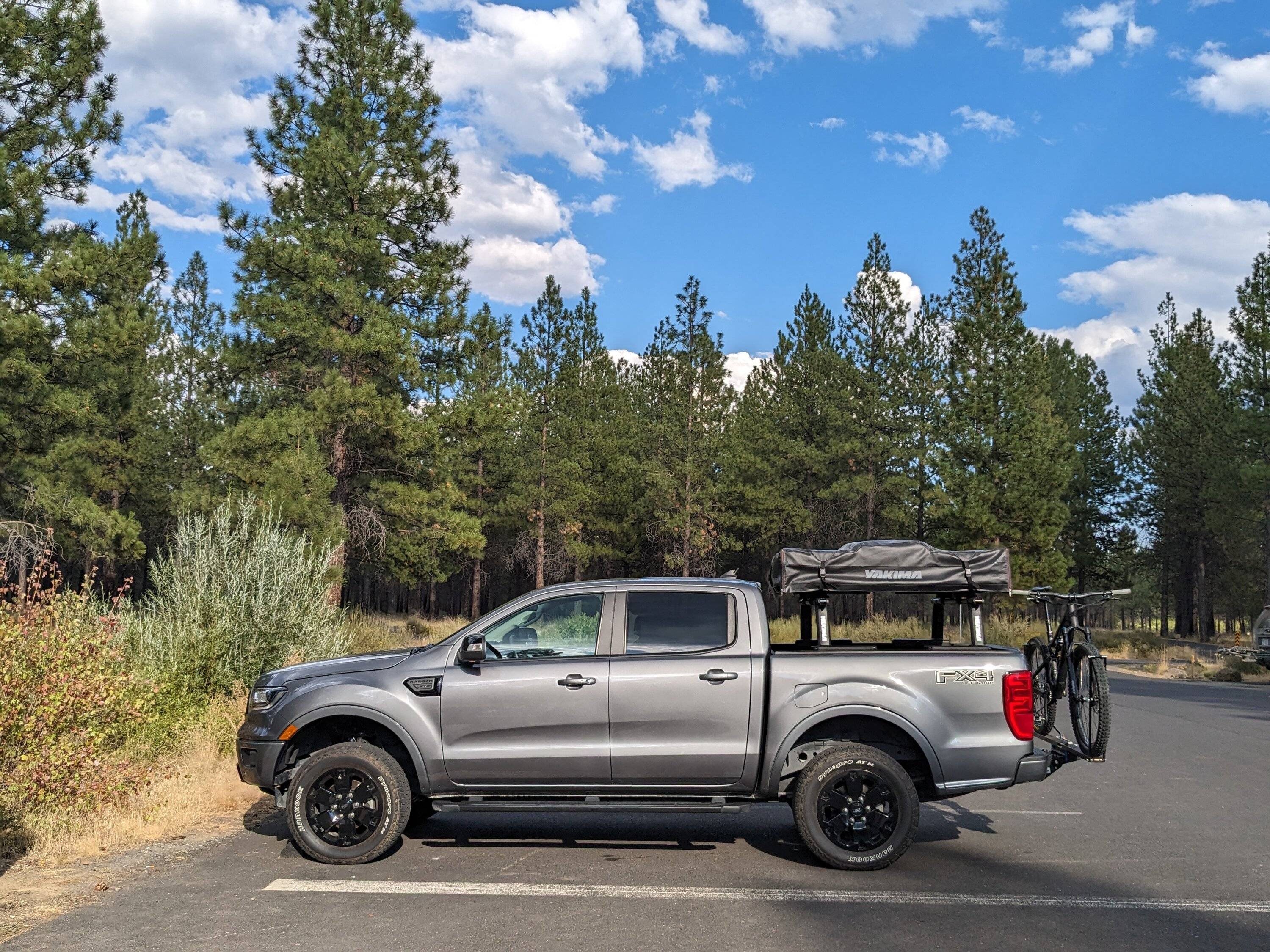

Here is the truck after the fronts were lowered about 1/2 inch last week.
My front wheel well is aproximately 37" with the stock Hankooks. It was about 36" before.
I am pleased with the result.
There is about 250-300 lbs in the bed (125 lbs RTT, 60 lbs rack, 50 lbs hitch bike rack and bike, 50 lbs in both swing tool boxes, approximately).
I also drove with a fairly full load of gear a couple days ago. The truck was not quite level, maybe 1/2 inch of rack. Exactly what I was after.
