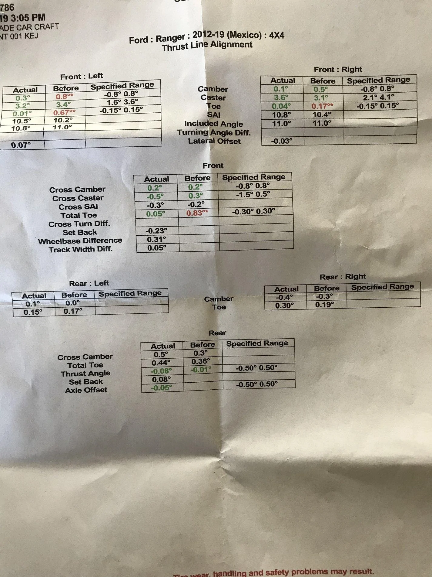

Thanks. I do have the alignment sheet, which I’ll post here. It looks like everything came back into tolerance, but maybe someone with more knowledge can add more input from the numbers. Otherwise, I guess I can re align and re balance, and if neither work, then UCA’s? A little frustrating if I have to throw another $700 at it to make it work.
As always, I appreciate any thoughts and input!

The alignment looks fine. The alignment is not causing the shimmy. Try rotating the backs to the front. If they were road forced and balanced what was the road force measurement. I suspect a bad tire.
FWIW, I have seen a bridgstone dueller AT that had a smooth lump on the inside of the tire in the middle of the tread... straight up defect not damage.
Especially since the Falkens are cheaper, maybe the QC isn't as good.
