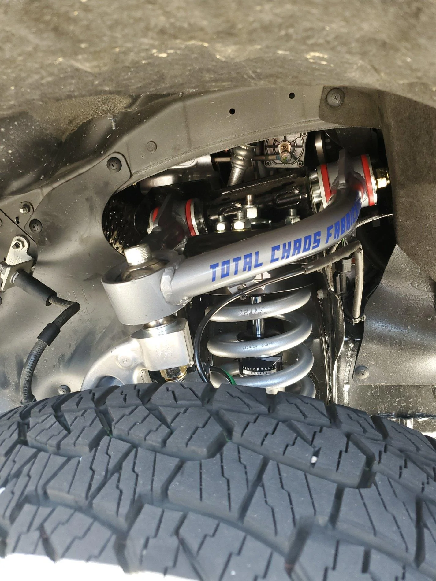

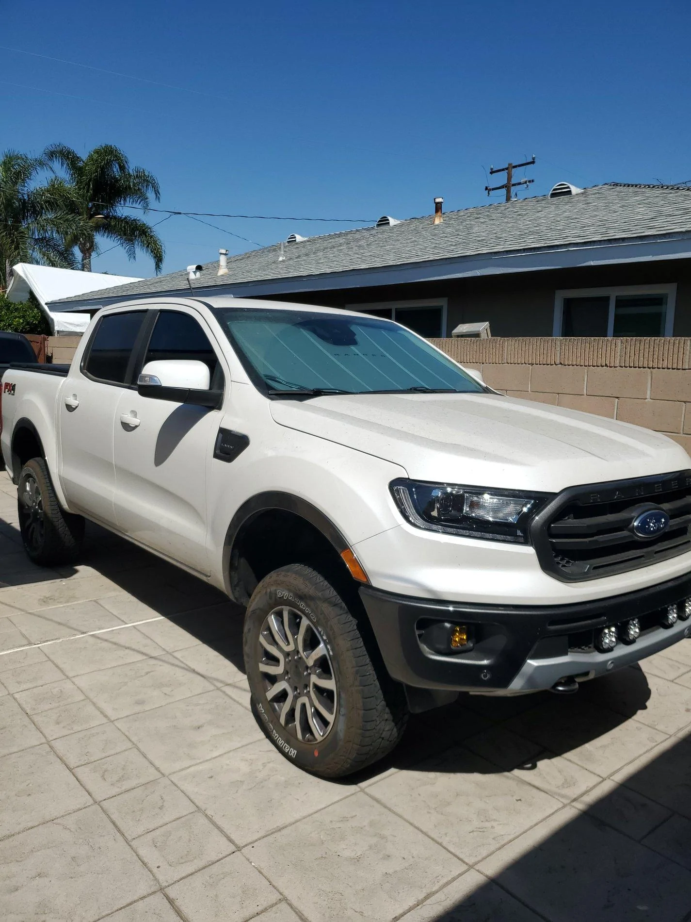

Finally had a chance to get my fox stuff installed. Paired them with a set of UCAs from Total Chaos. Will be getting bigger tires installed in a week or two. So far I'm really liking the new set up!
Looks like a pretty rad setup.
What tires you think you'll go with?

Thanks Jason!
As for tires, right now I'm leaning towards a set of Falken Wildpeaks A/T. Still not 100 percent though

Considering this too. How does the ride compare to stock??
For on road driving, the ride feels way better than stock to me. It feels stiffer and it got rid of the super bouncy ride. I'm hoping to get some offroad miles on them this weekend so I'll see how they do

Thanks Jason!
We've been happy with the A/T3Ws on our own trucks. I'd make the entire Wildpeak line is arguably one of the better bang-for-your-buck tires on the market at the moment.
I have the 305/65R18s on my F150 and I've been nothing but happy with them.
