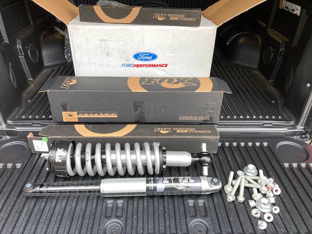

Question for the Fourm, I got the fox Ford performance installed a couple months back and I was wondering if anyone else has noticed that it’s a fox/eibach colab. All the photos I had seen on here do NOT have Eibach logo on the springs, but mine does.
Mine has the same logos. its the FPP set. but they are only on one side, so depending on how the installer orients the top you may not see the logos
I just ordered the Fox 2.0 kit and it came with Fox springs. I was looking at a coworkers Ranger today who installed the Fox/Ford front coil overs and his has Eibach springs.
My shocks have 3.4375" of threads below the adjustment nut and his has 2" of threads showing.
I haven't installed mine yet and it will be a few weeks before I get to it. My coworker claims a 2" increase in front height was obtained.
I believe the difference in height below the adjustment nut is due to the Ford Fox springs being 2" longer than the aftermarket Fox kit.
