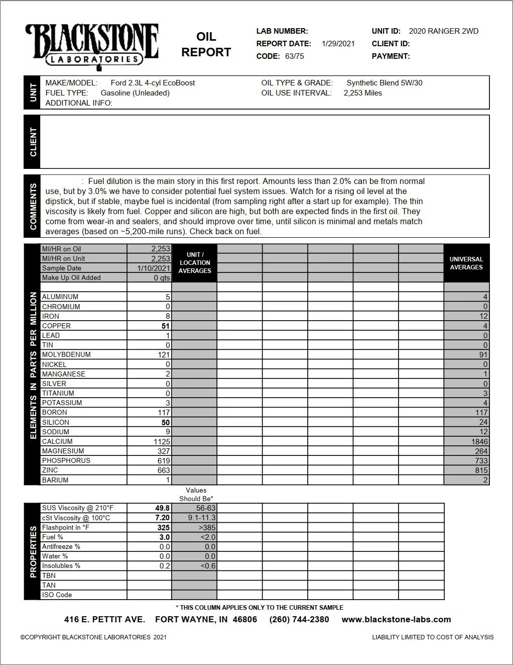

FYI, I got my oil report, apparently I have high-risk gas dilution, 3% at 2,250 miles... (I only use high detergent 93 octane premium costco gas in North America.) On the plus side, at least they didn't detect a coolant leak or any other issues. I guess I should be like you folks, and submit a ticket immediately with Ford Support, either I need new fuel injectors, coilovers, or new piston rings. Who knows?! I sure don't...

I've been running 5/40 W for almost 1700 miles now don't know if it actually helped out or if it just got better on its own. Now if I throw in about a 30 mile trip a week and I can keep it down to the top hole or below. With the 5/30 It didn't make any difference what I did it would rise above the top hole sometimes to the twist. Yesterday I took about a 100 miles trip and it actually came down to about an eighth of an inch above the full mark. Don't know what changed for sure but I hope I can keep a handle on it. For awhile I thought I was heading down the same road as MotoWojo!! I'm starting to wonder if some of the rise in my case is condensation . I read some articles that stated once the fuel is diluted in the oil it doesn't burn or evaporate off. I sent a sample to Blackstone that only had 500 hundred miles on it but the level on the dipstick was above the top hole and it came back 1% fuel dilution. I had done that oil change and I had it right on the full mark!
