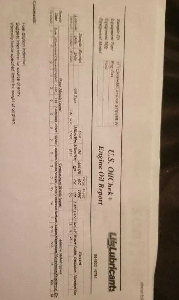

Below is one of the tests the dealership sent out. 13% fuel at 2111 miles on oil. They did another one, that they did not give me a copy of because they couldn't find it when I asked for it, but that one was 12% fuel at 500 miles on oil. I am actually driving my truck with the oil level much higher than when the below sample was taken, as I was instructed to drive it 5000 miles, as the Ford Engineer wants a comparative sample at that mileage. Ford has told me they will not do further work on my truck unless I do as they request. The oil level is currently at the top of the twist and I have about 3000 more miles to drive before they will work on it again. For reference, HPFP has been replaced once, all 4 injectors have been replaced twice, fuel lines and rail replaced once. I have over 8000 miles, 8 times at the dealership, and over 7 months and counting for this issue. Truck has 20,000 miles on it, and during the first 10000 miles, the oil level never budged. 8 oil changes in the last 10000 miles.

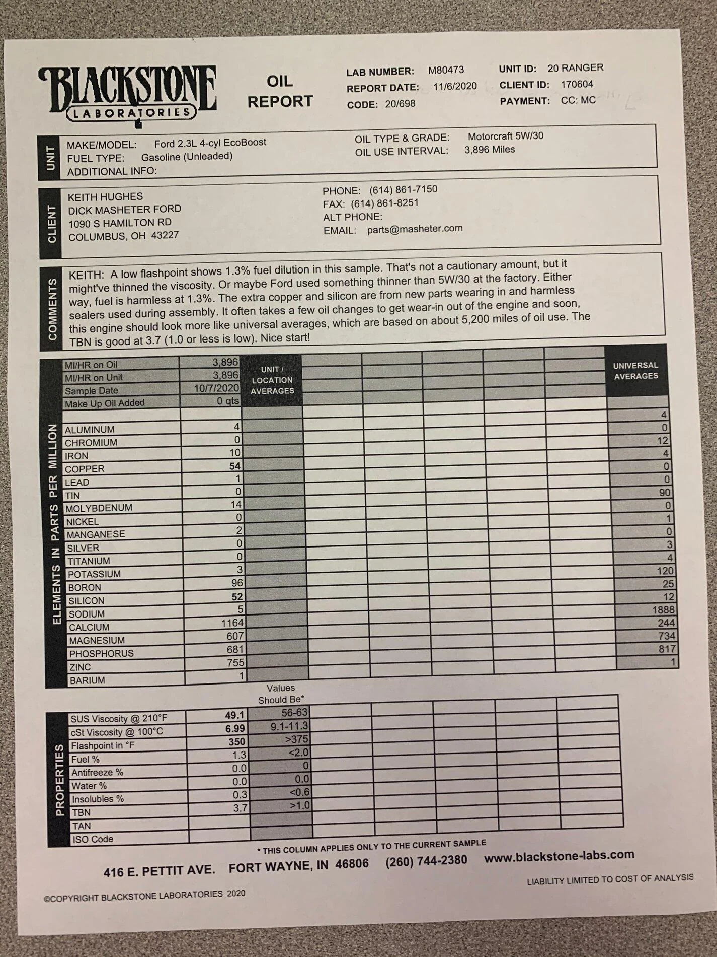

Here's my test if anyone wants to see. My wife has the full megabucks version of Adobe and she redacted the personal information for me. :D
Good to see a US Lubricants test too. @MotoWojo interesting that your truck did ok at first then got worse. I will likely be sending a sample in with every oil change to keep an eye on it over time.
I had a couple Blackstone test bottles left from my motorcycle racing days when I tested often. I asked for more and I see they now come with prepaid shipping labels. Nice. Makes testing oil easy.
@Da Ranger it looks like your results show your 2nd test doing much better. Are you registering your 1st or 2nd results in this poll?

My second results since the first had a lot less fuel in it.

Oh the one on the left is the newer one. Good to know, thanks. Did not notice the dates. All the more reason for everyone to keep testing, even if the first results came out really good like mine did. Everyone keep the results in the poll updated.

I’m confused by your wording, Cindy. You mean that the fuel dilution got worse with the latest test (i.e. your second Blackstone test). Right?

Yes the first test was 1.8 and the second 6.8. I used the 6.8 in the poll.
