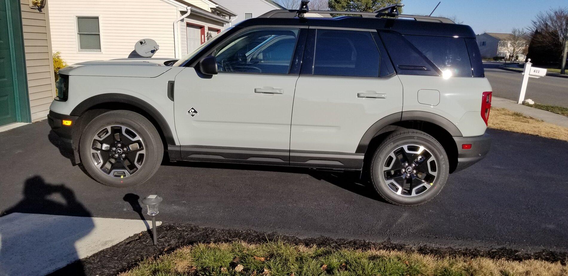

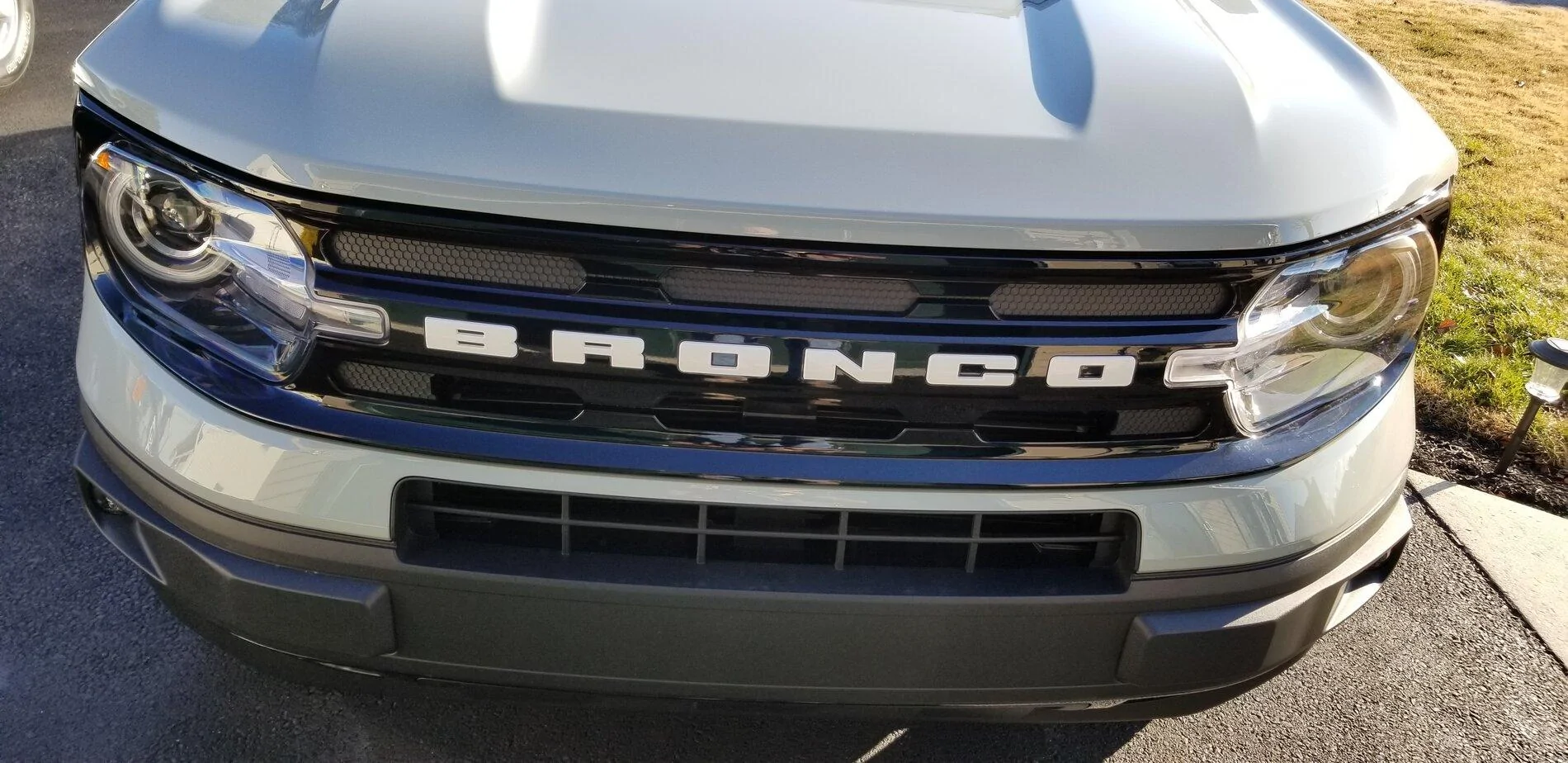

The only plus side to this is they gave me a loaner and this is what they gave me.
209 miles on the clock. Please excuse any spelling or punctuation as I'm trying to do this from my phone

Well I drove the Bronco a little bit tonight the best part of it so far was the heated steering wheel. I really believe my ranger has a lot more power then this Bronco. It's kind of strange when you get in it the cluster and the radio plays a short video which seems like a bunch of gingerbread to me.
