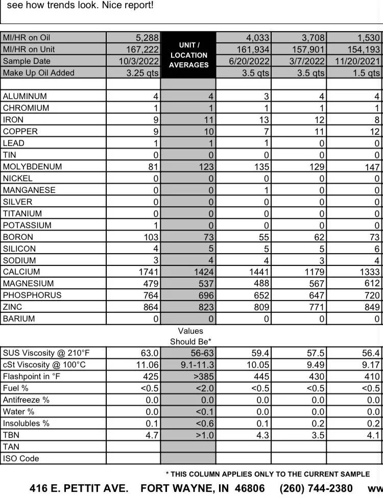

My Blackstone reports (on any car) look terrible if I don’t get up to 212F oil temp on a regular basis. I literally have reports that show 5,700 miles of highway driving with better results than 1,500 miles of short trip driving.
Once I cross the 212F oil temp mark on a regular basis, my reports look great.
Here’s a 1,530 mile report that has worse results than almost 6k of “up to temp” driving.

Correcting the error in the above post:
Just realized that was a ~5,300 mile run going from state to state (5 x 1,000 mile trips) vs 1,530 miles of city commuting (15 miles one way). Oil never got above 190F going to work, or 203F coming back. The runs in the middle were mixed city and highway driving. Highway at 212F or greater seems to look much better on the report.
