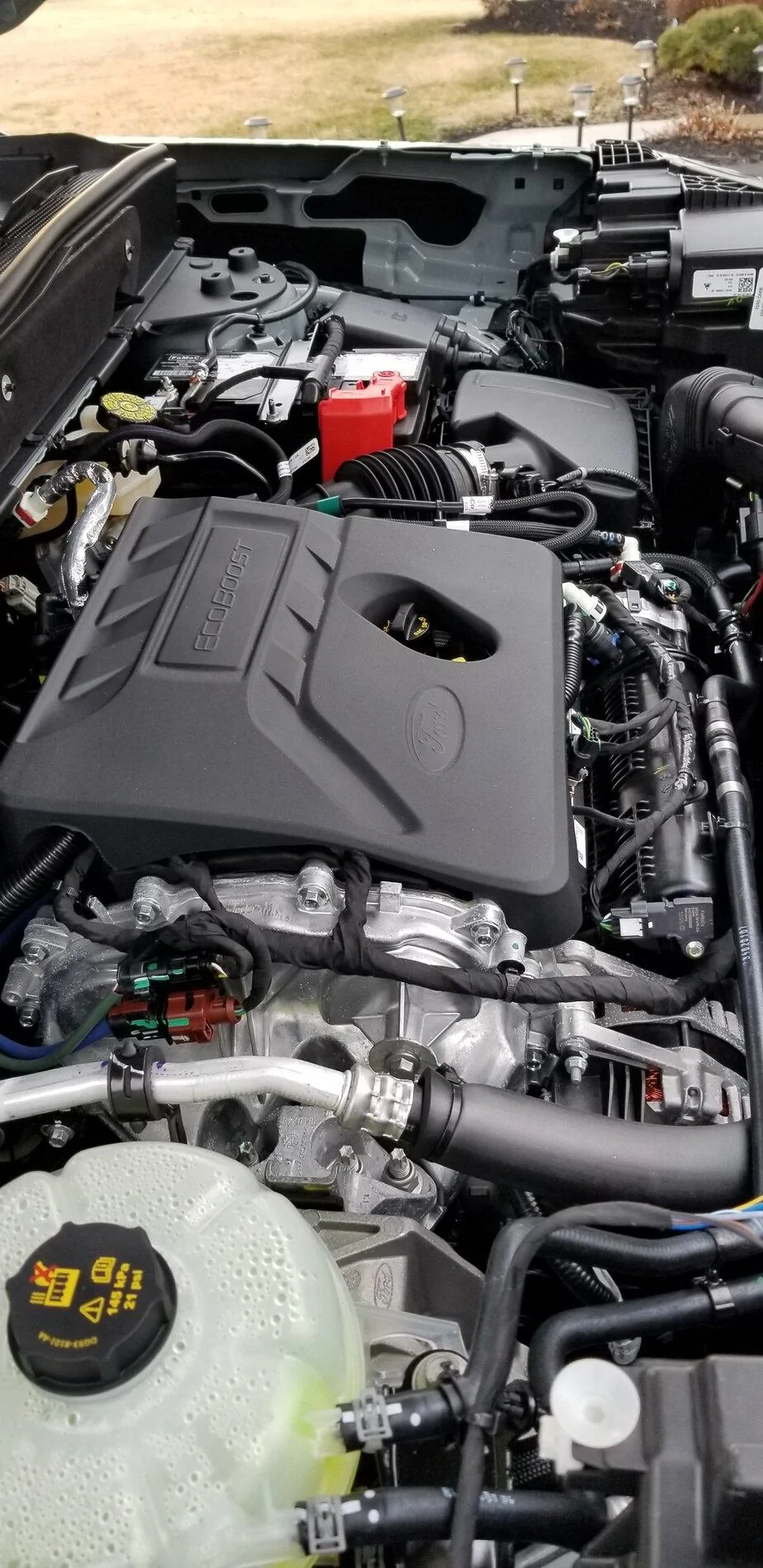

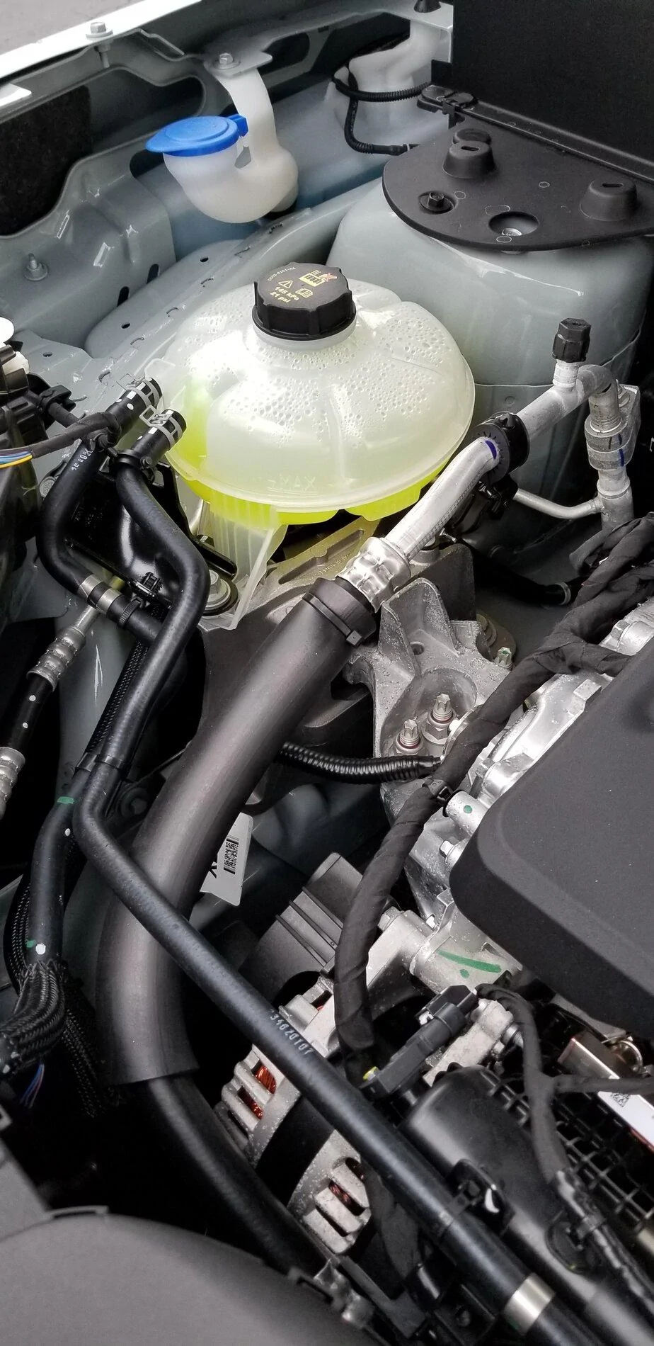

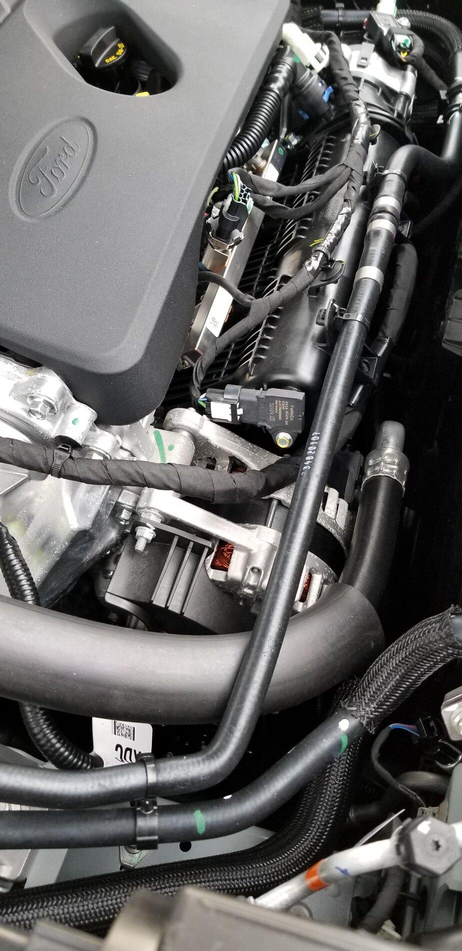

Did you glance at the alternator location and what type they used?

I will look tomorrow and let you know
We were having a discussion about the placement on the Ranger being low. Wondering if they raised it or sealed it for the Bronco. Would be much appreciated!!!!
The bronco sport will not have the same setup as the regular bronco, it doesn't share any engines.
Understood
the enignes really dont matter that much either way, its the alternators Im looking at. If its high placement then it wont be sealed, if its low or mid then maybe it will be sealed. Then its just a matter if it will fit on the Rangers engine version. Its alot of angles as far mounting brackets,cooling and so forth, but there is always a chance.

Understood
They do though, because the engine as a package includes how the accessories are mounted and what are used.
That is what I said, I just want to know, nothing wrong with that.
" Then its just a matter if it will fit on the Rangers engine version. Its alot of angles as far mounting brackets,cooling and so forth, but there is always a chance. "
Just becaus it mounts different, is not the end. I worked in an alternator/starter repair shop. Many modifications where made in that shop, it was there specialty.

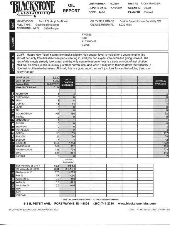

Got my Blackstone results recently. I had a "trace" of fuel with just under 4k miles on the oil. My oil level has been stable and does not smell like fuel. The trace may be because it's cold here and I may not be getting the oil up to full temp lately. Anyway, I'll take it. Here is the report for those interested.
This looks really good. Being in Nevada your temperatures are warmer than members that live in the north. Do you do much in the way of short in town trips or mostly longer highway?
