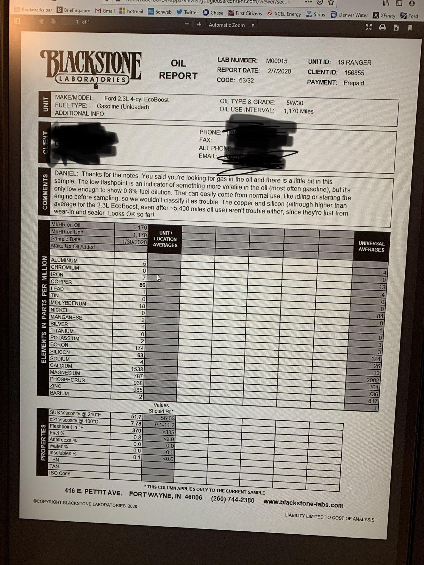

Here is my oil composition test from Blackstone. I never had any oil level issues but the smell was concerning. Was very strong to me. The test confirmed less then 2% which was good. However reading comments they said be aware of the copper and silicone. Since the test I replaced the oil with amsoil full synthetic signature series 5w/30 oil. Will likely run another test when I replace the oil in the future. Hope this helps others. More info shared more we all know. Cheers.

How many miles on that oil change? Is 1170 correct?
