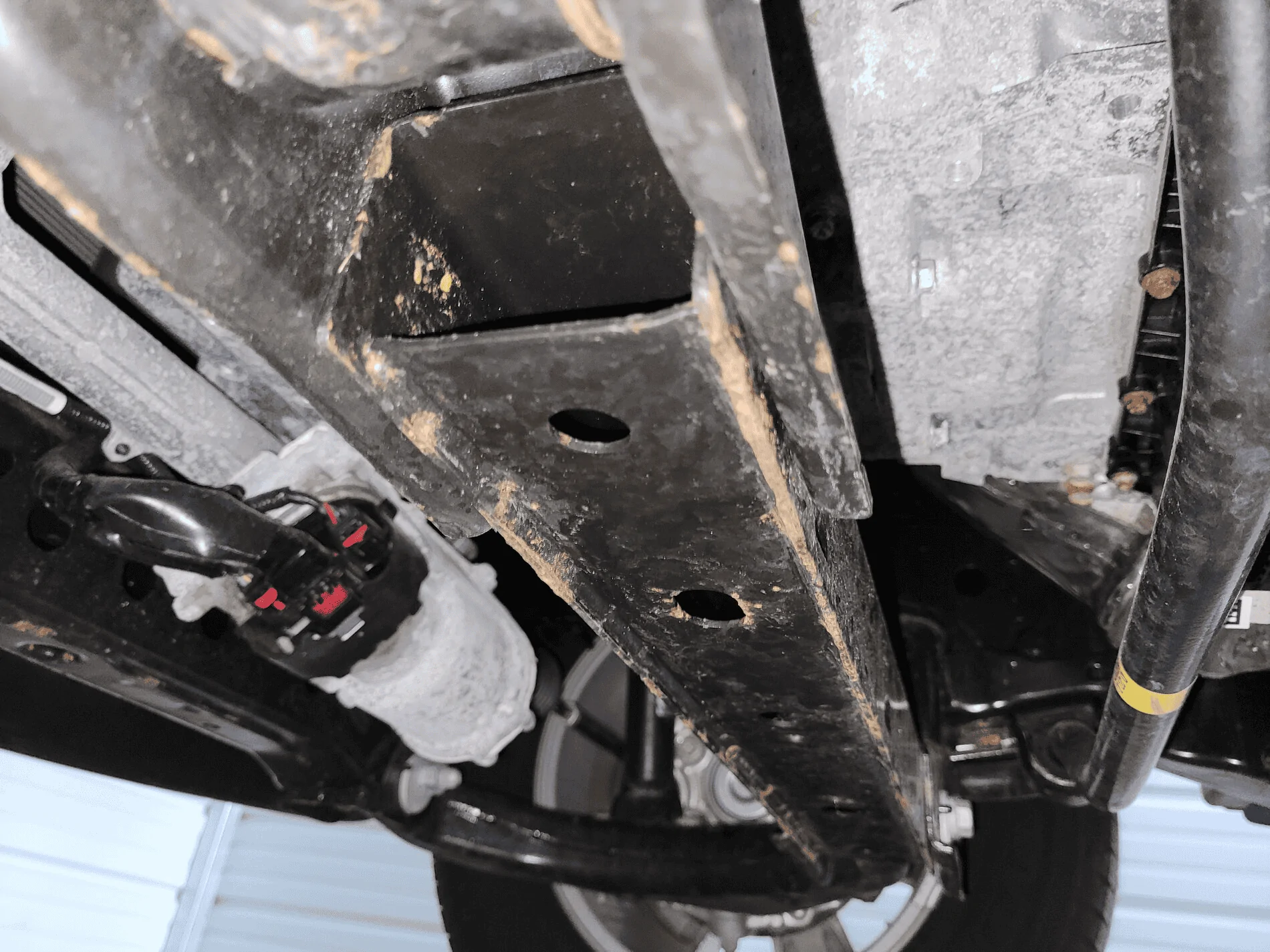

DMC, did you wipe your dipstick then reinsert to check the oil level? Almost looks like it wasn’t. The rusty under frame looks concerning.

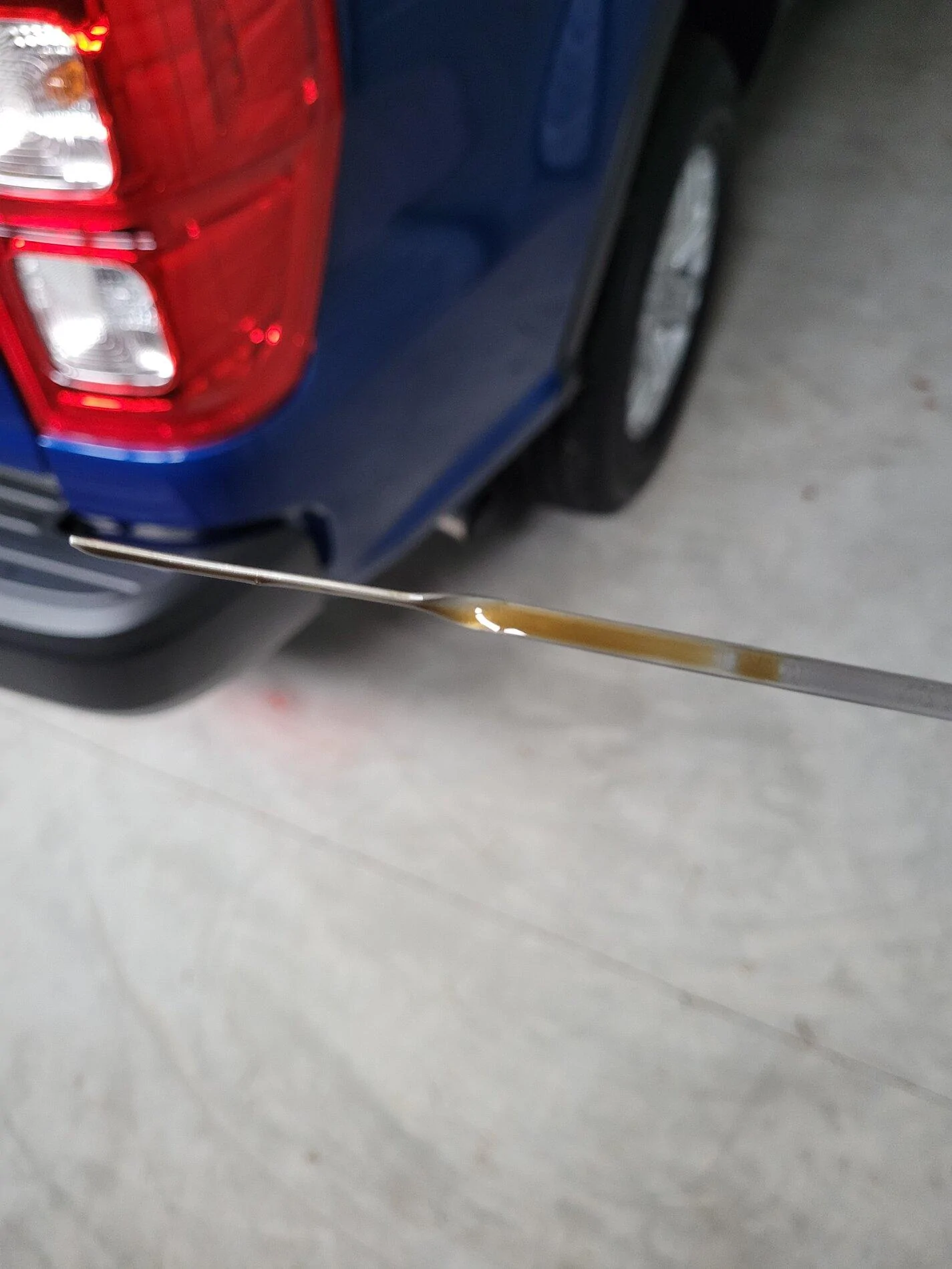

Sure did wipe the stick ? and the truck was cold hasn't run for 2 days b4 I checked it

DMC. that frame looks sad for a 3,500 mile vehicle. Has that been run through salt water or do they use that much salt on the roads up there?

No the truck lives in the south . The only time if at all salt would of got it was in delivery to the dealer from the factory. The oil was checked after the truck has been sitting for 2 days and the stick was wiped and reinsert and the pic is after I pulled stick after whipping it . So it's ether gas and smells like gas or over fill at factory. I am starting to notice reply of good oil levels are later year motors of 2020 mine is early .so I wonder if ford found a fix or changed supplier

I did 20 in the Navy. I highly suspect your truck has been exposed to salt water or some sort of highly corrosive environment.
Many years ago I was looking at a Bronco II that I was thinking about buying. When the salesman proudly told me the Bronco had been used in the commercial where it was driven along a beach I decided right then there was no way I was going to buy it.

Here is my 2020 with 3400 miles sure it has fuel in the oil yahoo ford ? Just goes with my rusty frame and cross members eng build date 02/05/2020
Looks like that crossmember has been drug through gravel and sprayed with something corrosive, like road salt... even the transmission pan bolts are rusted... WTH?

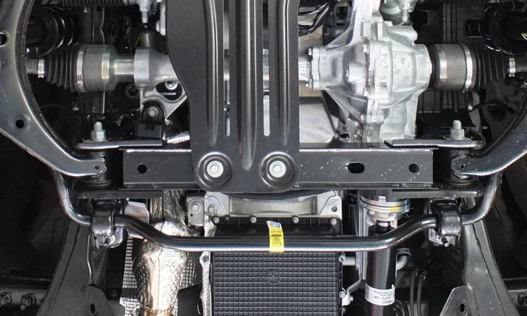

Here's ours for comparison..

Wow I would eat off that
