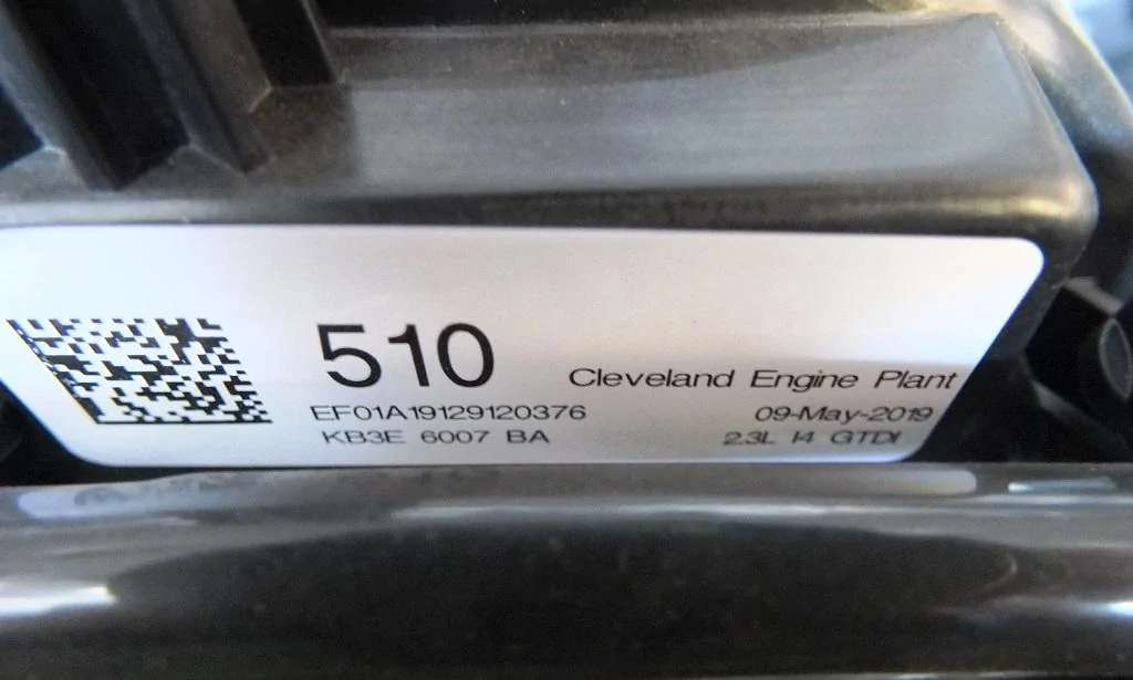

Those with fuel in their crankcase what is the manufacture date of your engine.

Where would one find that info?

Engine build date, is on the front of the valve cover.

Turns out my engine was built 1 day before the truck was! Sept 10 for the engineer and Sept 11 for the truck.
