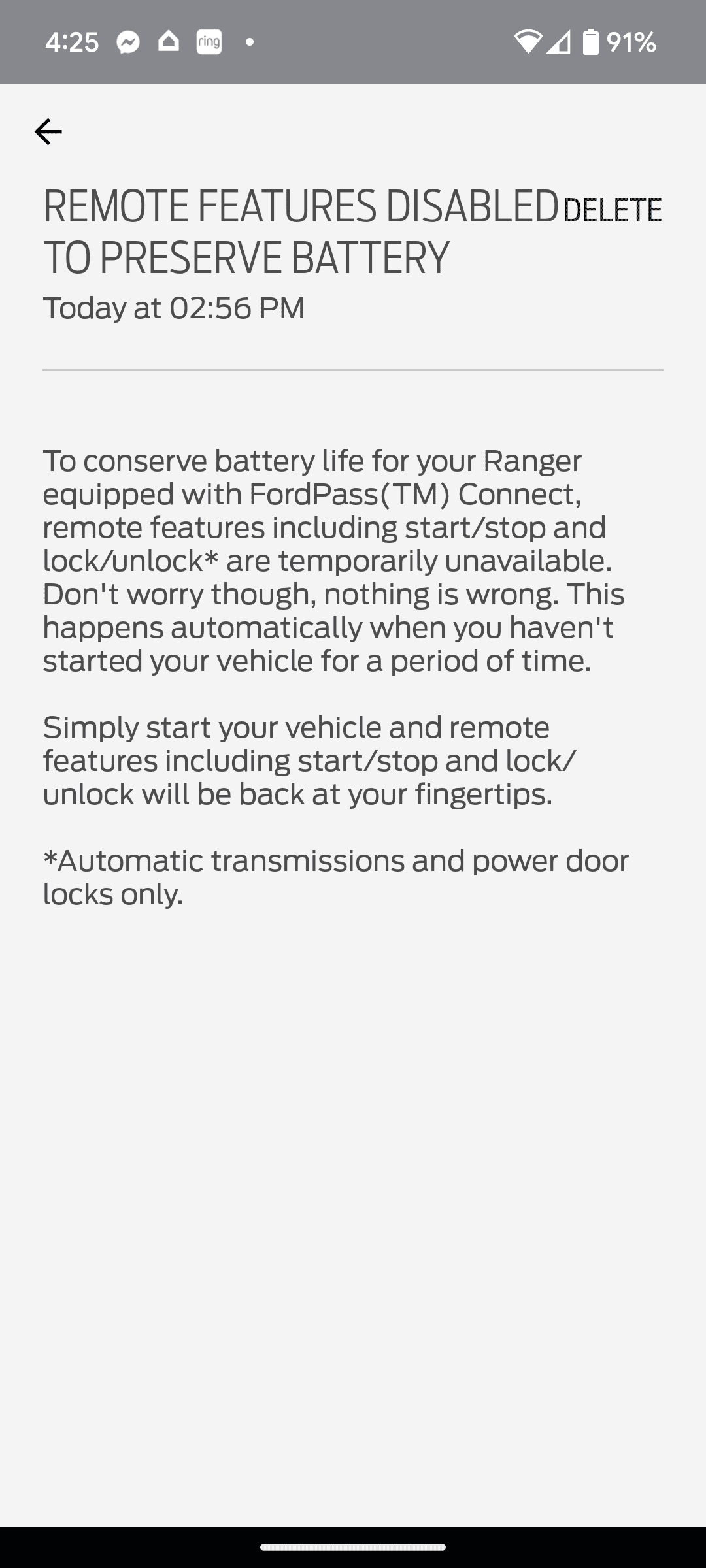

I have a battery charging issue which may be twofold.
First, due to life and health challenges, I don't drive a lot. Typically about 10 miles a weekday and maybe 20 on the weekend.
My Ranger is a 2020 and I have less than 14,000 miles on it,
My challenge is I keep getting notifications that FordPass keeps telling me my "Remote Features Disabled to Preserve Battery life".
I get this notice shortly after I drive anywhere.
I occasionally take long drives on the freeway but it only delays the notice. Maybe for a day. Considering the price of gas in California, this is an expensive way to charge the battery.
Ford recently replace my battery under warranty as defective.
So now my questions are - Is the low charge due to my lack of driving the truck?
Is there possibly something wrong with my charging system?
(I have a Garmin Dashcam plugged into my OB2 port but it pulls barely any power and most parking options are disabled)
I have considered getting a trickle charger to charge the battery.
But since I live in a condo complex, my only option is at work.
Will charging 8 hours at a time make a significant difference?
This has been annoying for a while. I appreciate any guidance or feedback.

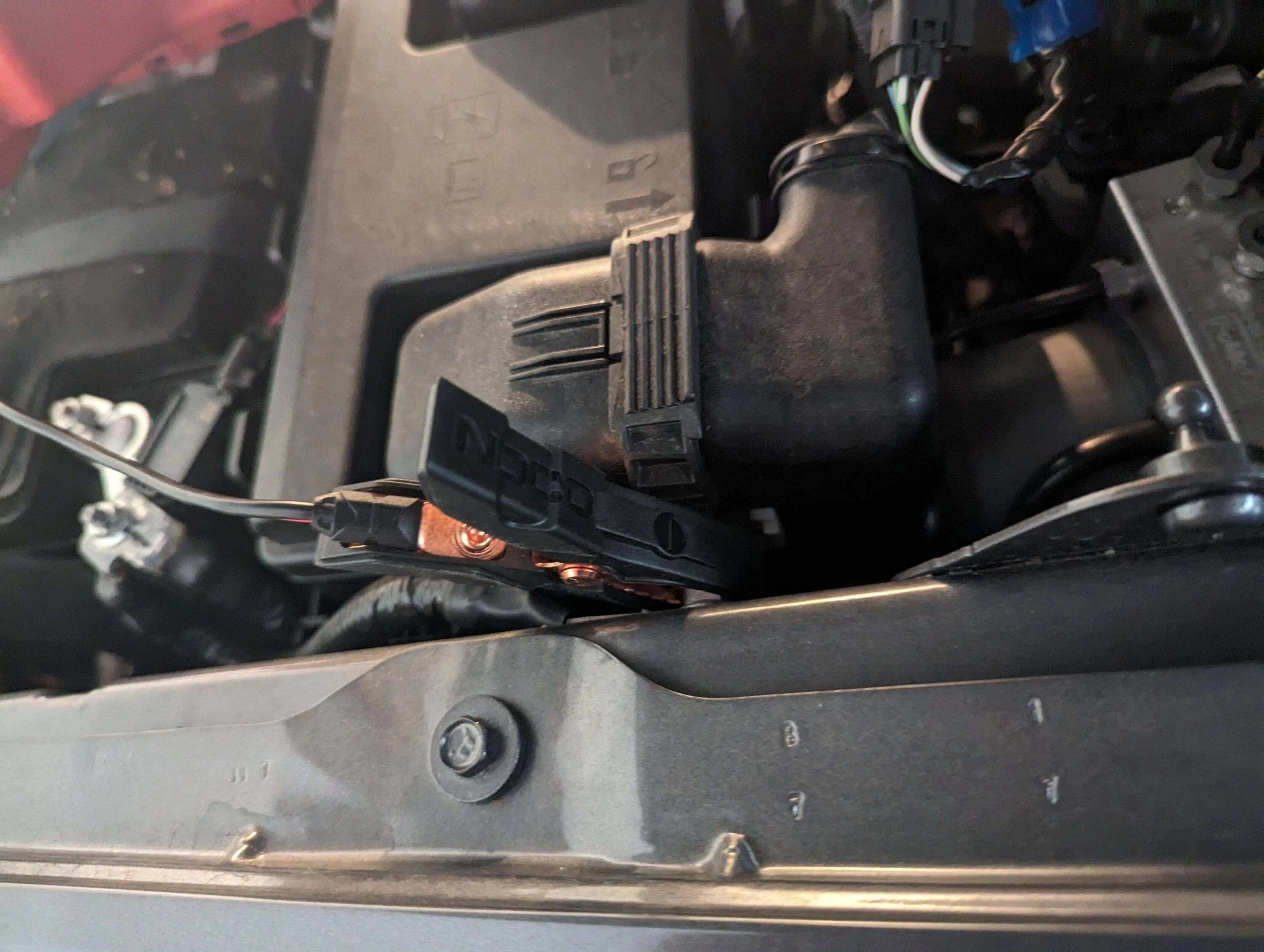

I might be a complete idiot, so I'm gonna ask you folks if I'm doing this right or not.
My 22 XLT has been complaining about low battery with it's auto stop-start (I do use and intend to keep using it), so I bought a NOCO battery charger as recommended on this forum.
Connected it to battery, set it to AGM mode, and let it go. It charged very very fast, like 2 hours so either the battery wasn't that empty to begin with or something is wrong.
Took it for a short drive today and ASS again complained about low battery. So I hooked it up again when I got home and charger says a full charge??
What am I doing wrong here?
Pics attached for how I have it connected in case I'm a complete f'ing idiot. Negative is attached to chassis ground as I've seen others do on here.

Not entirely clear in the pic, but you should put the clamp on the other side of the BMS sensor when charging.
I disagree. The BMS sensor is on the negative/ground terminal. The pic shows the negative clamp connected to a chassis ground. This should be ok. The error would be connecting the negative direct to the battery and bypassing th BMS sensor. The BMS should know that charge is entering the battery.
FWIW, when I use my small BatteryTender, it takes from 4-12 hours to fully charge my battery. I have my charging limit set at 80% via Forscan.
Ah, I stand corrected.

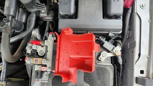

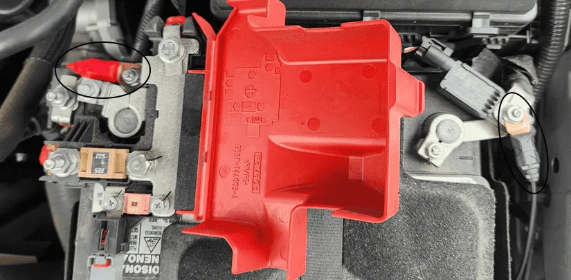

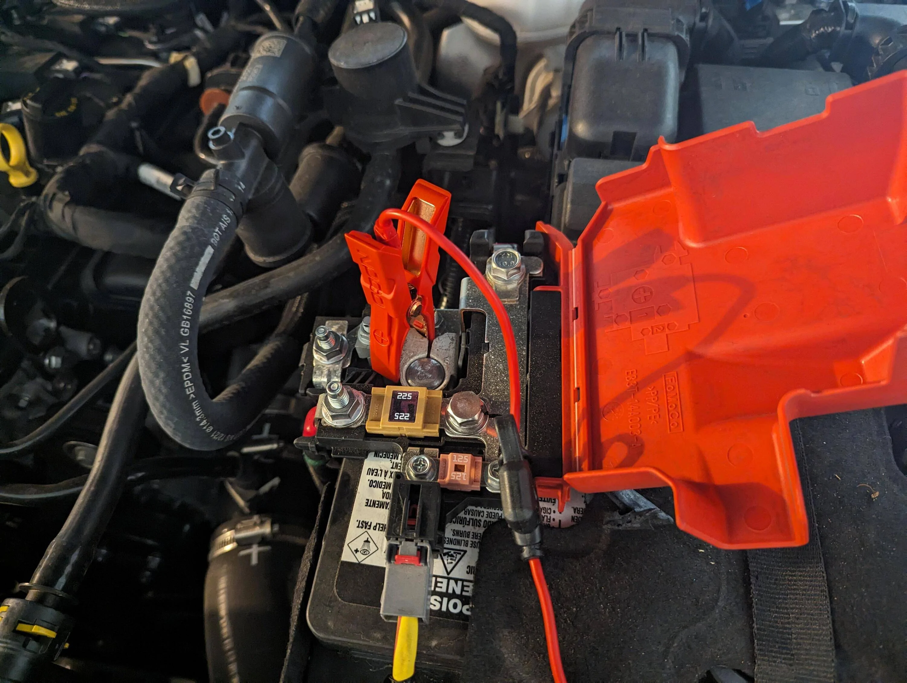

Here is how mine is installed.
It's a permanent mount charger, so it's lived this way for however long it's been since I put it there.
Circles indicate the terminals for the charger.
The length of time it takes to charge will be determined by how much juice the charger can pump out. Mine is a lowly 2A charger, so on a good day it's going to take awhile. When it's doing extra battery maintenance, it takes longer. If you're pushing a 10A or larger charger, it'll be able to do the work a good bit faster.
