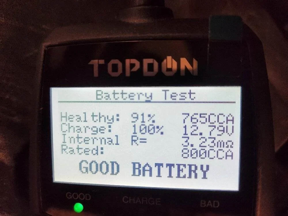

Haven't driven much so charged and repaired the battery with the Noco 5 and here are the results on an almost 5 year old battery.

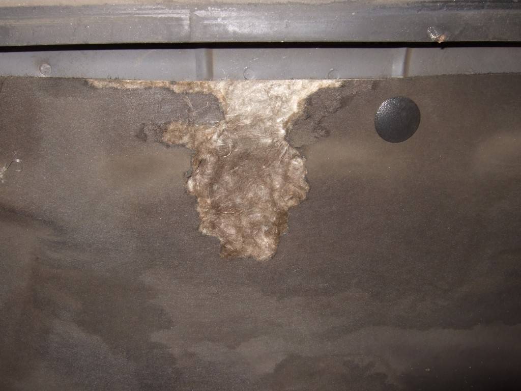

Remember when I said "He's Cute!" I still stand by that statement, but I have an update.
The little %%$#@ chewed on my hood lining exactly sitting in that location! I went out to change the oil in my 2005 Ranger, raised the hood and find this. To reach this spot he had to sit right at the apex of the fan shroud.... quite close to where "cutie" is perched!
The truck was parked in front of my detached garage (on a wide concrete pad) for 2 weeks while I repaired my Bendpak lift, and began spring cleaning my garage.
More traps laid inside the garage, but no takers. I suspect the little guy lives outdoors and took advantage of the free meal.
