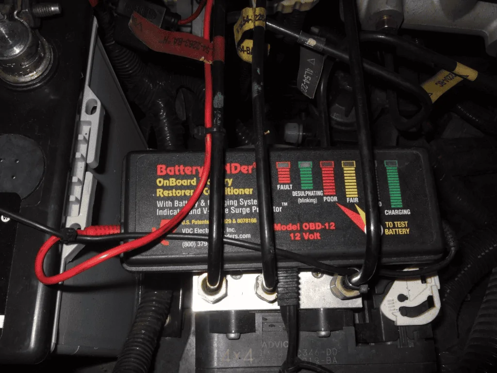

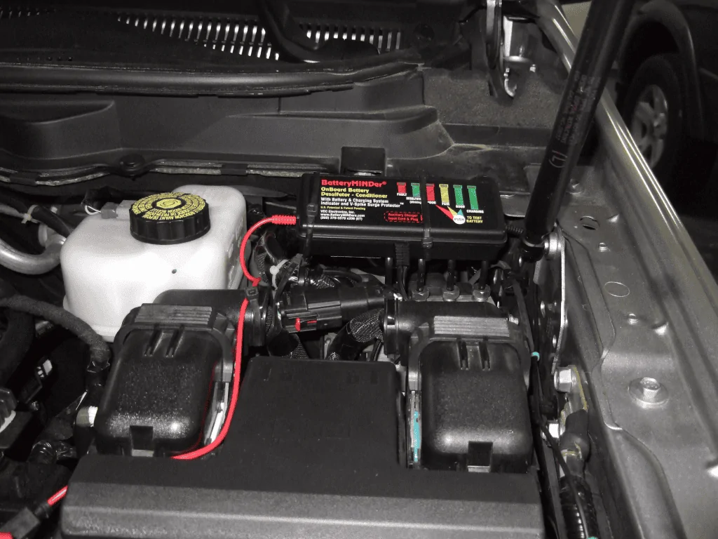

Here is a picture of the BM desulfator installed in my 2005 Ranger. It is sitting on the antilock brake module next to the battery. Nothing more than Velcro holding it in place. Been there for a very long time, 10-15 years. I've lost track of when I purchased it. I just put battery #3 in the truck 3 months ago. So 2 batteries replaced in 17 years, and the first one went a few years without the desulfator installed.

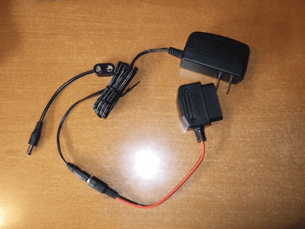

The second item was purchased quite a while back when I bought the truck. It is a small 12 volt adapter that is designed to keep your auto's computer settings when changing batteries. This means you must change the battery before a catastrophic battery failure occurs. You simply plug the device into you trucks Diagnostic port, and plug it into either a 9V battery (good for ~30 minutes with a new 9v battery), or a 110v wall outlet with a 12V wall wart PS. Then remove and replace your truck battery. This keeps power to your Truck systems while you switch out your battery. I bought it on a whim, and thought I'd never need it. Here is a similar device available from Amazon.
I will be connecting m BM Desulfator to the posts ( I will not be disconnecting the battery, just taking off the nut). And yes, it as simple as that. The pigtail is used when you wish to charge the battery through the desulfator. Simply plug your charger into the pigtail, and it will charge and desulfate at the same time. The same is true if you connect to the + battery post and to the nut before the BCM on the negative terminal.. The desulfator goes to work when it sees a charging voltage, be from the alternator or an external charger.

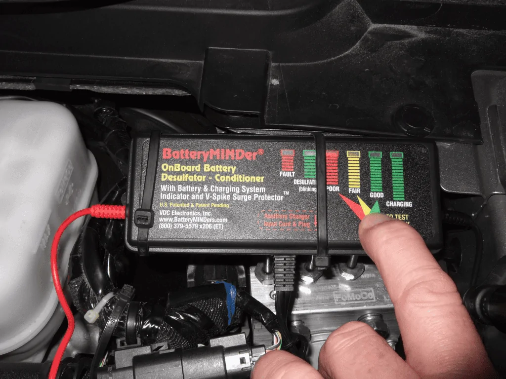

My BatteryMinder Model OBD-12 Desulfator arrived today, and it is now installed. It fit neatly above the antilock brake system up near the firewall. Took less than 20 minutes to find a suitable location and secure it.
The not so good news is that upon testing the battery condition, the Desulfator reported my battery in only "Fair" condition.

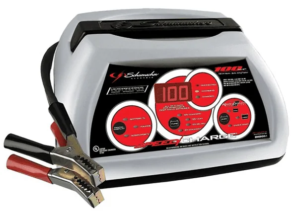

I put my Schumacher SC10030A charger on the 2020 Ranger this morning, and it reported the battery to be at a 70% charge. This correlates with the BM Desulfator, and Ford settings to stop charging at 70%.
When a battery is not at a full charge, sulfur crystals form on the lead plates causing resistance to increase. This ultimately results in shortened battery life. I think Ford made the decision to lower the charge level of the battery in an effort to increase CAFE mpg of the fleet. Every little bit helps, even if it results in shorter battery life.
I'm breaking out ForScan and setting my charge rate to at least 95% and I may go to 100%. After my first pass through of Steve's "5th Gen Ranger Charging System Dissertation" (very impressive work!). I will raise it to 80%.
