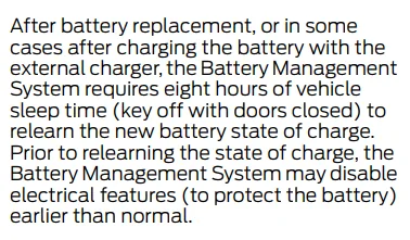

I'm willing to bet that the battery reset just didn't work. Leaving the battery alone overnight (8-10 hours) performs calibration/reset of the BMS on its own.

I was under the impression the vehicle had to be locked for that to happen. It’s garaged. I think the calibration with a fully charged battery is what made the difference.
Nope, just key off with doors closed, doesn't need to be locked.
Page 264 of the 4th edition manual.
In that case it had plenty of opportunities to reset. I didnt try charging the battery and then resetting for a month or so. Been fine ever since.
Anyway I just got out of the habit of fully charging a battery before installation. Its part of the job.
