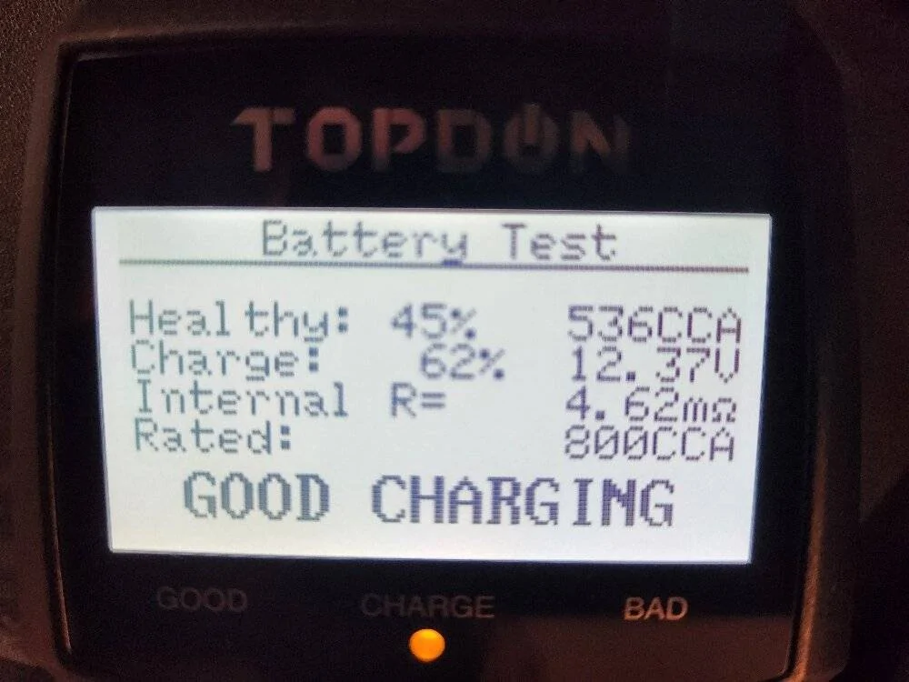

Unfortunately it looks like around 48% is the best I can repair my battery to.
Took this reading right after doing repaie mode and turning headlights on 30 seconds, then testing with them off again.
I would do more repair modes.
Tony knows more about this stuff than I do - but IIRC some desulfators have 2 modes, one with puts extra strength pulses into the battery - these are typically more expensive. And some gurus on this subject matter identify "hard sulfation" which is resistant to breaking up and sometimes cannot be broken up . And yes I would run the NOCO or whatever you are using in repair mode for several days or even a week before giving it up for dead.
Done about 5-6 over the last two weeks. Not sure what battery status was at the start (no fordpass low battery warnings) but the last 3 haven't got me above this point when testing with the topdon.
Guess there can't be much harm giving it some more repair sessions this week and make sure.

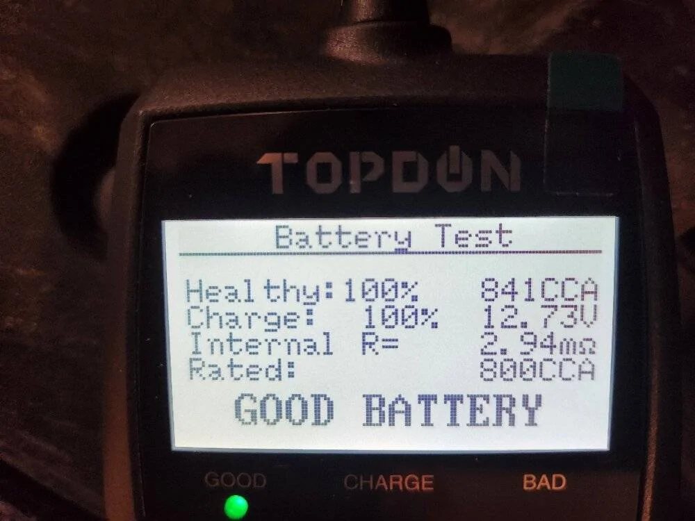

Mine wasn't so good back in Feb. when it was cold.
and got it to here.
