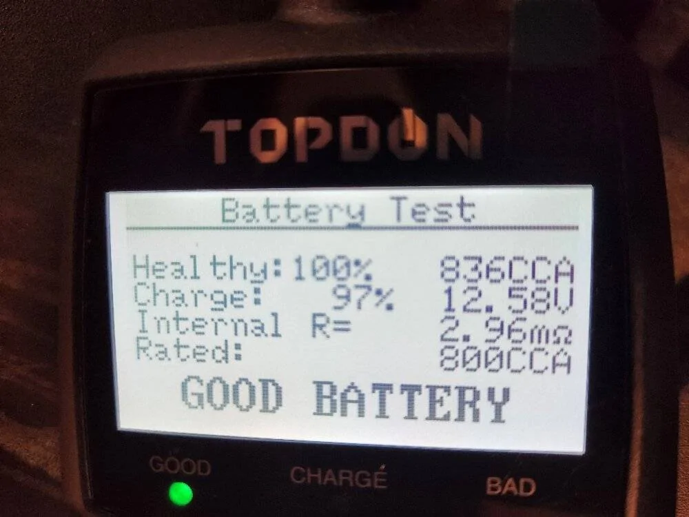

You bet, this modern stuff (compared to 1972 tech) is way beyond me and I try to be prudent. I did disconnect both and my challenge was unclipping that front connector (BMS?). Me and plastic ... =p
You were all correct! That TopDon is so sensitive, a totally great reading this time:
Thanks everybody for helping me learn and extra thanks to our resident tech ninja: @airline tech!
Your battery is in excellent condition according to the tester.

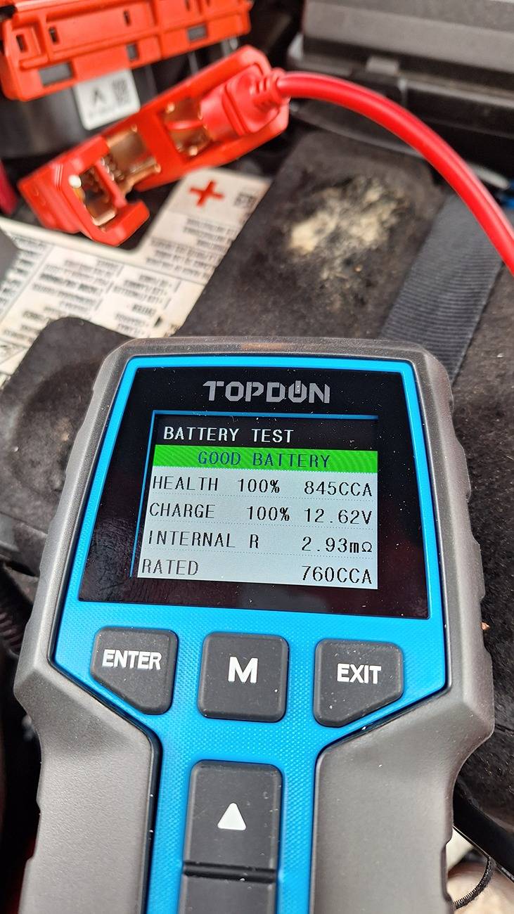

This thread, with the battery tester that @subquark posted got me to finally test my battery. I bought the same tester he did, and it came today. I've had a replacement battery sitting in my garage for almost a year now, in anticipation of needing to replace my battery. I was still on my original battery, which was 5 years and almost 4 months old. I knew I was on borrowed time.
Anyway, the battery tester told me what I expected, the battery needed replaced - it was at like 41% or something like that, so I pulled out the old one (MAN, there are a lot of wires attached to it!!!!) and put in the new one - a Weize AGM battery which I got for $125 delivered:
https://www.weizeus.com/products/we...otive-battery-140rc-850cca-36-months-warranty
I put the new one in, did the driver window reset, checked the new battery with the battery tester (100% all around which surprised me since its been sitting for so long), and then did a BMS reset using FORScan. I had to reset some of the gauge layouts I had done but other than re-selecting FM for the radio, everything else looked good. I did notice the TPMS sensors weren't working but after driving just a short distance (a tenth of a mile or so) they all chimed in.

Rob, you got some good life from your OEM battery. Desulfated my OEM earlier and it still has good numbers. Not sure what that code is but @airline tech probably does.
My battery:
My battery:
Given how much electronics, etc there are on this truck I can't complain at all getting over 5 years on a battery. As I recall the internal resistance on my old battery was like 8 ohms and it was only at about 340CCA.
