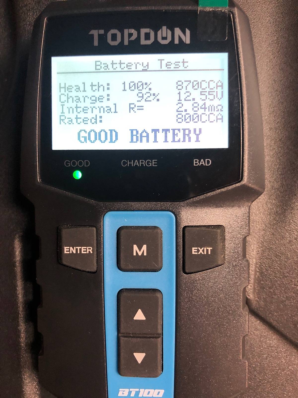

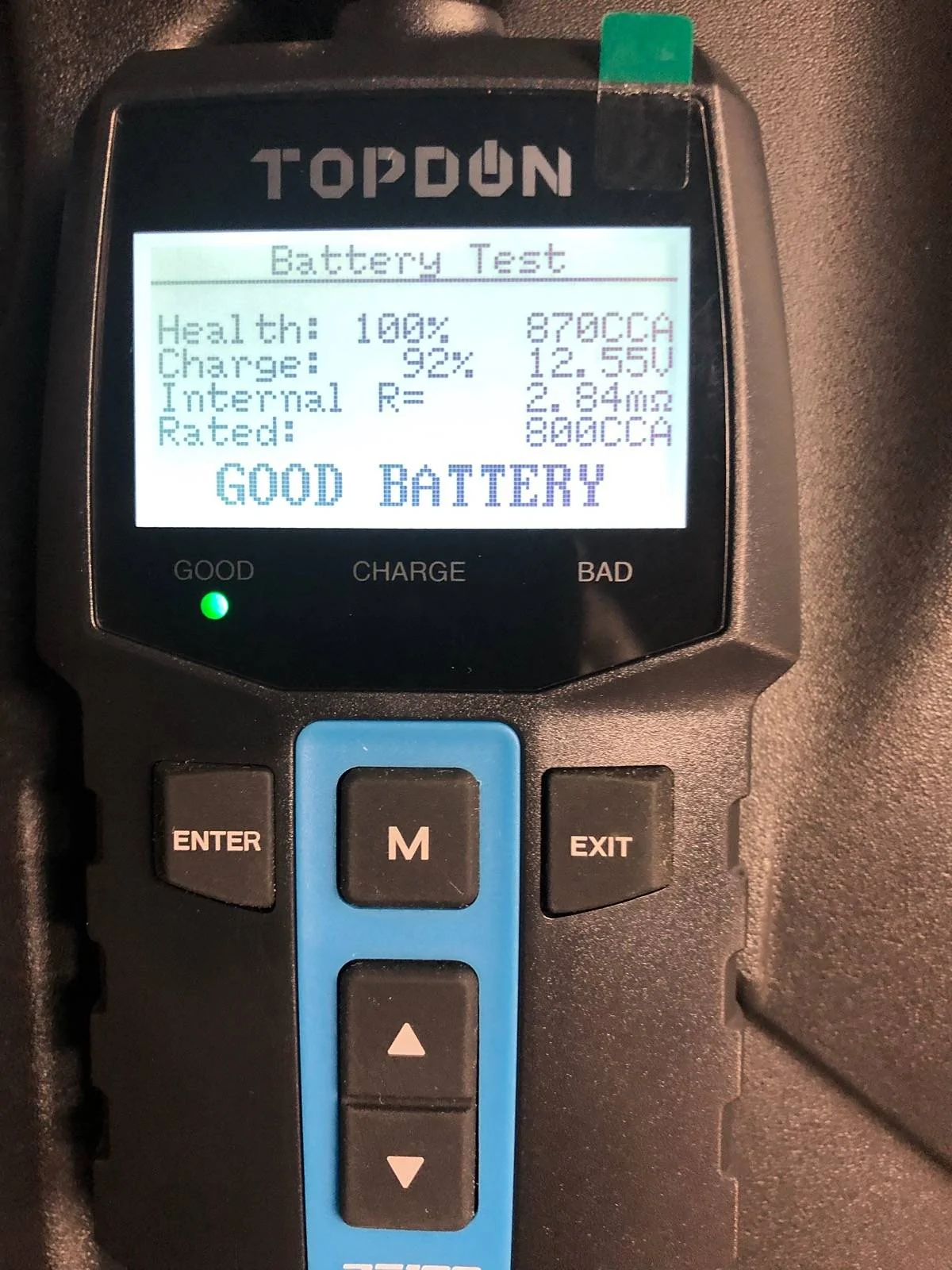

Received my BT-100 yesterday. $29.99 ebay.

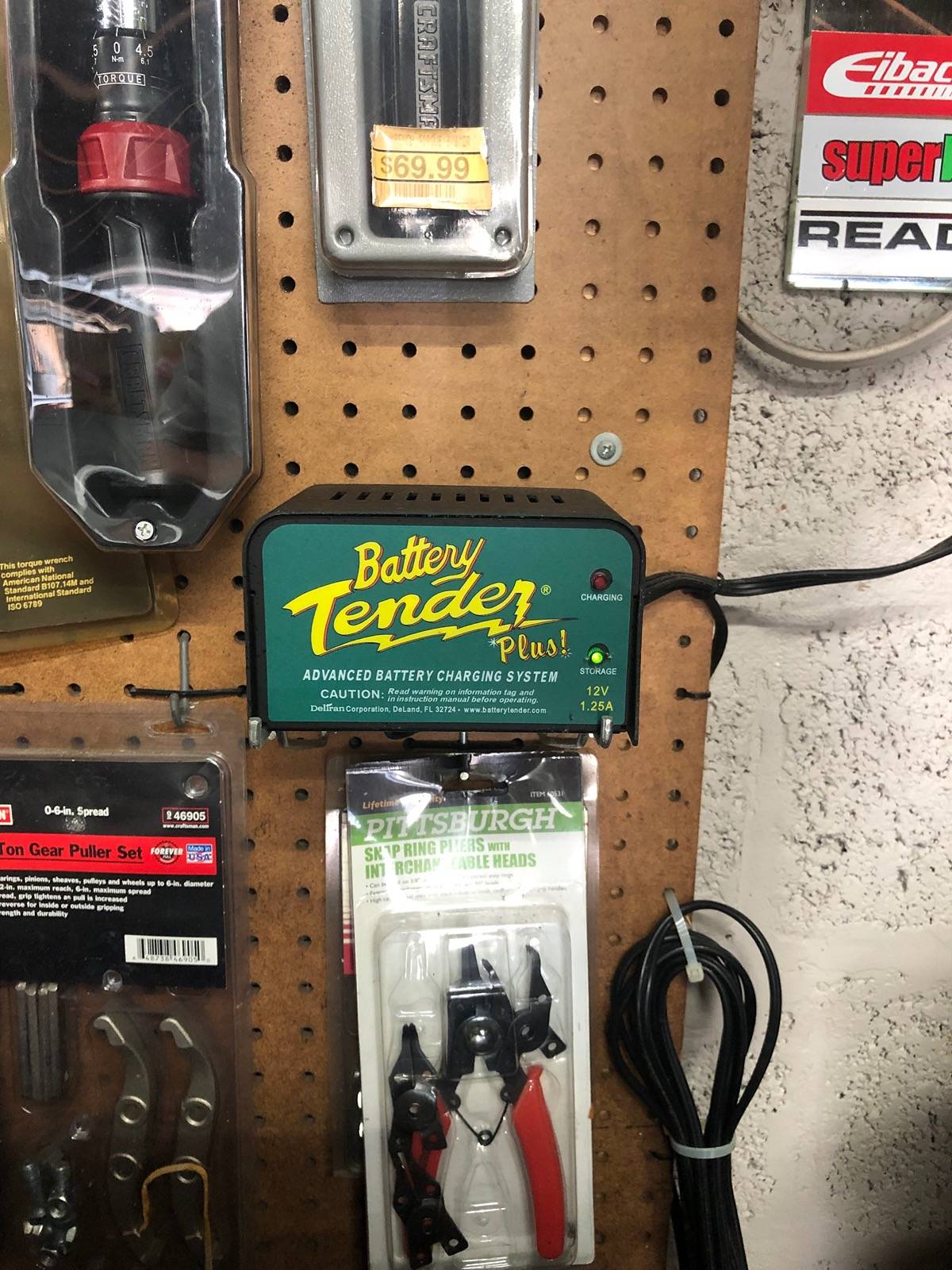

Truck has been hooked up to my Battery Tender Plus almost religiously 24/7 since I purchased it July 2019. It was off the charger for almost a day and I hooked it up late last night. This was my results after checking it this morning.. Not bad and very pleased for a 92% charge and 5 years old.. Nothing disconnected.

Wish my tools were that organized ?
Mine are just thrown in a toolbox or cardboard box ?? and I play hell trying to find a tool. Sometimes I get so frustrated that I can't find it that I just throw up my arms and go buy it again.
Then I find it ????????

Great numbers Tony.

Great numbers Tony.
Thanks, Steve. Interested in seeing what they are going to be at 100%. Thanks for bringing up this Bt-100. Definitely a fun toy and better than a Multimeter.

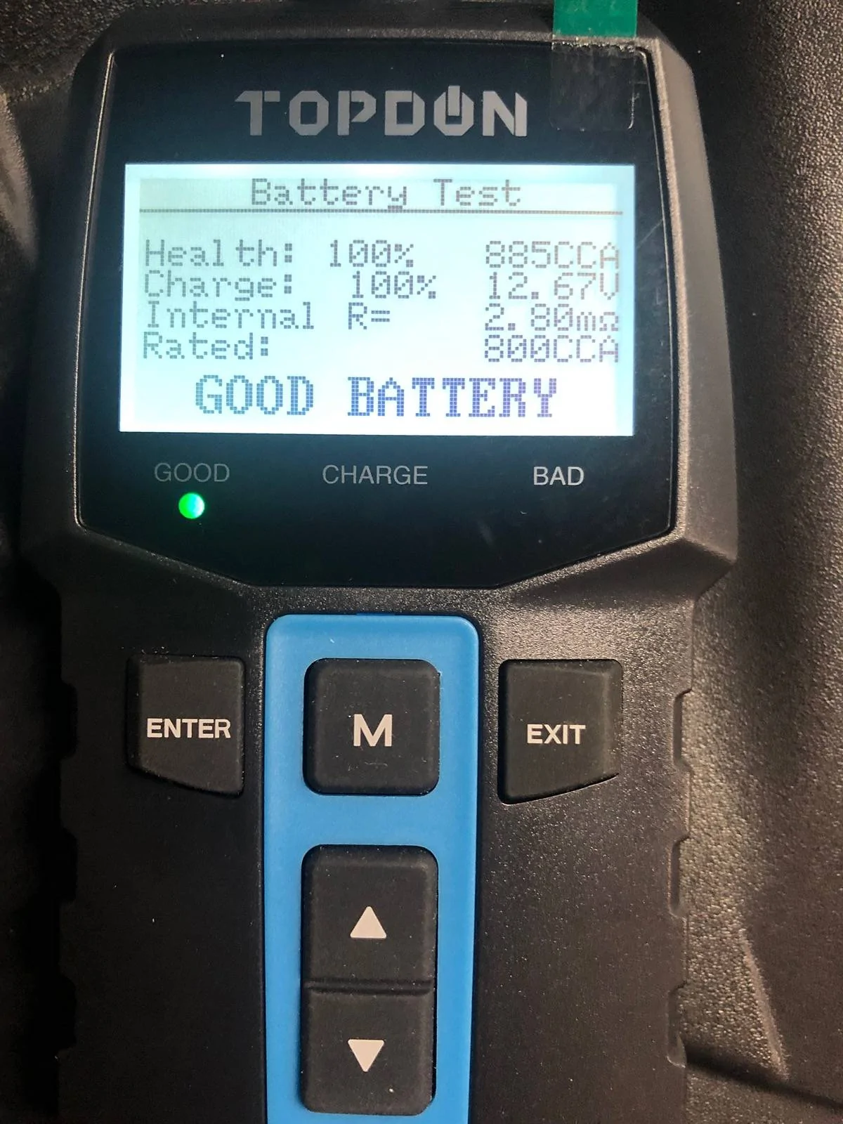

My numbers have gone up at 100% charge. 5 years old in July, oem battery. Nothing disconnected.

How is a "TOPDON" (sounds like a XX film title) test conducted - is it just a momentary hookup to the battery to conduct the test or do you leave it hooked up for a longer period ? These type of testers calculate off of the IR reading - which tends to decrease over a few minutes even under a small load , your SOC reading at 12.6 should indicate a less than 100% charge, it's possible your battery may be healthier than the "DON" is telling you just as I'm skeptical at some posts indicating their CCA level after 4 yrs is significantly above the mfg CCA rating - these testers always aren't known for great accuracy. But you need to run the repair mode for several days and see what results you get.
