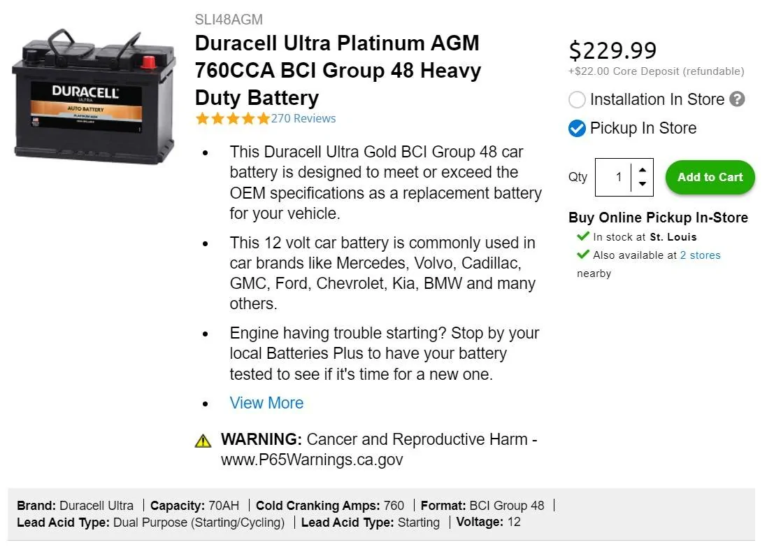

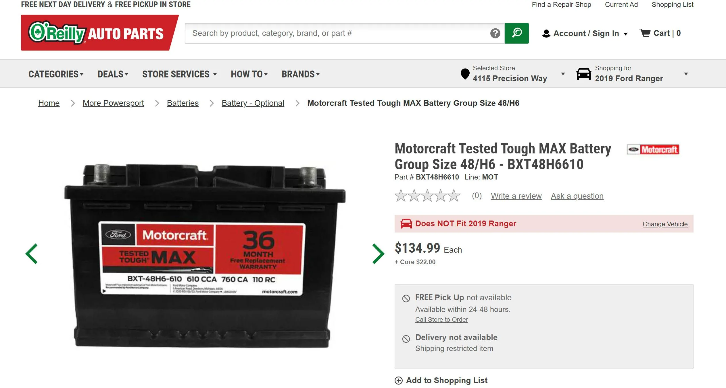

XL and XLT have group 48. Lariat has group 94 I believe.
Mine is dying or dead after 110K miles...last two start needed assist from my NOCO...last night I fully charged it and it still needed a bump start this morning...
Has anyone dropped a 94 in to an XLT and is Forscan needed?
Which brick/mortar store can I go to pick up one right away? Thanks!
Why does O'Reilly say this does not fit?

O'Reilly's can be silly sometimes. That said you should be able to drop it in with no problems. Just make sure you do the BMS Reset. You can use ForScan or use the procedure in the owners manual.
