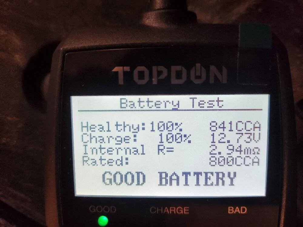

I still have the BMS connected. I have not driven the Ranger much the last few weeks so gave it a charge and ran the repair mode using the Noco5. Super happy with the results. Finally got the CCA number above the rated number and IR looks good.

Excellent numbers!
Is the battery original or new?
I still believe it is optimal to have the ASS off and the BMS sensor disconnected, but I can't argue with your results. Those are very good numbers.

2019 original. :thumbsup:
If it wasn't for you and a couple other battery experts I probably wouldn't have an original. I have learned a bunch about batteries here.

Like dtech said, I would run the repair mode more times. I agree on spending more on tools but I caved and got a reasonable priced Topdon BT-100 battery tester for about 60 bucks.
