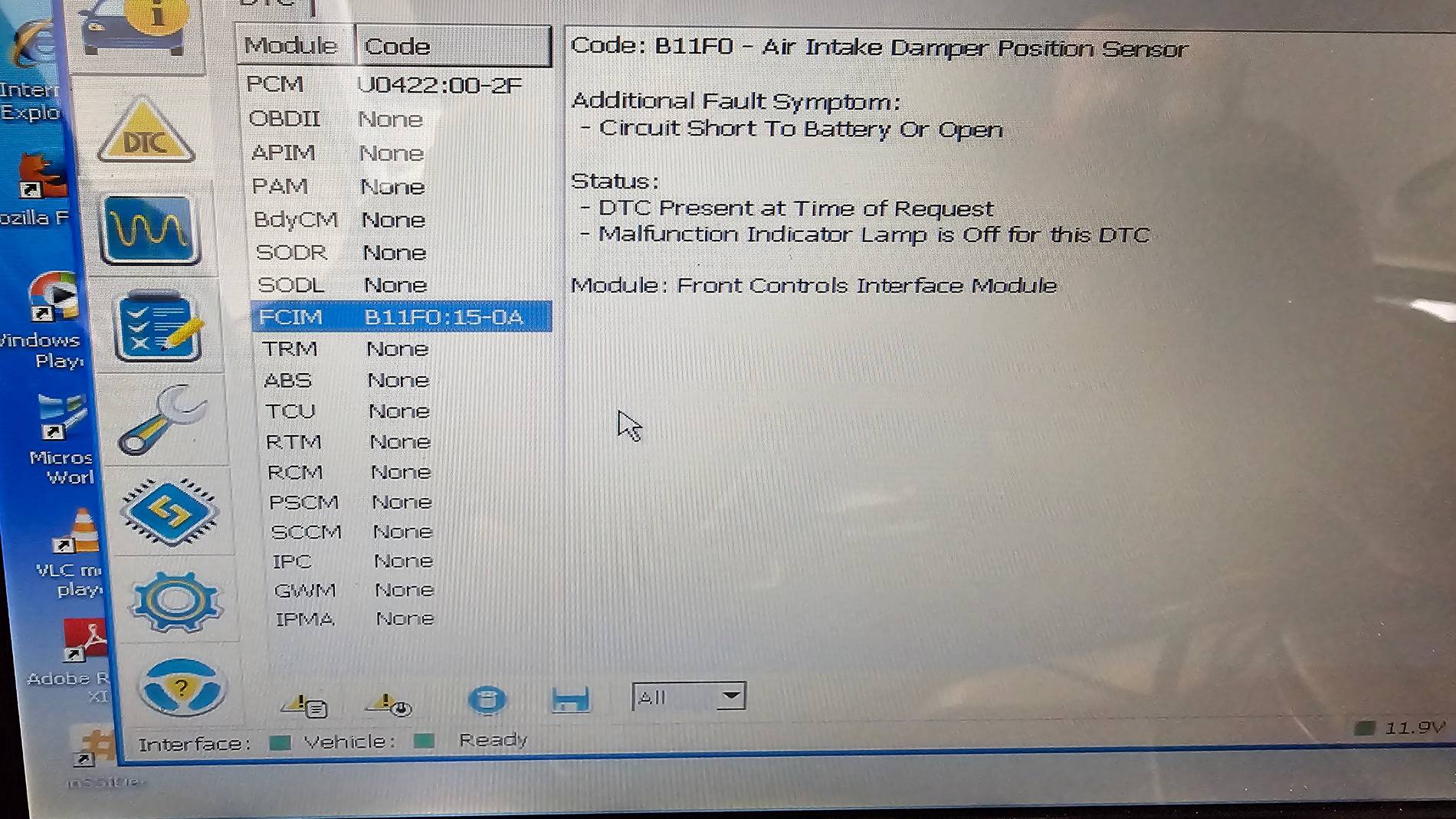

Anyway, when I was doing the BMS reset, I noticed a DTC code - B11F0:
I cleared it and restarted and it came back - at first I thought it might have been something with the battery replacement but it does not appear to be. Anyone know about what this means and/or if I should worry about it?

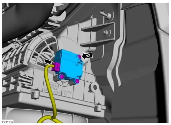

That actuator is located behind the glovebox and is part of the HVAC system. The DTC code is indicating that the module senses a short to voltage or an open on air inlet door actuator circuits when motor movement is commanded.
Here is its location behind the glovebox.
Strange - The HVAC is working really well. I had someone in the truck the other day and he wanted me to turn it down - the A/C was working TOO well.
Maybe I'll poke around that actuator and see if something is loose or something.
Thanks

I think that actuator is controlling whether air is entering from outside or inside the cab (recirculating), so the AC will still work.

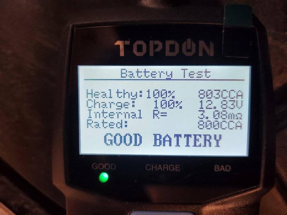

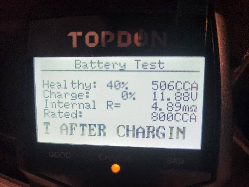

I may do a reset as a test since my battery is getting long in the tooth.
Truck sat for only a week then I charged and desulfated it.

I finally got time to look at this - I think I found it and nothing looks wrong. All wires intact. Since everything seems to be working fine I've decided I'm not going to worry about it....
