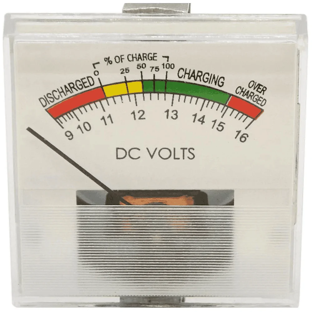

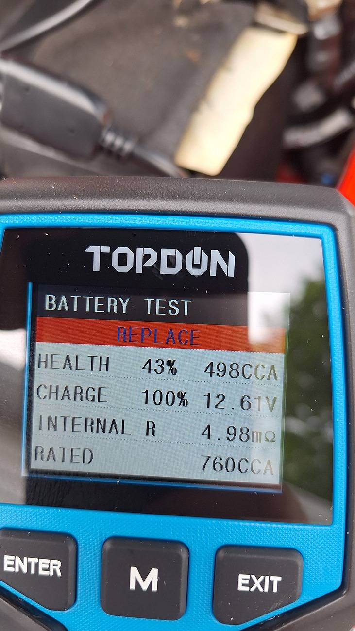

Everyone talking about poopie battery life led me to get a real battery meter, well, an economical one.
And this is on my battery that's "fully" charged by the CTEK (in fact, and maybe this is bad, but it's connected as I tested it!).
This doesn't look so good to me but I don't know what it really means. I selected AGM and set 760 CCA ...

Some good information if you as me. More or less tells you that you need to look at another battery. Your call on where you go to get the new one, but I certainly recommend spending the money on a good one

After posting, I saw that it says REPLACE in a red banner up top, derr ... =D
Thanks Frenchy for cluing me in, so it really is bad, bummer. =(

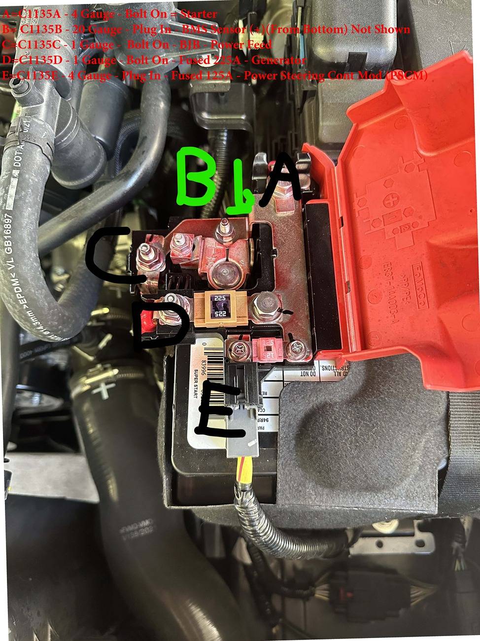

Bear in mind that the Top-Don type testers use resistance as a factor for the test.
You can get varying results, where you hook up is the key
I suspect you just need to get a better connection. (Top-Done) connectors.
Since it is almost imposible to get a direct connection to the Battery Posts (when installed)
Use the small stud (next to the post (+) and then connect directly to the (-) posts
As a reference - I connect the (+) to the stud by the green arrow as the clamps for the Top-Don will not fit into the recessed space of the battery terminal
This is not a precise test, but it is the best testing hookup locations we have, to provide semi accurate results without pulling the cables and direct testing the battery posts.

However, if you have a verified good connection, for testing purposes, then the results you have of IR - 4.98 is high, needs to be in the low to mid 3's (average) for a good battery, 3.2 to 3.6 range when using the Top-Don tester.
The IR and CCA - readings are related to each other, the lower the IR the higher the CCA will be.
Thanks for the specs, I don't have a frame of reference for this.
I'm so old school in my mechanical stuff and this is new to me (and interesting).
I appreciate you giving me this concrete info to help me learn and understand it better.
I'll do more testing with it off the CTEK and after sitting a few hours. And I'll make sure I have good connections. I was able to directly clamp the ground but was on a bolt for the hot.

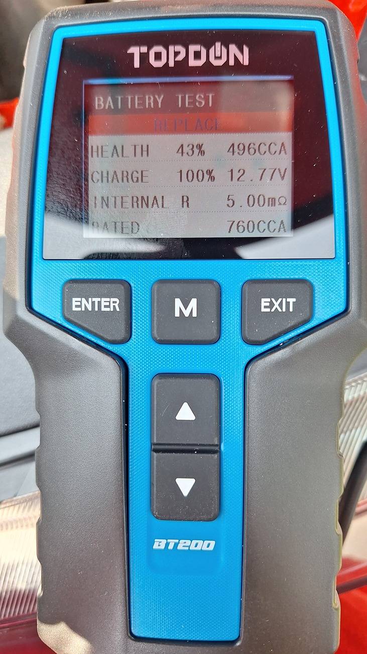

Thanks everybody on the awesome info, really helps me understand what it all means.
That resistance one is toast - as high as 5!
I made an appontment for the dealer to test with their big tester. We'll see how that goes on Tuesday.
My battery is probably as good as it can ever get, the CTEK mxs5.0 desulphates and I use it quite a bit (more than once a week on average).

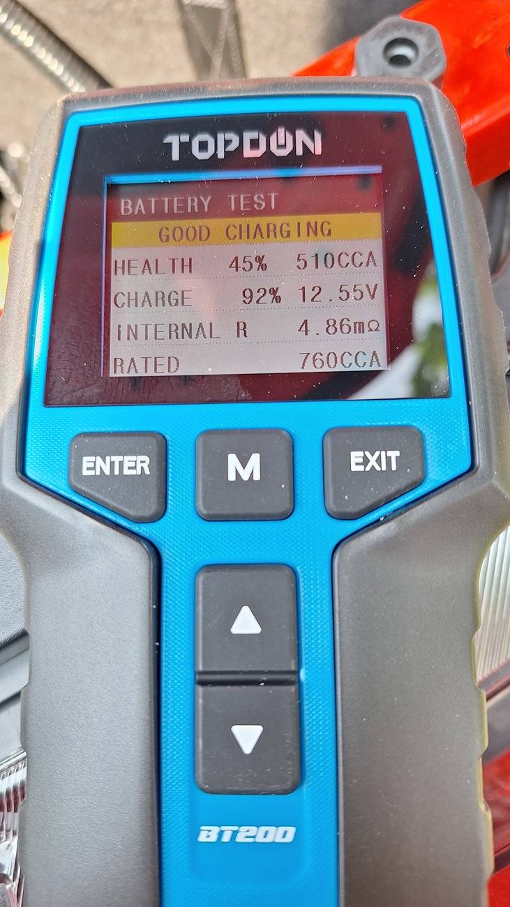

at least it's charging (this is after only one start, after the pic below)
this reading is just a few minutes before the top one (before doing charging test)
