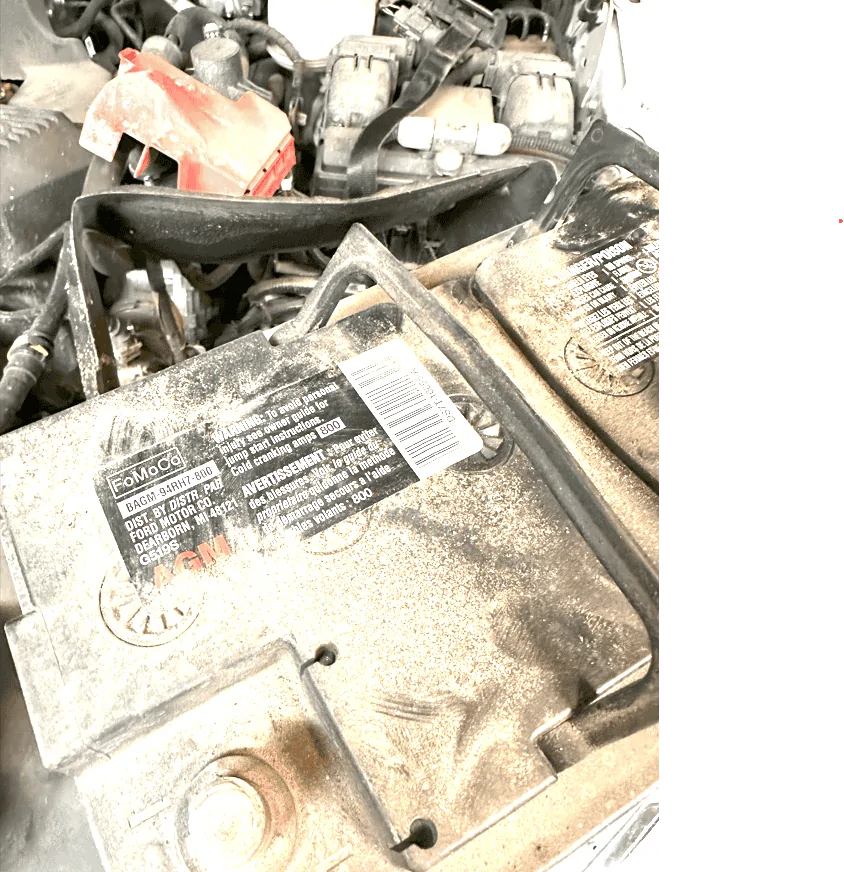

Put a Costo Interstate H7 AGM in today, great deal compared to the parts stores or even Walmart.
The factory battery is very plain and only 800cca compared to the 850cc Interstate AGM.
