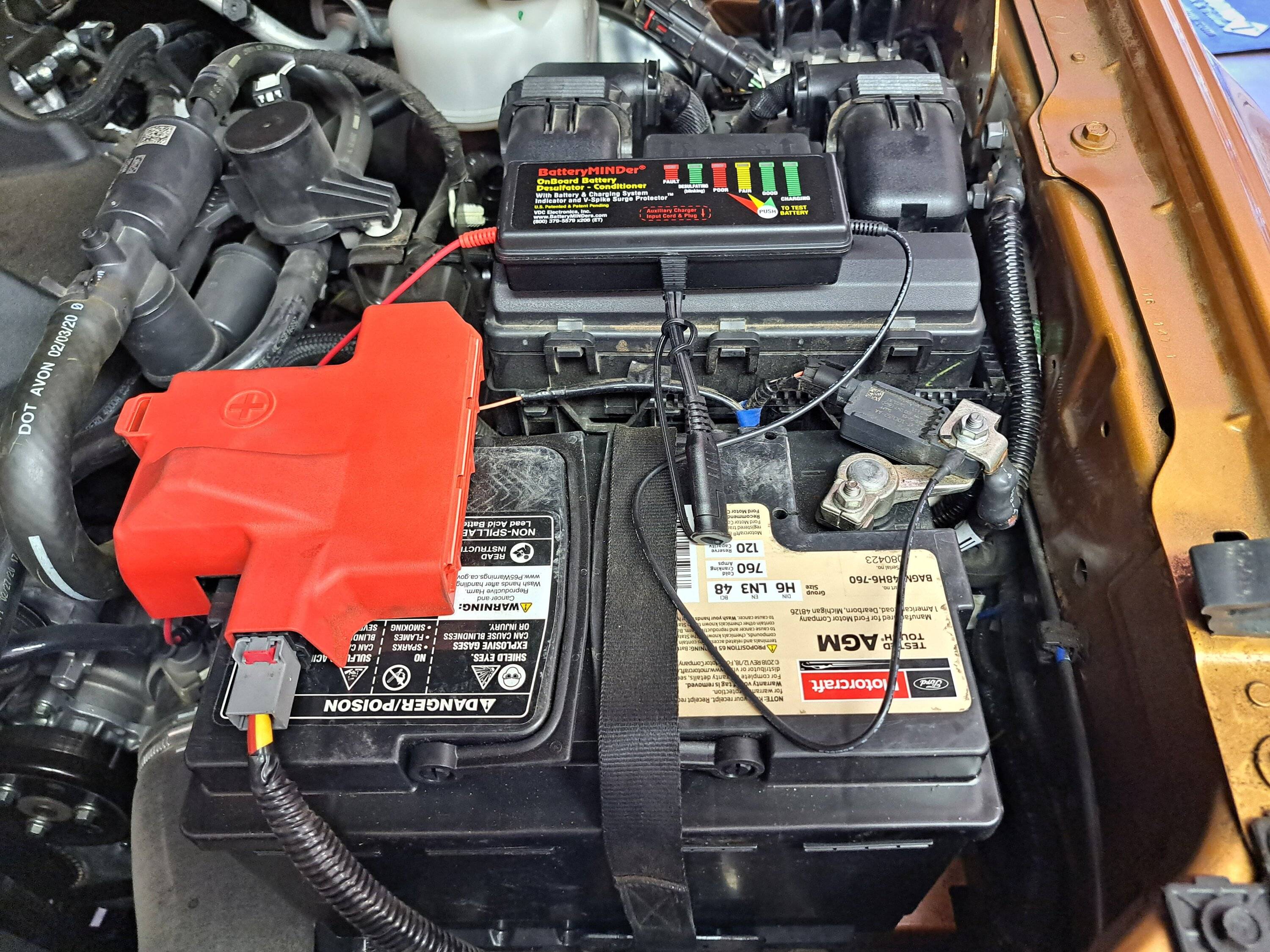

Duke, that is right. My battery maintainer (BatteryMINDer) was recommended by a very knowledgeable source... Tony @TJC and has worked well for me. It is installed to the battery and disulfates it while the truck is being driven. I also use a NOCO charger which I connect to the battery when the truck is parked in the garage to maintain the correct charge and also disulfate the battery when the truck is idle.

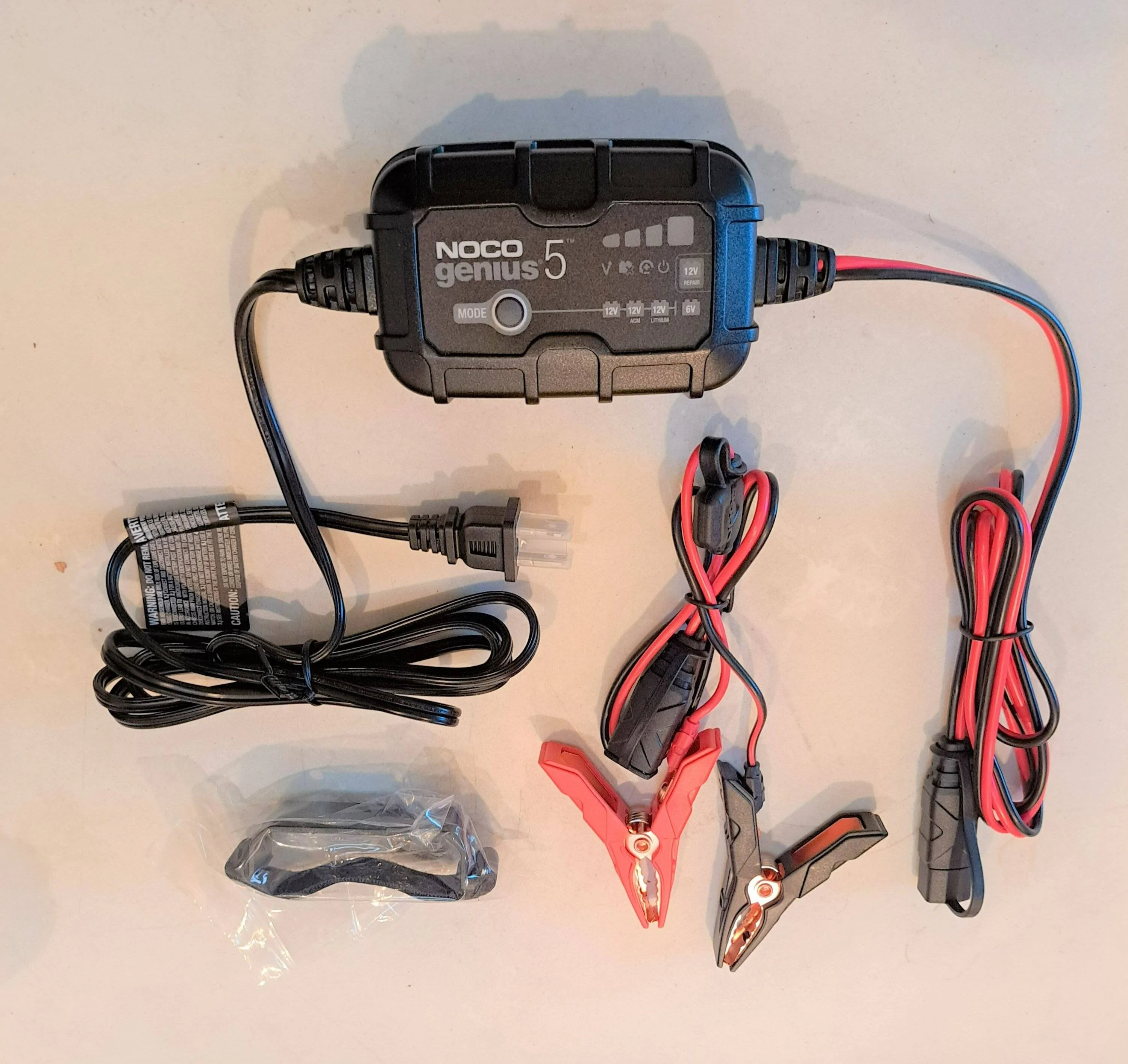

I have mine set to 85% in Forscan and it wouldn't charge beyond 12.55V even with my NOCO Genius5 charger directly connected to the battery terminals for 3 days. So in my case, it is likely a sick battery.

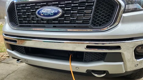

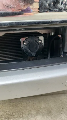

I put a NOCO Genius 2D in mine. On mine, I've got the charger permanently mounted inside the engine bay and I attached a GCP AC port (the 1E IIRC)
GCP AC Ports (no.co)
This way, my charger/maintainer is always with me and all I need is a regular ol extension cord.

If you have approximately 8 hours to charge, I suggest getting a charger with at least 4-5 amp capacity. Also, since your battery is AGM type, get a charger that’s compatible with AGM batteries. This is what I have. It works great.
I’ve got that same charger for my Ranger, Bronco Sport, Branson Compact Tractor, and Polaris Ranger
