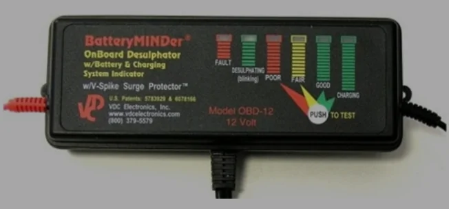

Iirc battery minder makes desulfator that is on-board the vehicle, they have been around a long while and likely actually designed devices, today there are a plethora of batt chargers with basic desulfation, they just send pulses of ~ 15.5v to the battery to dissolves the sulfite crystals, more advanced and expensive units also use high frequency pulses to desulfate more hardened crystals. I bought a low end Chinese brand which is likely little more than a knock off of brands like noco or ctek, it works well. If you put a voltmeter on it when in operation you can see the pulsed voltage.
I actually found a desulfator schematic from an electrical engineer who designed his own and I built one. I needed It to support 24v systems... They worked, but are no where near as effective as the BatteryMinder, and they do not turn off when power is removed, a big downside. I installed the home built ones on my power backup systems that support my servers, entertainment center equipment, personal computers, and the wife's automated home made quilter system. I got tired of replacing those small 12V batteries anually. They now last ~5 years.
VDC is a privately owned American company, and the BatteryMinder products are designed in house. I think that some of their proucts are built in Asia, but all Designs and QC is tightly controlled by the company in the USA. They been around since 1993. There customer support team is very good too!
There technology was/is heads above competitors... not sure if all their patents have expired, but they use various high frequency pulses (not high voltage) to desulfate batteries. (I suspect some have as high quality competitors in recent years have entered the market.)
My newer CTEK seems to do a good job, but the onboard BatteryMinder desulfater activates when I use any charger on my vehicles, even the old school analog chargers (I've got a couple of 15Amp ones that I need to use occasionally).

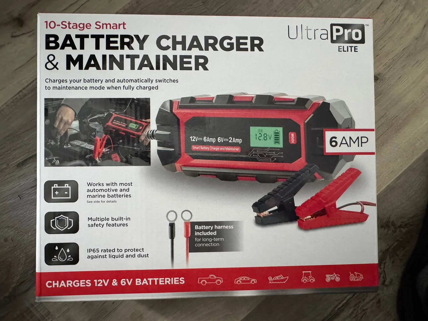

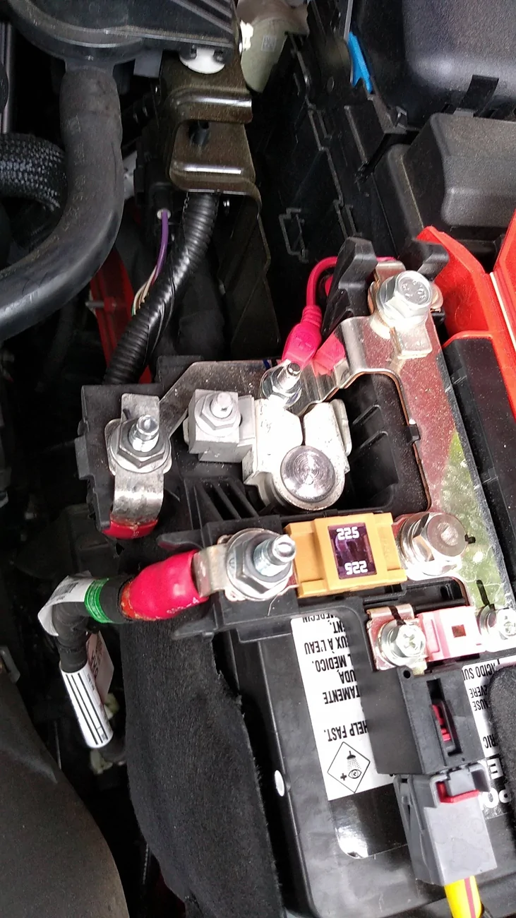

I recently (2 weeks ago) hooked up a battery maintainer, because the truck will sit for a few months. Right after I did that it went into sleep mode within a day or two. It has done that multiple times now even after a few long drives. After which I reconnected the charger.
Maybe a coincidence that it is happening now? Before using the charger it would sit 10 to 14 days before sleep mode. Battery is just a few months short of 5 years old. While driving scan gauge shows charging at 13 to 14v. Maintainer will show charging up to around 13v then shows full. Scan gauge reads 12.8v when charger is showing full. At the same time I started charging it the SOC was changed from 75 to 90% in Forscan.
Picture below shows where the positive is connected, and ground is on the frame. The other wire below charger wire is the lead for my auxiliary switches. Also included is a picture of the charger I am using, which was bought from Costco. It is good for all types of battery including AGM and has a maintenance function.
Am I doing something wrong?

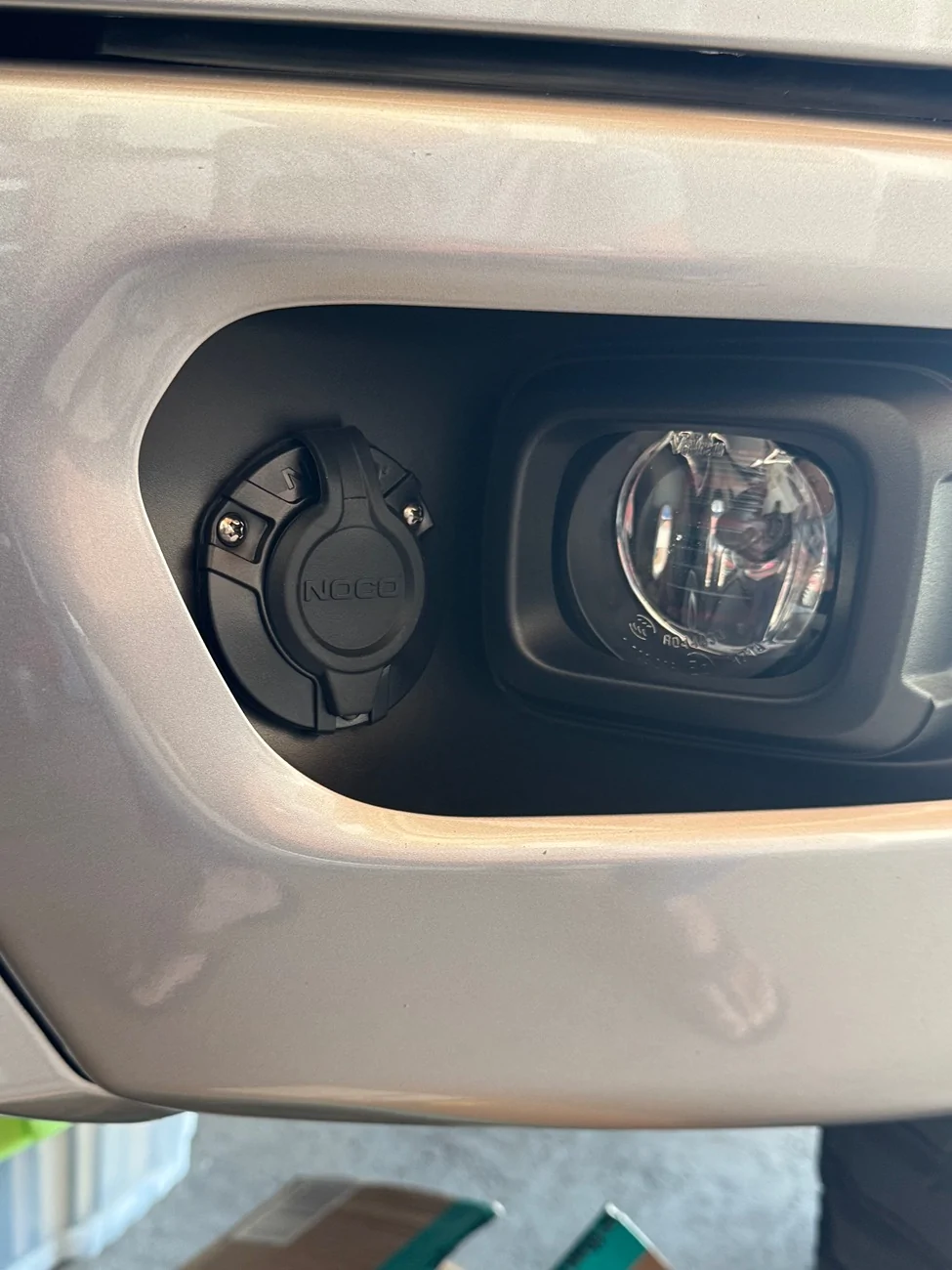

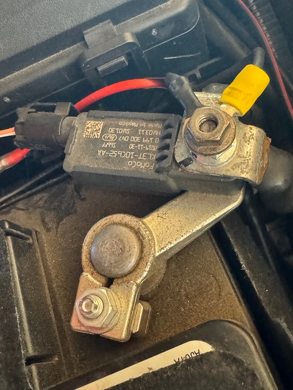

I hooked up a NOCO under hood trickle charger. I followed Makuloco's advice regarding battery charging. At 8:45 he explains how and why to place the negative clamp for the system to read charging. I have a 2020 Ford Ranger with original battery. If I don't drive it for awhile, I plug it in, it's always fully charged.

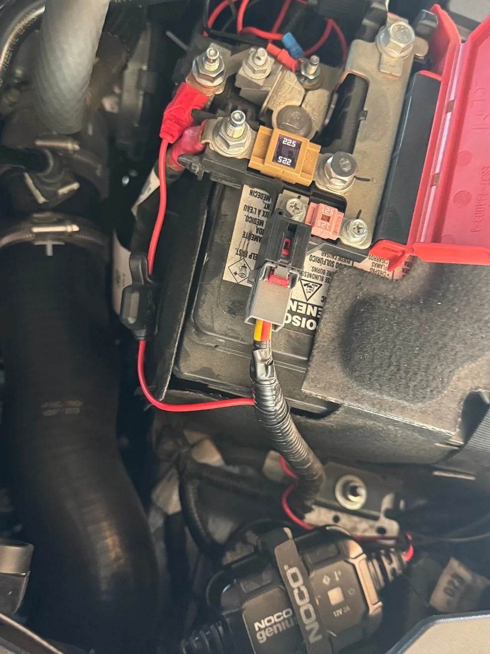

Wow, that nut barely has a thread holding it on.

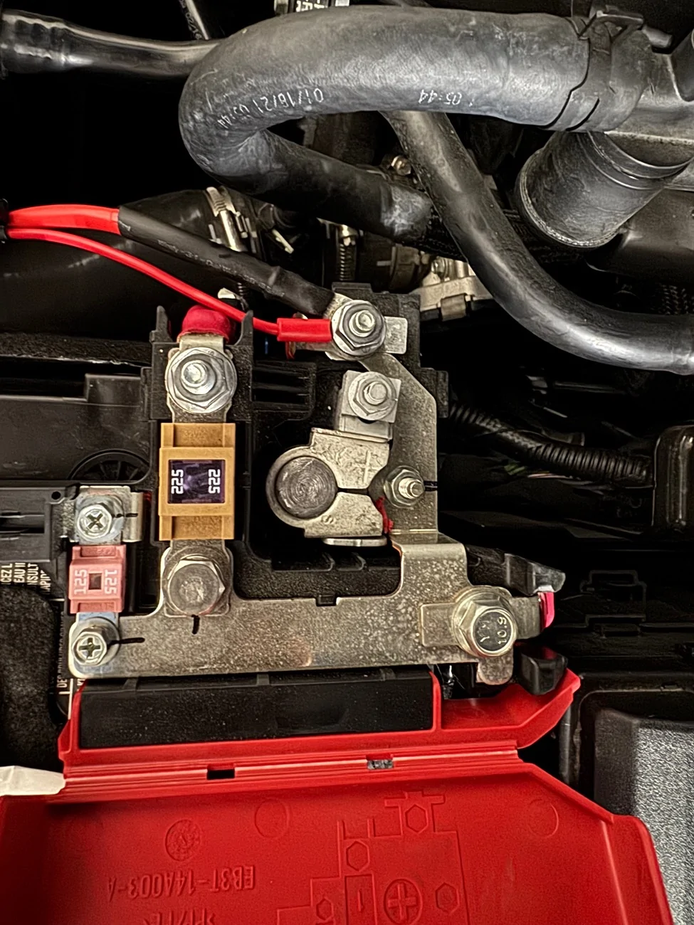

My CTEK works great on mine, but it did seem to take some time to no longer get the "turning off features" notifications.
When I first installed it, it felt like I was getting more notifications. Maybe Soupie had to relearn the charging setup? I dunno. =(
But it's been great for the last three years.
You can see where I connected mine, following @AzScorpion's advice. =)
