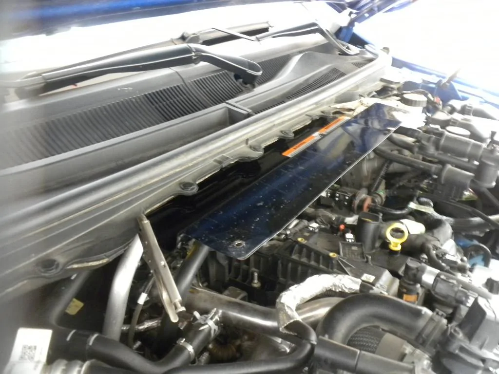

I pulled the clips on the upper and lower cowl cover and put in butyl tape, it's the light grayish tan stuff oozing out of the joint (circled). Hopefully that's sufficient to keep water from dripping on the engine.

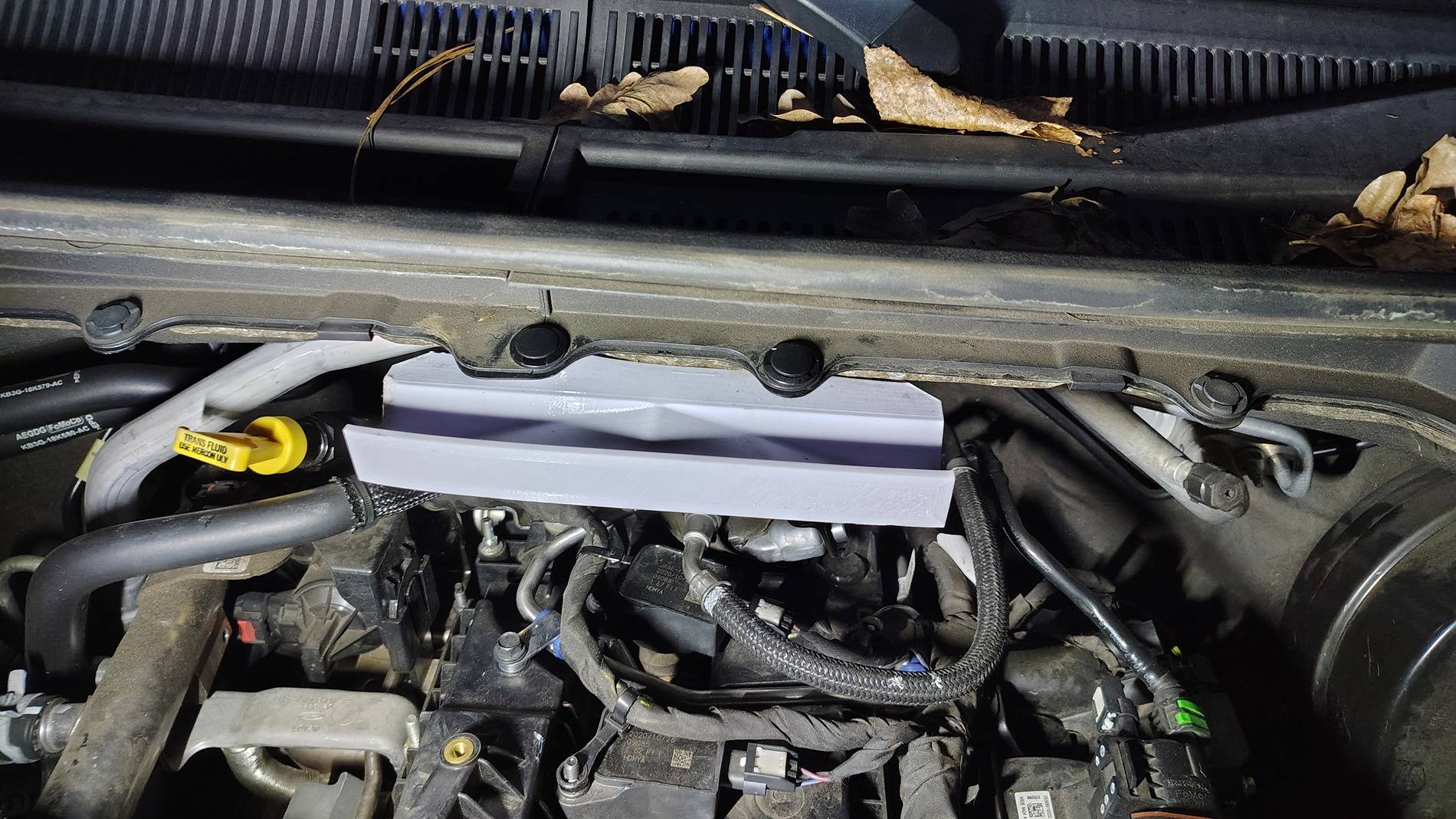

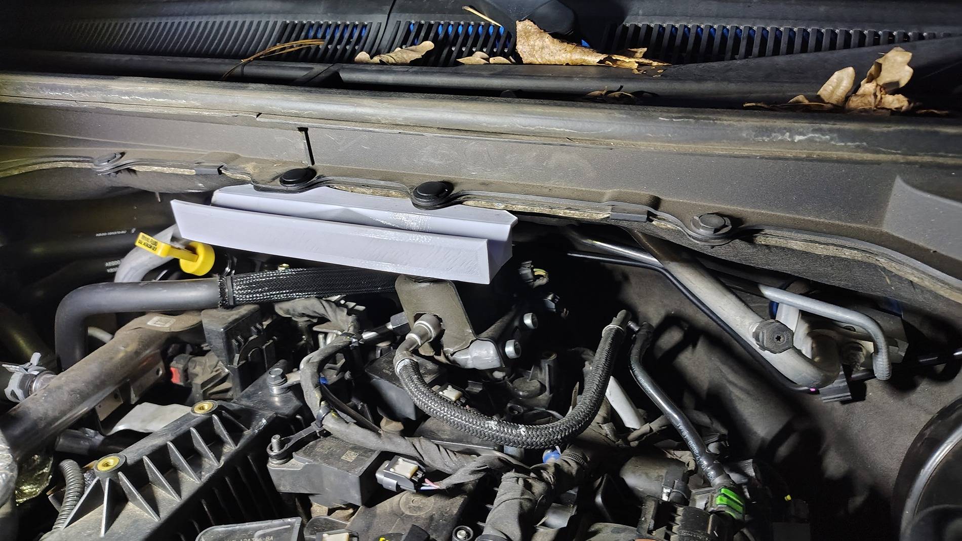

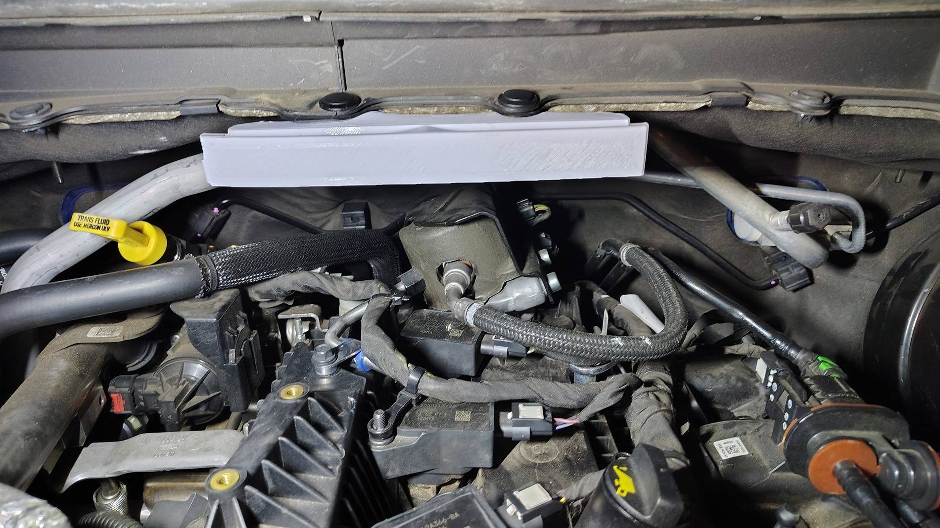

My “Rainguard Thing” from ctechbob fits well. I have no idea what happens in the rain yet since everything falling now is solid and not liquid.
