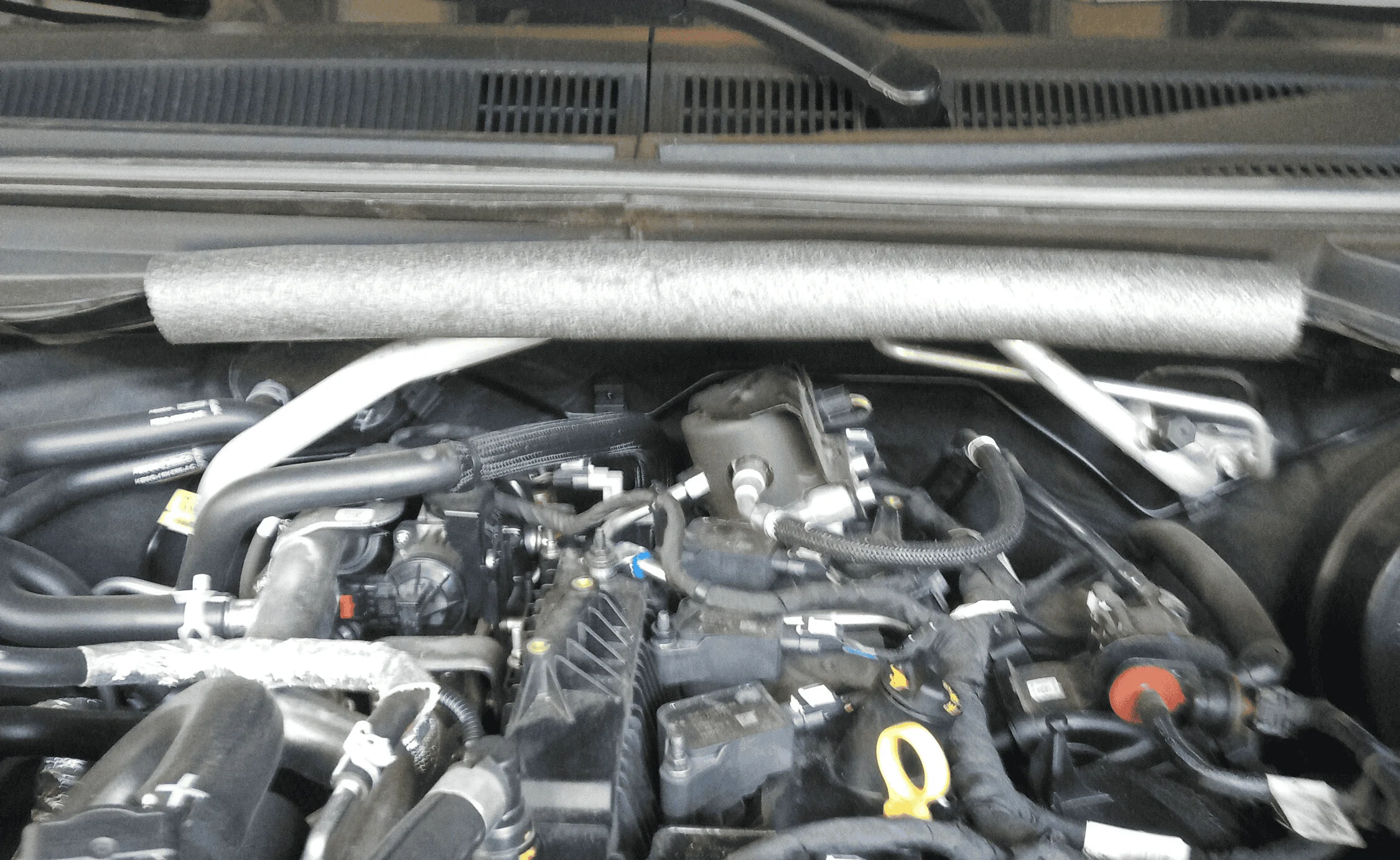

Got a good downpour yesterday while the truck was sitting in the driveway, so I'm going to take a peek at the engine bay before I roll off to work to see how my fancy new engine cover and the golf tube kept water off of things (or not).

I open my hood for the 2nd time since buying the truck 3 years ago. I need to further investigate the #4 plug. While I don't have problems "yet" there are signs on the coil pack of water staining and that one looks a lot cleaner than the other 3. I might just go ahead and replace the plugs and add a little Anti seize to them. At a minimum I will patch up the cowl as others have mention.
