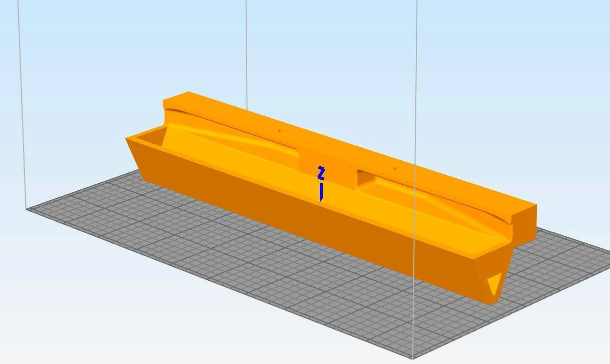

@ctechbob how long did you make the tray?
Jhbryaniv
Sep 19, 2022
2,788
7,470
2023 Ranger Tremor

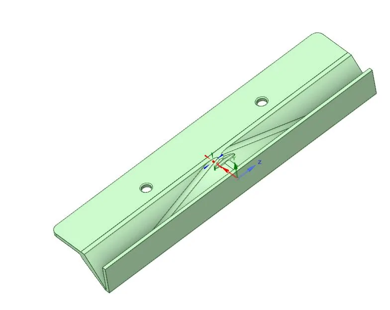

When I imported it into Solidworks it said it was like 80000 mm long - this one is ~ 9 inches not bad for a guess.
just spitballing this afternoon - it looks like your design hangs from the bottom of the sill piece there, if so this would capture the water running down those plastic bits. and direct it off to the sides. If it does not hang below everything, the plastic rivets could be replaced with SS hardware or the like and a couple washers to hang below and not worry about falling off.
I would have liked to add another support across the trough in the middle but got annoyed with the design. lol
I can export it into a bunch of different formats if you want to tinker with it (not sure if all the features will translate from SW well though. I like adding filets to everything lol.

Of course, like all advice this is unsolicited and feel free to tell me where to pound it lol
Lol, pound it...
Kidding....

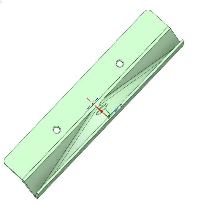

Yea, I have it so it sits under the plastic and metal, so suspended off the bottom. That's why you need either bolts or longer push thingees to grab it. The OEM ones are too short of course.
Did I not upload the updated one?
