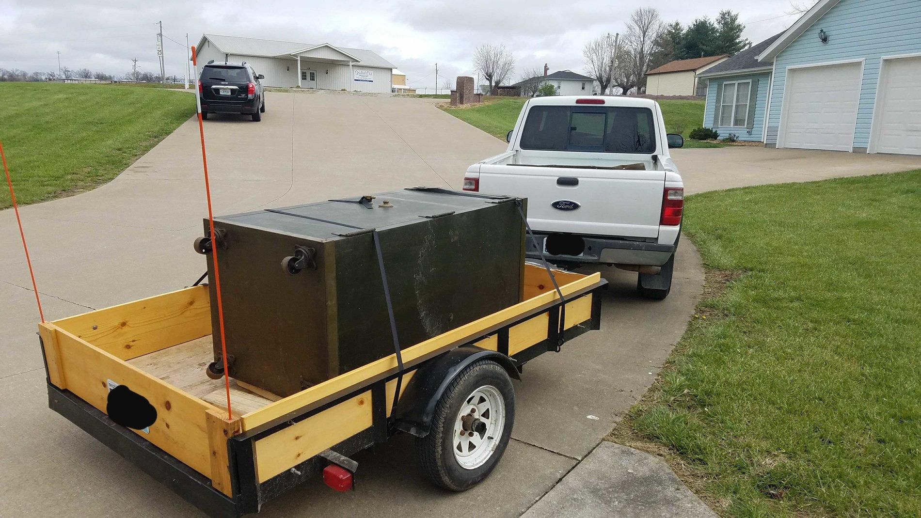

Not exactly like that but yeah its a fairly small utility trailer. Hes a picture with my previous Ranger:
RedlandRanger
Nov 14, 2018
44
5,192
11,362
Yeah, they look pretty similar - similar size tires anyway. I'd guess that is probably where the difference in hitch height comes from.

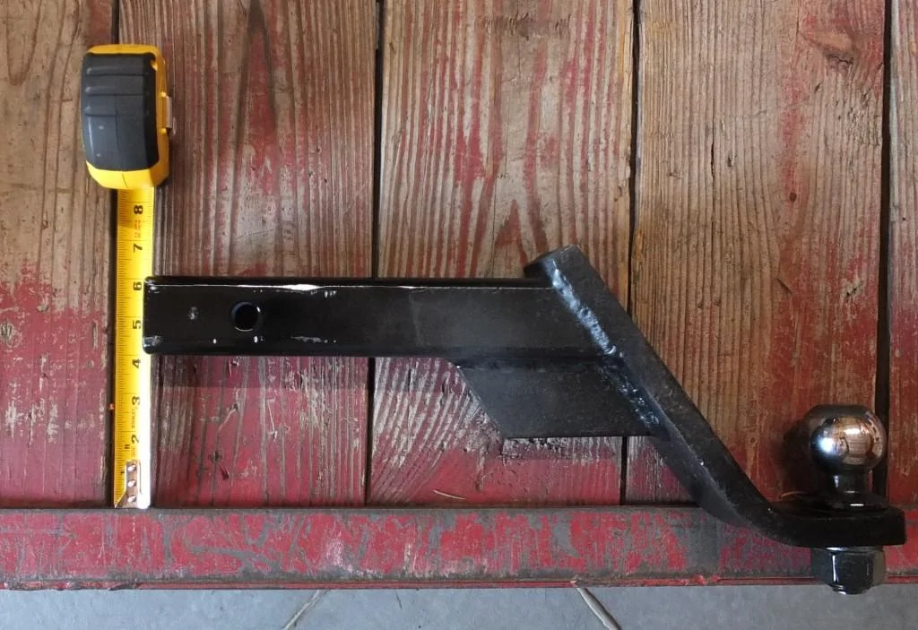

I've been using this 5" drop ball mount for about 25 years. It's made from 3/4" thick steel. I think it'll work fine but I'm not sure how much "squat" the Ranger will have with a load on it.
I just ground and repainted the end that goes into the received so it wouldn't rust up the hitch on our new Ranger.

Not that it matters, but that’s a 6” drop. They are measured from the top of the 2” square to the top of the flat part where the ball mounts.
Thanks! I learned something today. :thumbsup:
