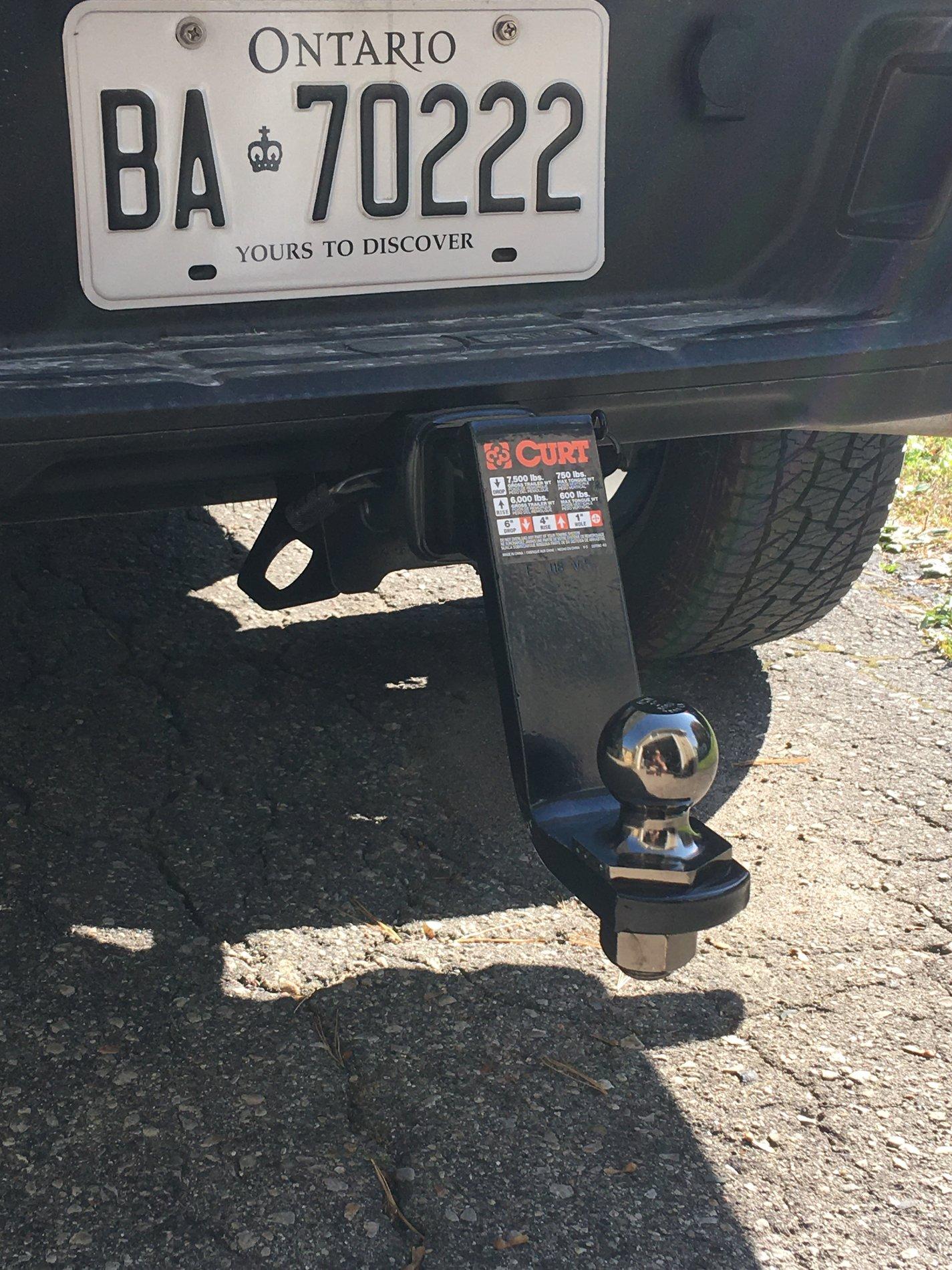

I went with a 6” drop Curt ball mount and Reese 2” forged ball and both match the Ranger’s tow rating of 7500lbs. I’m using a Reese Tactical pin to hold it on the truck.

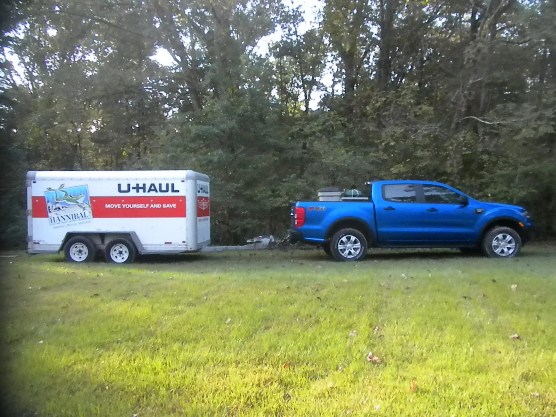

My first tow was to be a u-haul 12' trailer. So I went to u-haul to size up the trailer to the truck. Got a u-haul 3 1/4" drop. The squat on the truck was 2" with the trailer loaded. Looked pretty darn level. Pulled great no problems.

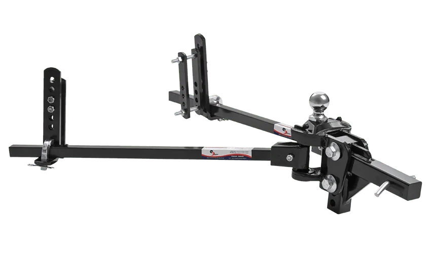

For light towing, utility trailer, etc I just use a standard Curt type drop hitch.
For the 19' travel trailer I use the Fastway E2 hitch.

This rig is very easy to swap out ball sizes and adjust for height. A little pricey, but everything was keyed alike and super user friendly. It's a good unit.
