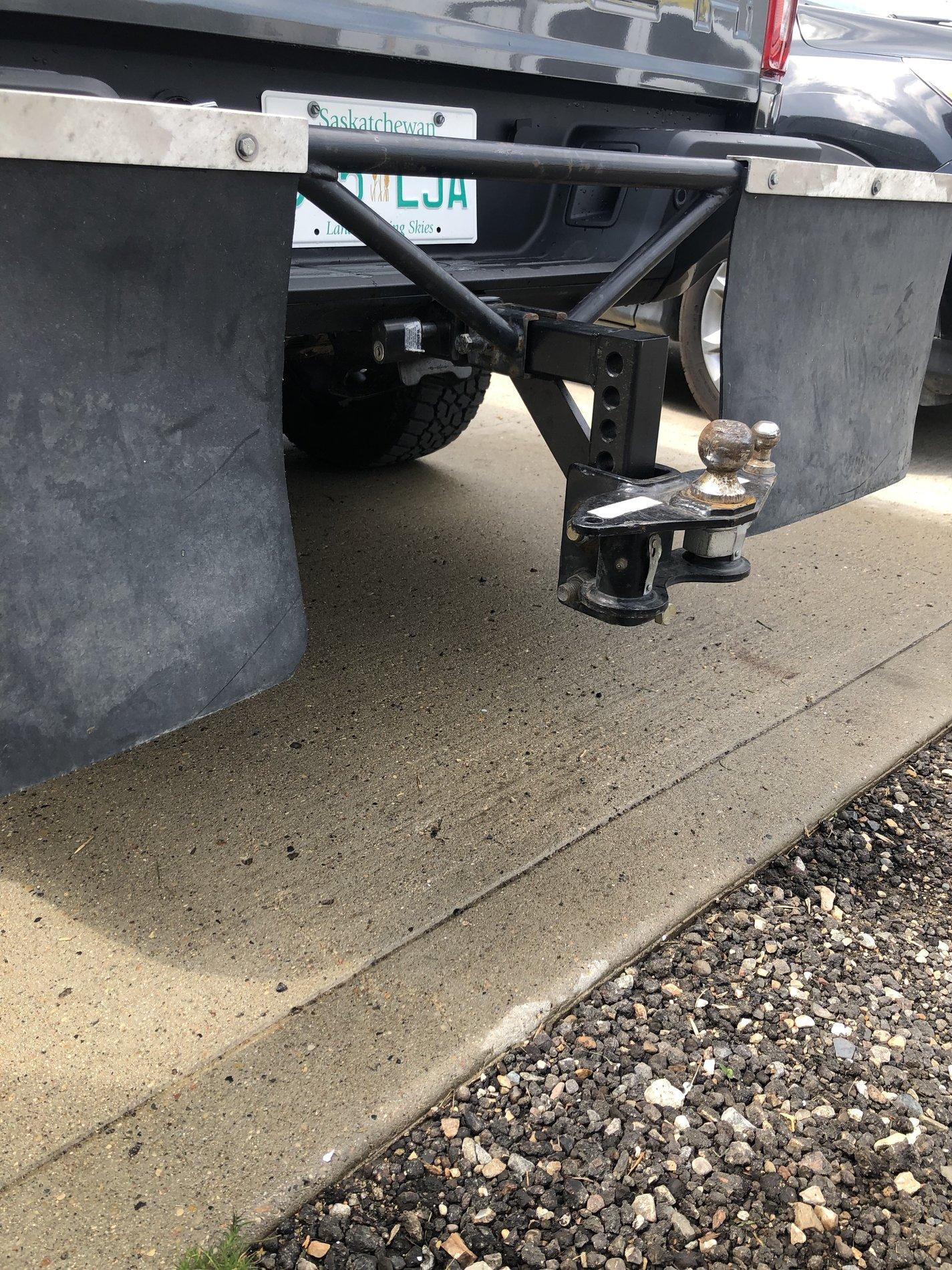

I like the aluminum hitch as I live in the rust belt and at work we tow a trailer 3-4 times a week and I got tired of hitting the hitch or using a 42 " monkey wrench to try and break the ball free to switch the balls . this was on a 10,000 lb rotating ball ( 2" , 2 5/16" ) steel hitch. plus I use to have a rv that did not have a very high tongue weight so this hitch took all the guess work out of it . as for the weight rating my ranger can only tow 7500 lbs so I think I am good with the weight rating on this hitch . I like how it is made as no one can remove anything on it when it is locked as all adjustment is done with a custom key . I have had lots of steel hitches and they are all impossible to re and re ball sizes if you have different size trailer balls .
works great for me and I never tow any more then 7500 lbs with it

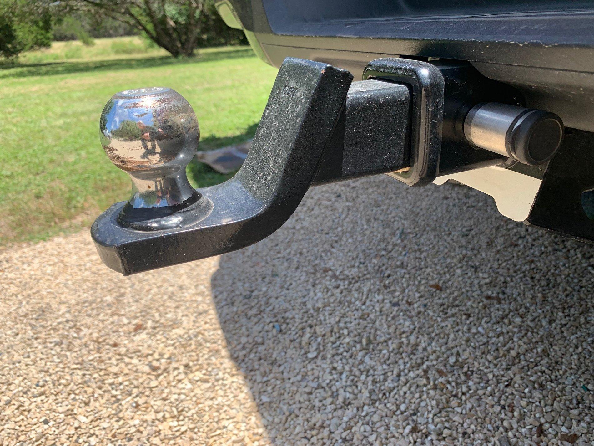

Always wondered why you would add a lock on the ball mount to keep it secure but The ball could be unbolted and moved. I have in the past added a weld tack to the nut to fix this. I found this when getting a new one for my Ranger. 7500 lb rated (same as truck) and ball is welded to mount, not bolted.

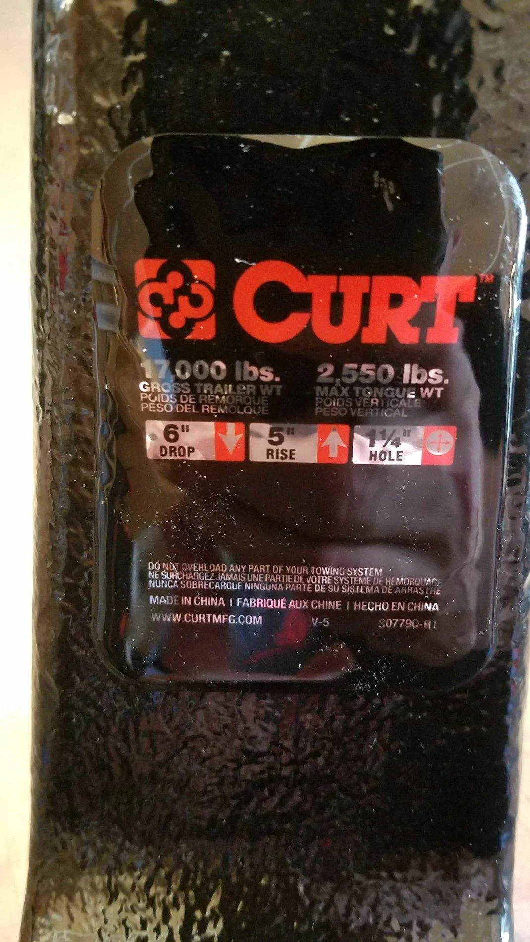

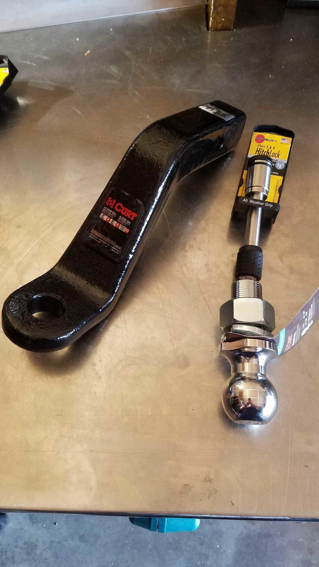

I ended up getting this beefy one piece forged steel ball mount. Curt Forged 6" drop, with a 1-1/4" shank and 2" ball diameter. The ball mount its rated for 17000lbs towing and 2550 lbs tongue weight so its very much overkill.
