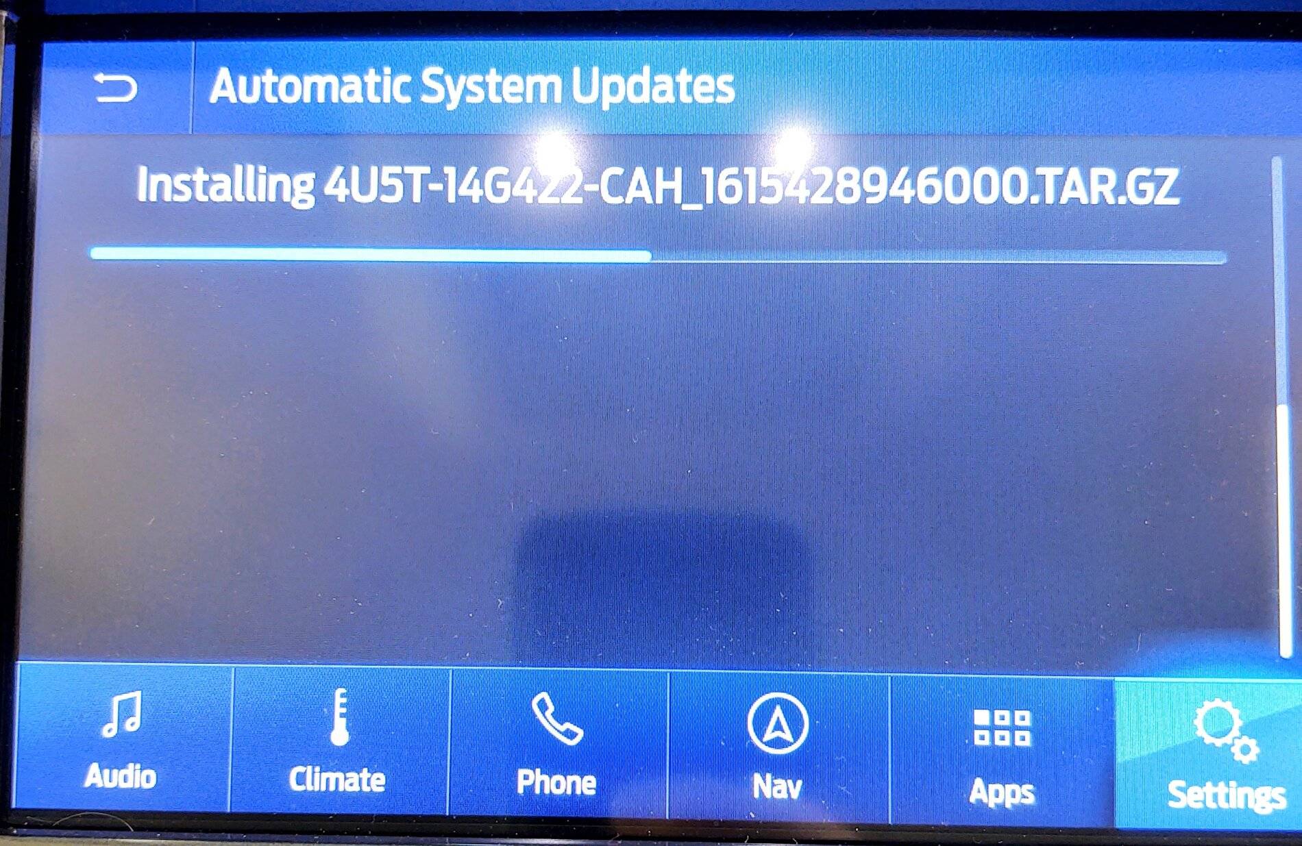

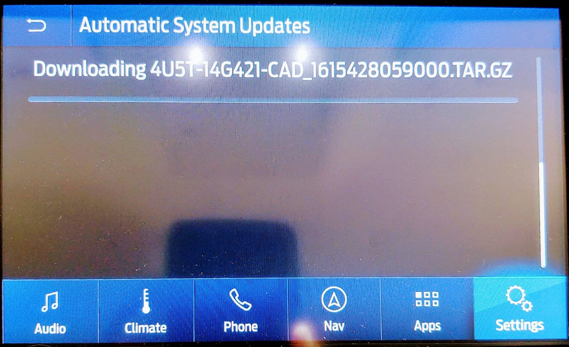

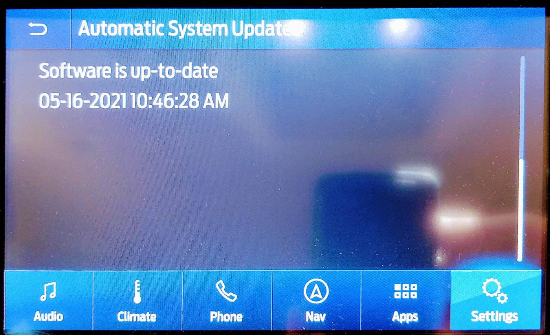

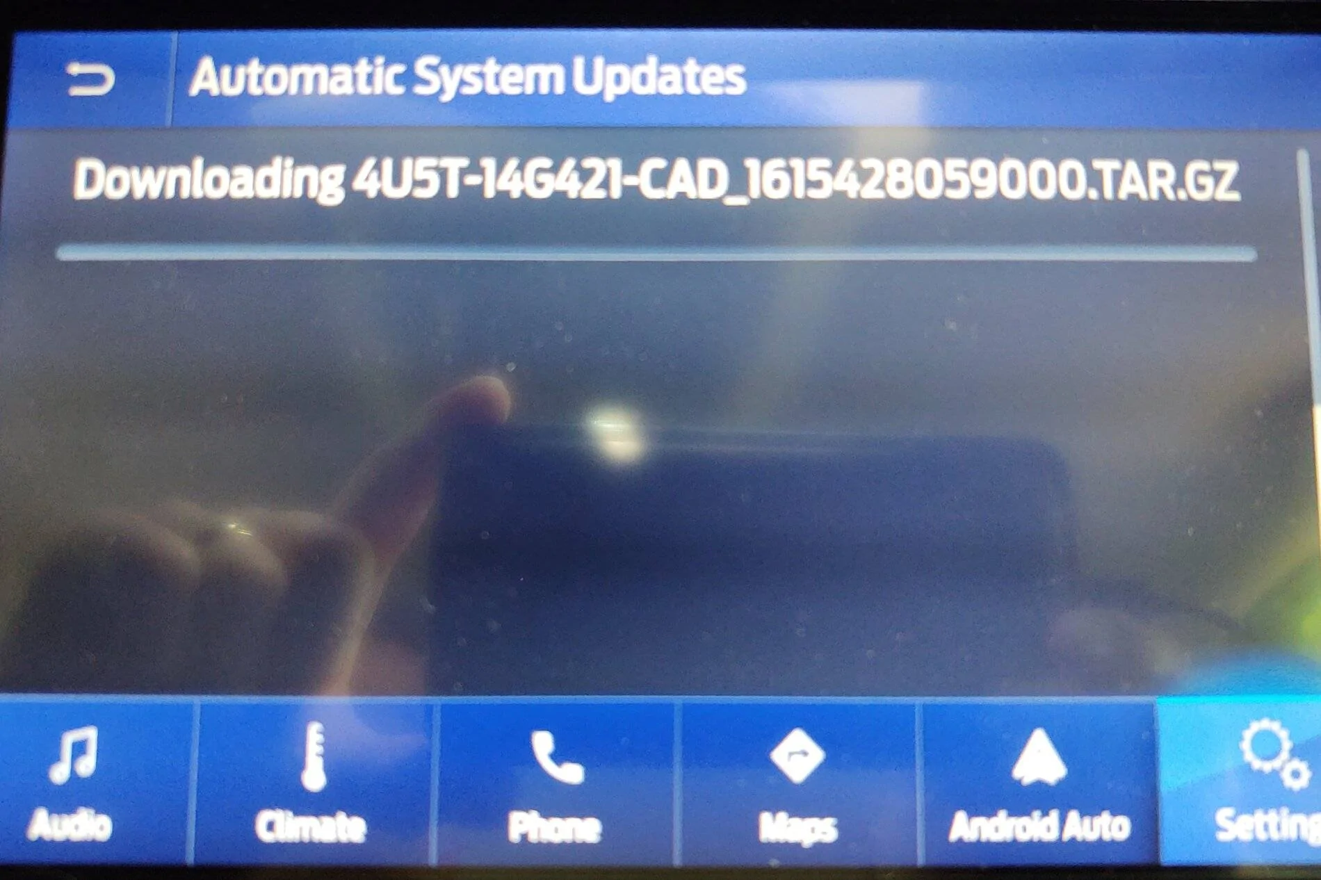

When I went to start my truck today there was a quick notice that my system had been updated. Took a look at the "about sync" ...must have updated on its own over the air, wifi, or voodoo, magic or by the UFO that landed in my backyard.
Currently: (I updated to 21020 v3.4 via USB some time ago) while Sync says I'm up to date... but this is better than what I experienced over WiFi previously - like 'computer gives blank look' response ?

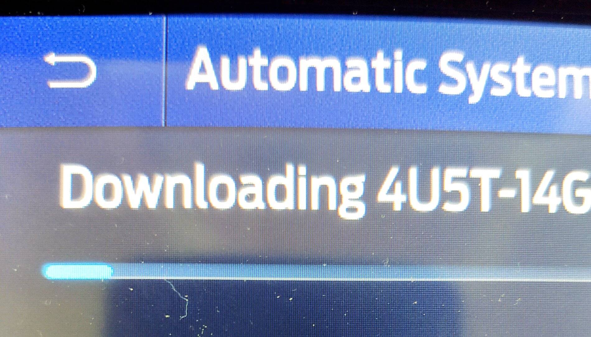

The lack of speed on that progress bar...?
Home stretch
And finally.
Been at this for a good while, but then... we start with another of the same one? ?

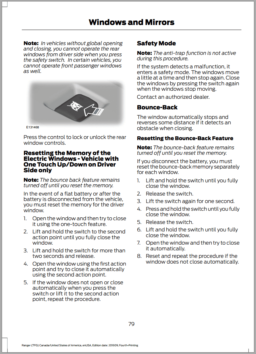

Well I was able to get this update downloaded in my garage over Wifi. Seems to went well other than now my drivers window doesn't auto roll down (still moves, just the auto part of it doesn't function anymore). Probably unrelated, but just happened at the same time
Side note, I did also just install my brake controller, but the only wiring I worked with was the Yellow and Blue pre-wire under the dash.

I had a similar issue in another vehicle after installing a remote starter in the same area as the brake controller wires are in the Ranger. Turned out that I had loosened a connector with about 50 wires on it. My window controls sometimes stopped working entirely, which was embarrassing at the drive-thru!

If you ever disconnected the battery, you need to re-learn the auto window function. It's in your manual.

Thank you @Gizmokid2005 I did disconnect the battery when I hooked up the controller. Didn't think it was feature in the manual. I'll give it a try!

Yup! I ran into that after I installed my ditch pods originally, I was like, wtf? Turns out our trucks need a relearn procedure for some asinine reason.

It's the anti-pinch functionality that causes this and is all but standard on any vehicle with one touch power windows. The pressure/voltage sensor in the window motor regulator uses volatile memory so each time it loses power it clears out the stored readings and you have to complete a full open/close cycle so it will re-learn. Only having to do one window is wonderful compared to both VW's I use to own. They had one-touch open close on all windows and to reset it the system was set so you could cycle one window at a time and it took 2-3 complete open/close cycles on each window before the one-touch would work again on any window.

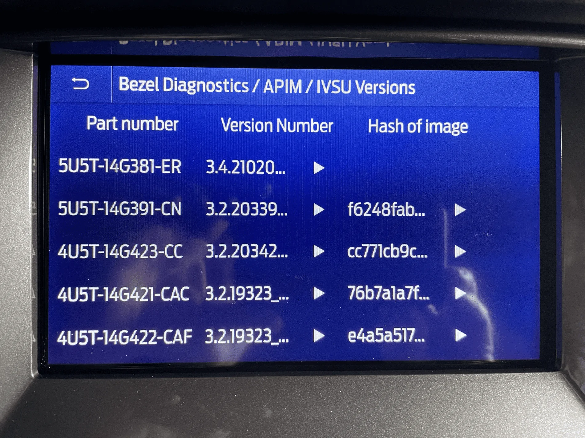

OK, I tried using the automatic update and it downloaded : 4U5T-14G423_CC
Now it says my system is at 3.4.2120 but I'm skeptical.....here is my IVSU screenshot - for those who've sucessfully updated what does your IVSU screen show?
UofMEngineer
Apr 19, 2019
516
334
20' Escape Hybrid,18' Fusion Hybrid
You have all 3 updated core packages for 3.4.21020.
Geoff
Oct 17, 2018
705
497
NYS
'19 Ranger 1943 Willys Jeep
Retired Engineer
Excellent....that was a pretty painless upgrade.
As usual UofM your help is greatly appreciated....Thanks !!!
