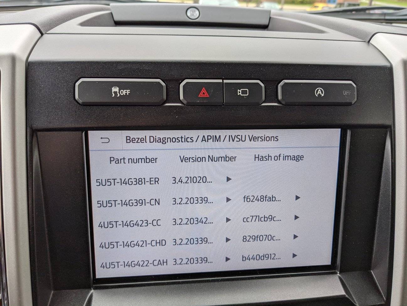

I guess I'm all updated. I just refreshed the update screen and nothing else wants to download. It wasn't the smoothest journey but it's seems to be complete.
I would suggest you check the IVSU files
Ya, that's what I was talking about several posts ago.
I can only see a few of them.
And, evidently, you can't 'scroll down' to see any more of them.
So, exactly what is it that you suggest to check?
A few specific files, or what?
Thank you for any help to let us uninformed to know all is well.
Thanks.
