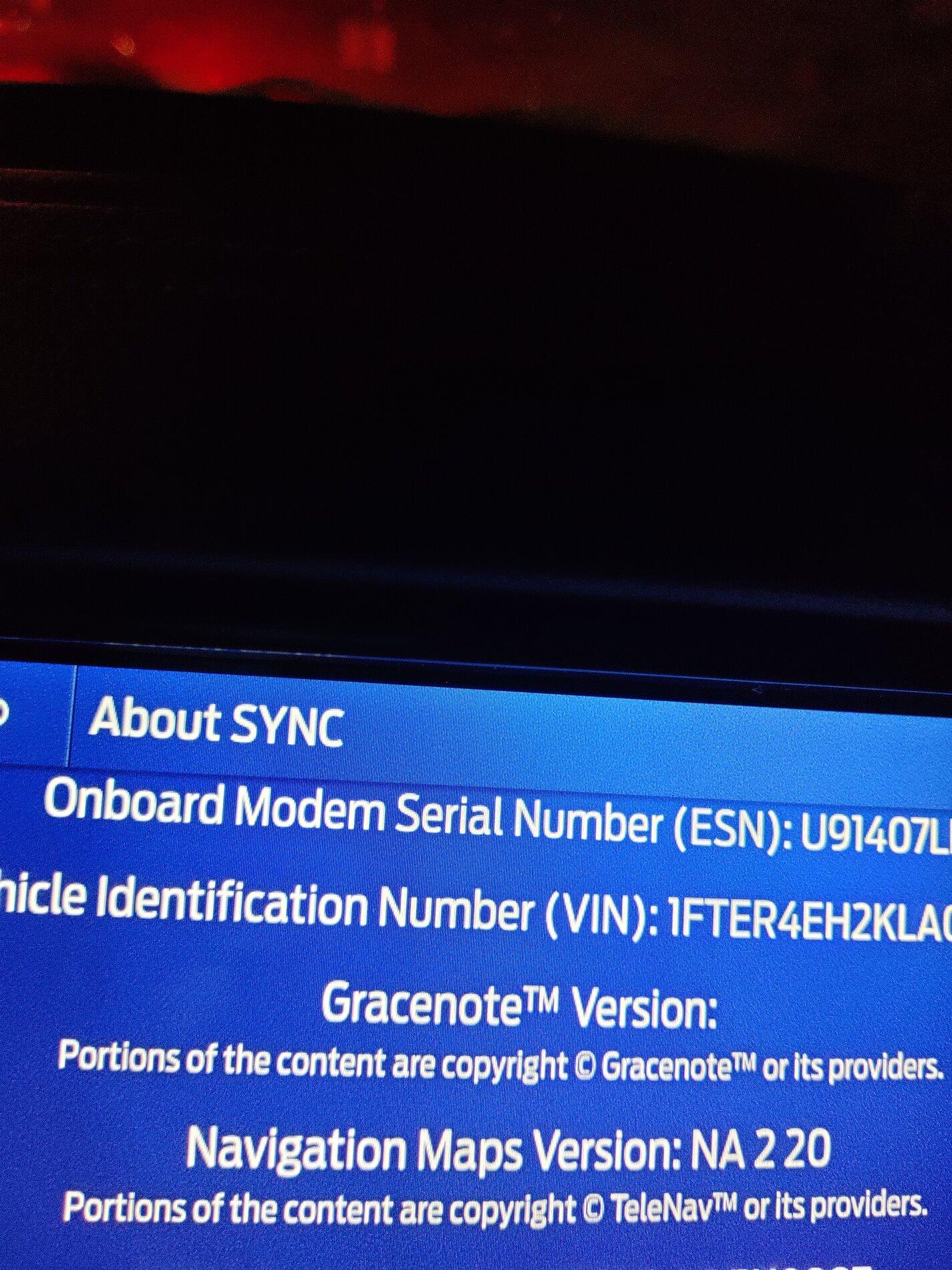

I was able to force the NA 2.20 map update by using the Cyanlabs North America 2.20 Map Installation (Stand-Alone) method.
At first it kept giving me errors and took a couple attempts to figure out that the tutorial is wrong and the map files needed to be in the SyncMyRide folder and not in the the root of the USB drive as the guide stated. Once moved to the folder the system updated the maps to NA 2.20 without a hitch.

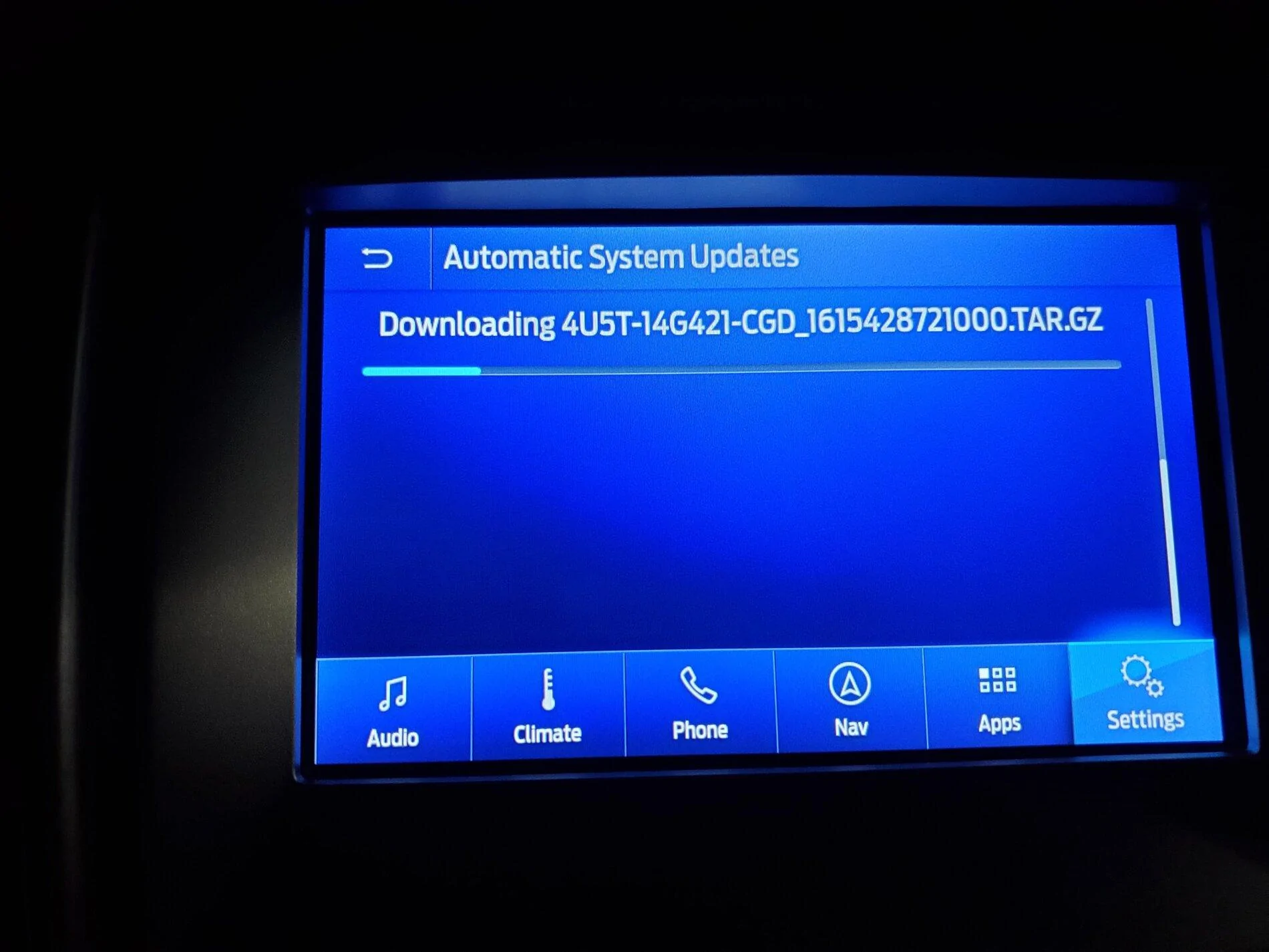

My truck has been struggling to download this file OTA for 3 days. Get's to approx. 33% and starts all over again. Wifi signal strength is NOT the issue.

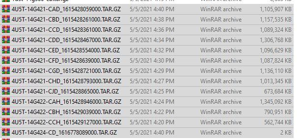

The NA 2.20 maps update contains 13 individual files and is nearly 12 GB (zipped) in total. All the file names are very similar so chances are your seeing it downloading different files and not realizing it. Other factors also impact the speed that are the WiFi link speed and protocol type. I have not looked to see what type it is using but based on what I have seen so far it's likely using 802.11g with a max bandwidth of 54Mbps. Ford also appears to have a bandwidth cap on each download session as even using the Cyanlabs updater to download the files takes about 15 minutes on a gigabit fiber connection.
These are the 13 map, voice, and license files that make up the NA 2.20 update.
