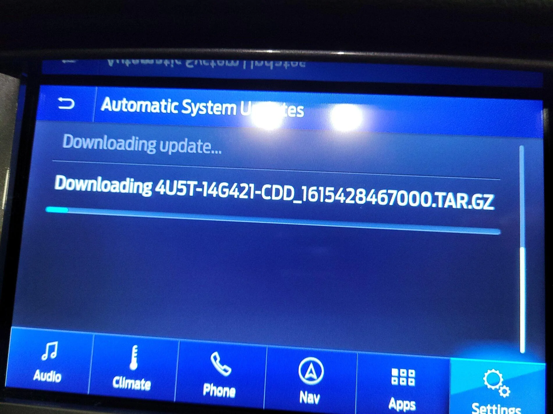

The OTA updates are still going for me... but, the Nav is at NA220

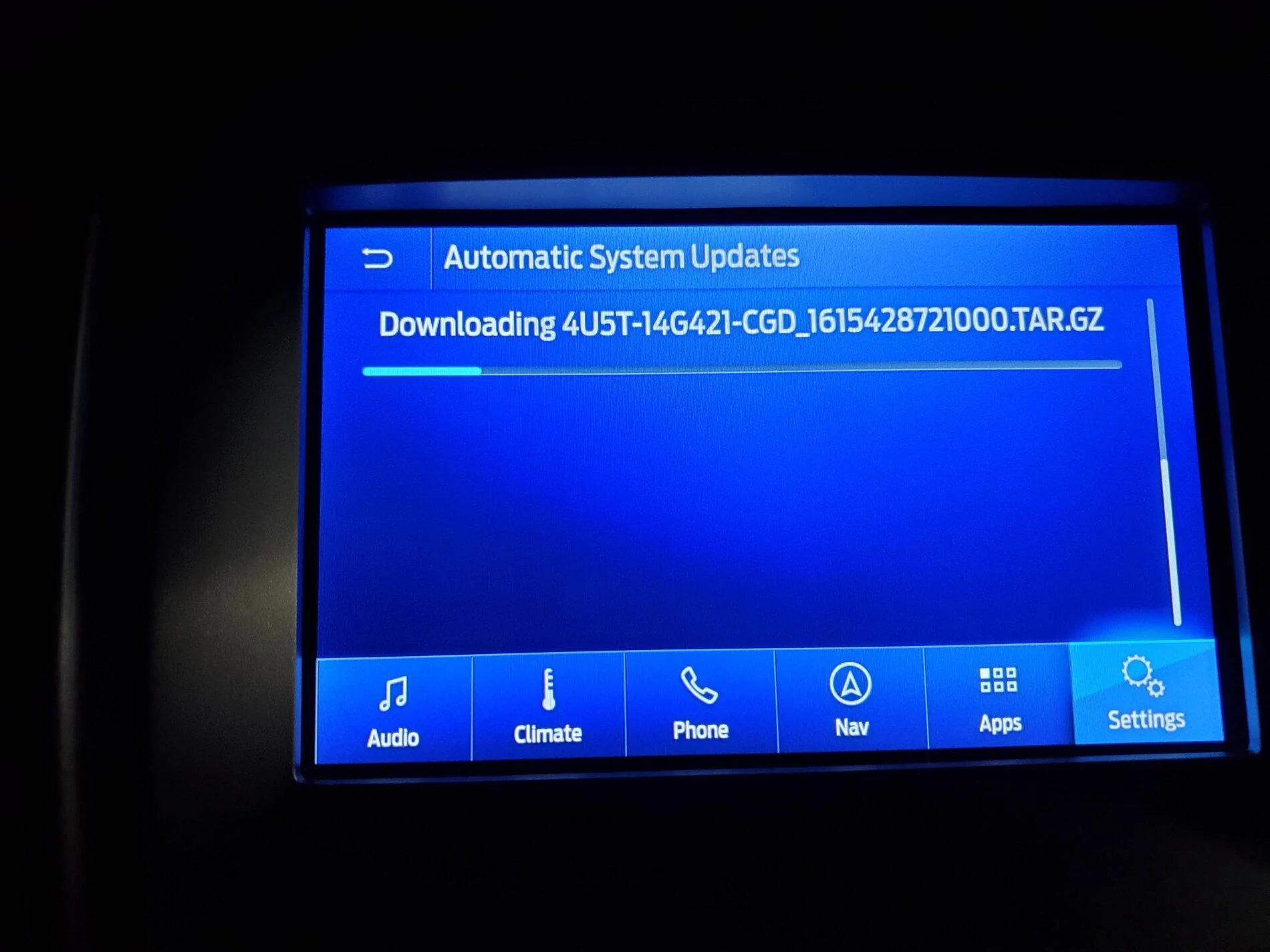

Mine also is at NA 2 20, but is still downloading updates. Going on day 3.
Took two days for me but I kept going out and cycling the key. I think I read in the owners manual it would continue to download for about 30 minutes after it is turned off. (For the map to update to NA 2 20, OTA)

This Sync update is only available for download off the Sync website. Maps and voice will update OTA.
Incorrect.. my 2019 has updated to the newest version of Sync and now updating the nav to 220 all completely OTA in the past couple of days... still downloading/installing the map files but the version changed to 220 this yesterday.
