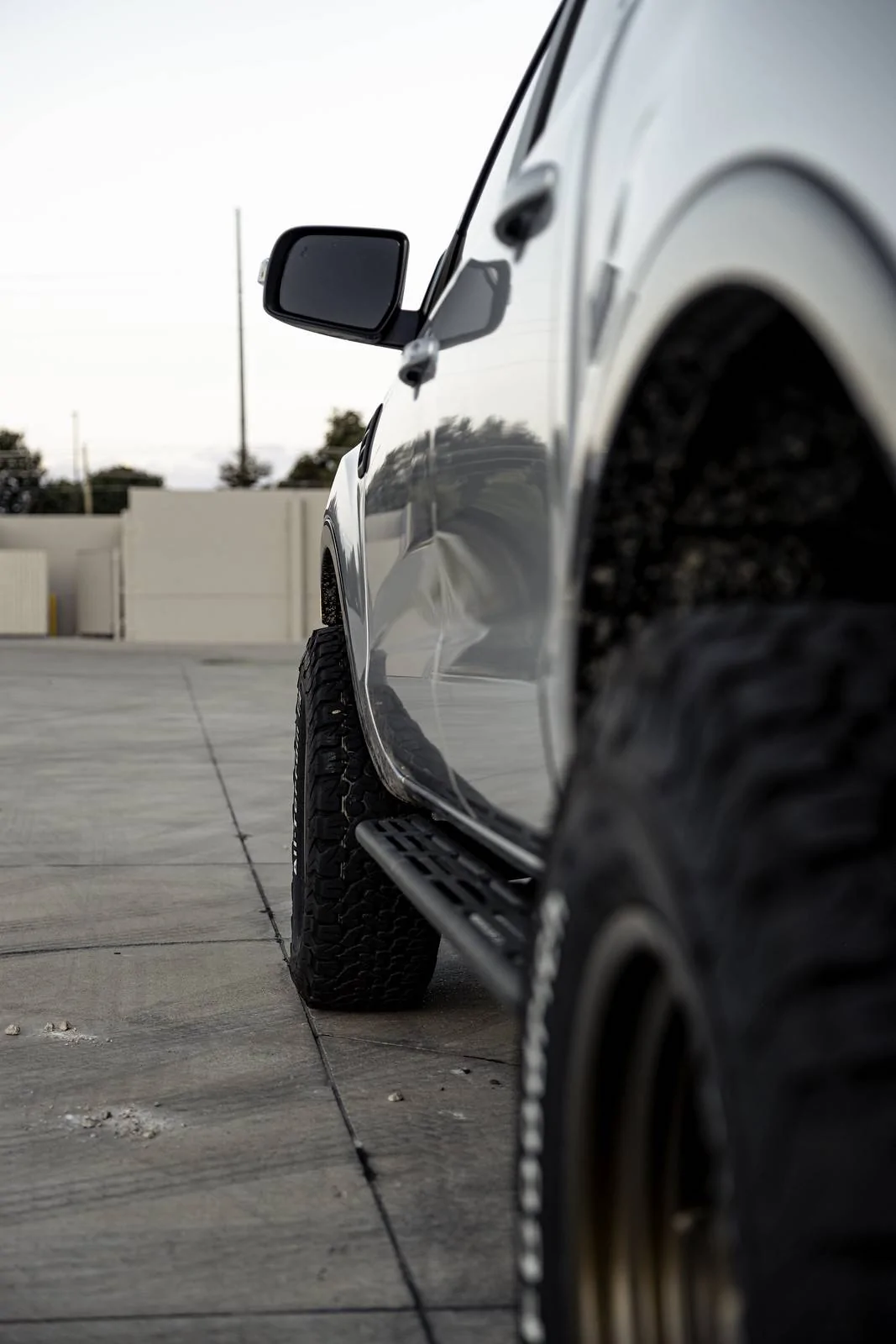

I know this is a thread for those metric 33's on 17" wheels... but I thought I'd throw my 16s setup in the mix...
- Old Man Emu (Heavy Load) Suspension Kit
- Total Chaos Fabrication UCA's (to regain caster)
- Black Rhino "Arsenal" Wheels in Sand on Black (16x8 and -10et)
- Goodyear Wrangler Duratrac tires (285/75R16)
The front crash bars had to be cut for clearance, but I've torqued and twisted it a lot and have absolutely no rubbing at all, on or off road. My MPG hit was about -3 on the highway and -5 in town. I don't feel the need to regear or anything, as the turbo and 10-speed never seem to miss on finding the powerband I need.
