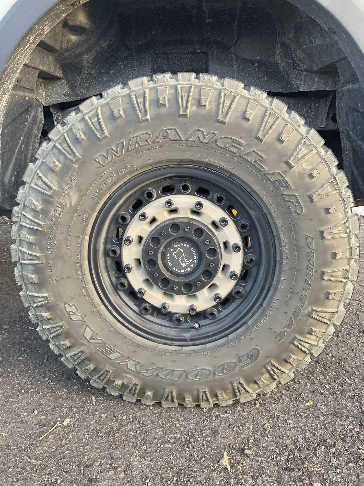

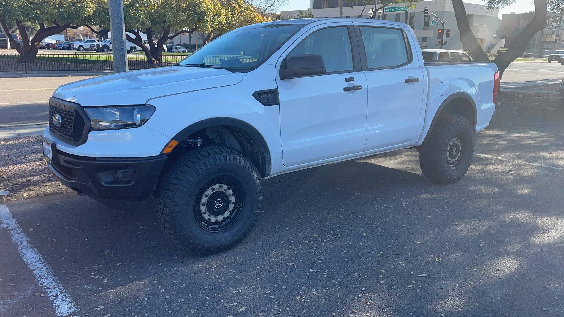

I know this is a thread for those metric 33's on 17" wheels... but I thought I'd throw my 16s setup in the mix...
- Old Man Emu (Heavy Load) Suspension Kit
- Total Chaos Fabrication UCA's (to regain caster)
- Black Rhino "Arsenal" Wheels in Sand on Black (16x8 and -10et)
- Goodyear Wrangler Duratrac tires (285/75R16)
The front crash bars had to be cut for clearance, but I've torqued and twisted it a lot and have absolutely no rubbing at all, on or off road. My MPG hit was about -3 on the highway and -5 in town. I don't feel the need to regear or anything, as the turbo and 10-speed never seem to miss on finding the powerband I need.

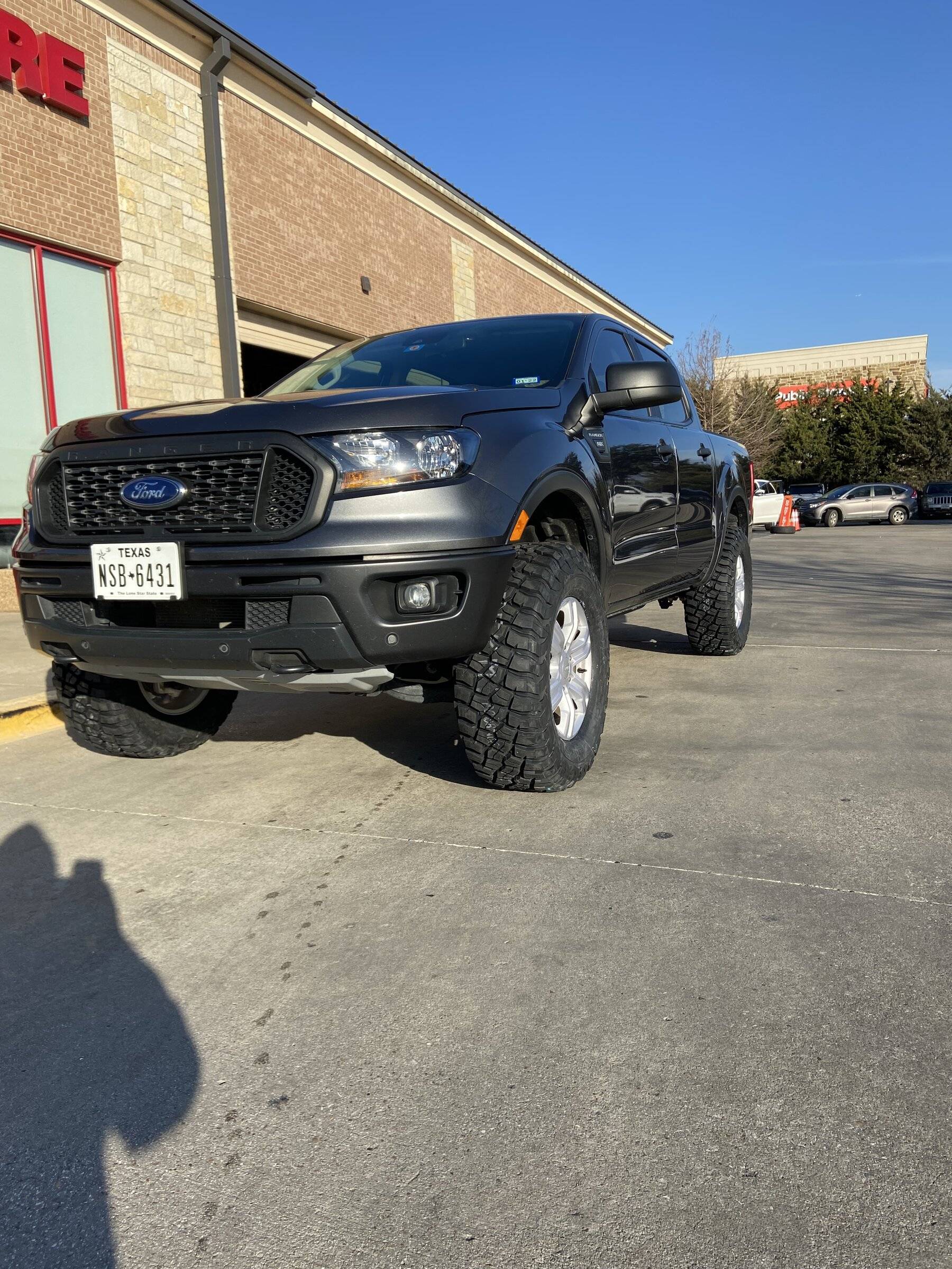

285/70/17 BF KM3 muds on stock wheels
1.5” spacers
2.5” RC plates
Front crash bars rubbed at full lock, mostly drivable though. Had to cut them.

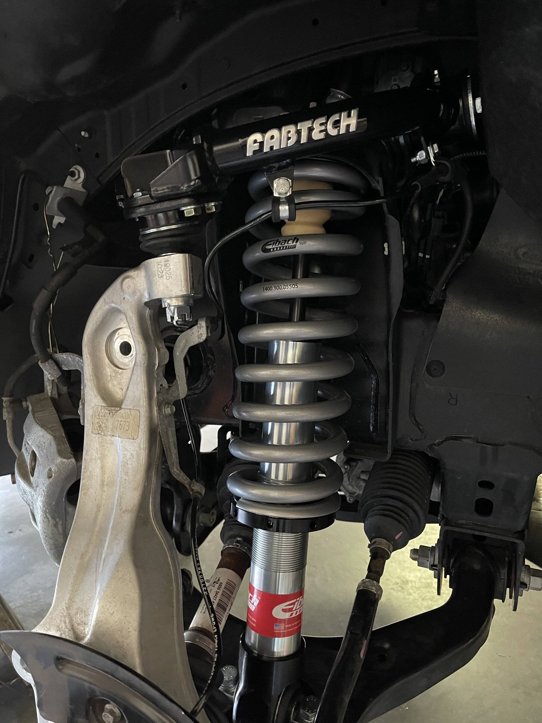

Eibach 2.0 stage 1 adjustable coilovers up front set at 3.5 inches
Eibach 2.0 stage 1 rear shocks
Fabtech upper control arms
Fabtech rear 1.5 inch lift blocks
What lift and suspension you are using?

Thanks for the pics I have Fox coil over in the front, with superlift suspension 3.5 inch and Eibach in the rear. I'm going to thesame as you have in the near future in the front setup. I think it is better without the spacer. Did you do a diff drop?
