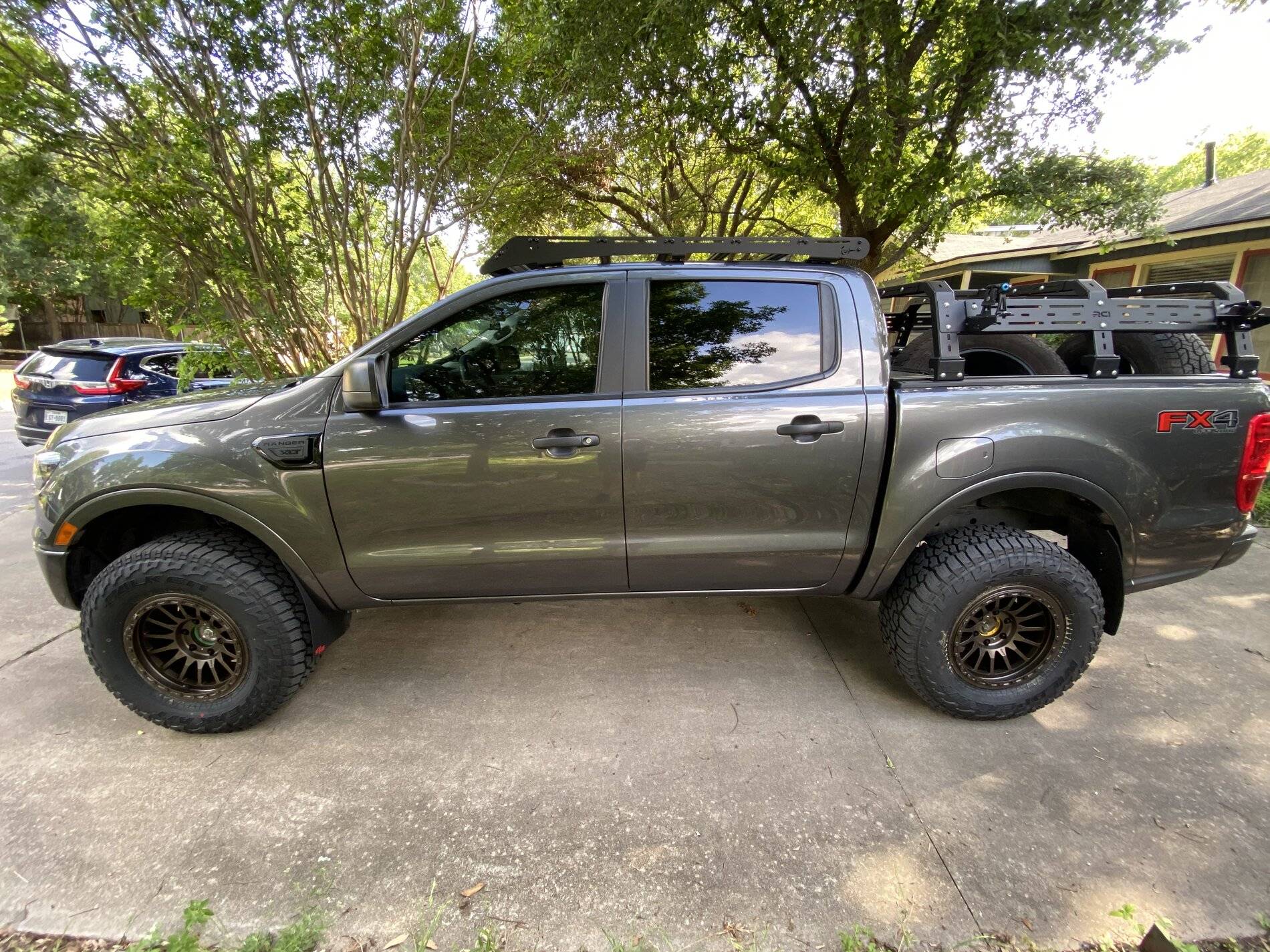

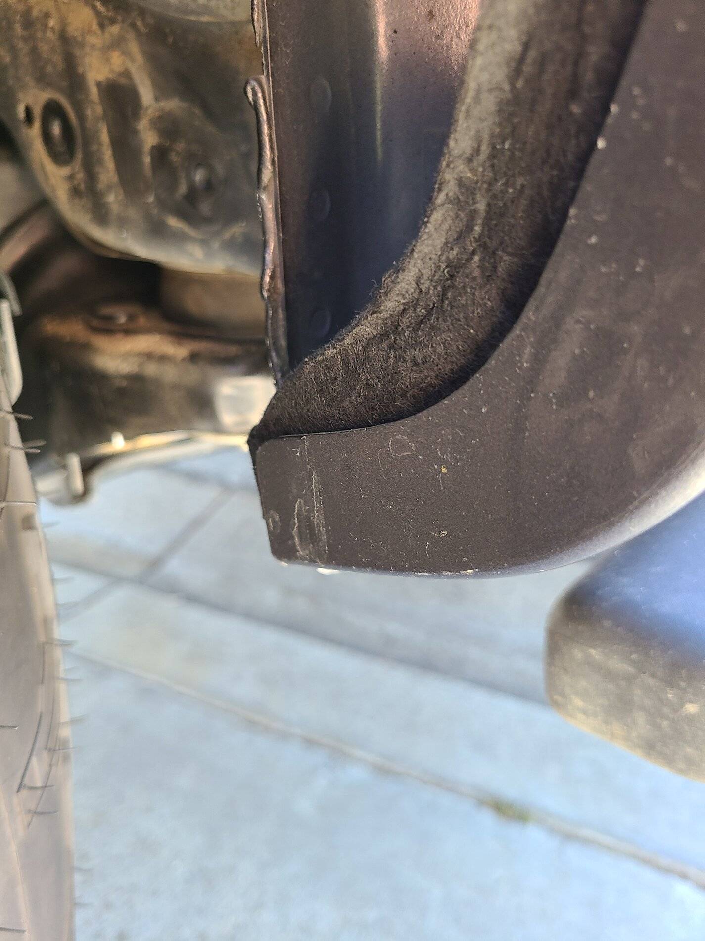

Could one of you guys that is running 33's without any rub do a measurement from center of fender to center of wheel for me?
I got mine mounted and I'm just barely rubbing the felt liner and mud flaps in the back of the well with the bars out. Going to raise my Fox coils up more but didn't want to guess at how much more I needed.
Wheels there will do it!!! I'm not sure what your offset is but it is doing the job for sure!! I myself am running factory wheels with no spacers and only touch the sway bar at full lock!!!

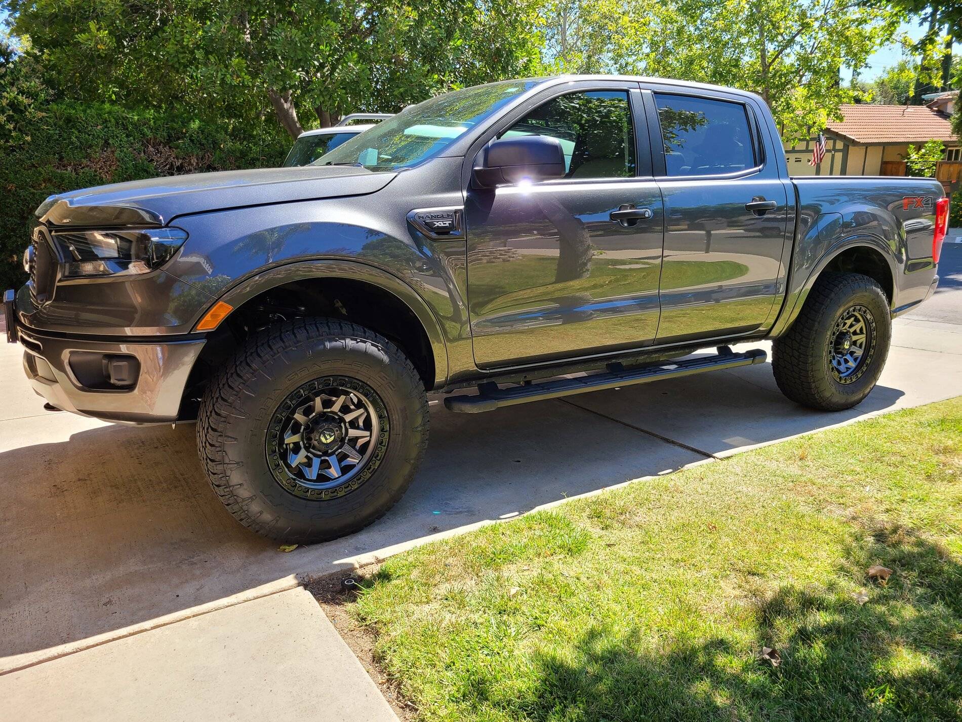

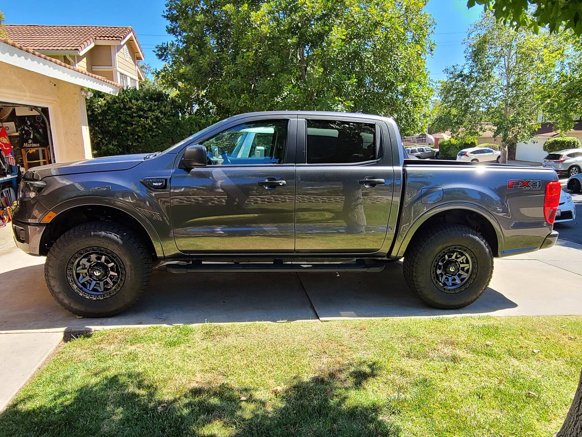

Hello all, I just ordered some method 704 17/8.5 and 0 mm of offset. I am looking to run a 285/70/17 KO2. I have a 2.5 inch rough country leveling kit on the front. Does anyone know how much rubbing I may encounter? Will I possibly need to remove the crash bar or replace them with the aftermarket ones?

With that offset, you are definitely going to need aftermarket crash bars running that size tire.

Do you have a recommendation on which one to go go with?
From all the reports here, only the stock wheel (+55 offset) with 285/70R17's will clear with the stock crash bars with a 2.5" lift. Even then, some tires won't clear the knuckle and people ran a 1/4" spacer to clear. BFG's have been confirmed to clear the knuckle.
Wheels with a +20 to +30 offset are known to work well with aftermarket crash bars. Many with 0 offset wheels had to remove their crash bars completely.
I would suggest reading through the Tire Size Fitment Master thread to get a better idea of what works with the various offsets and tire sizes.

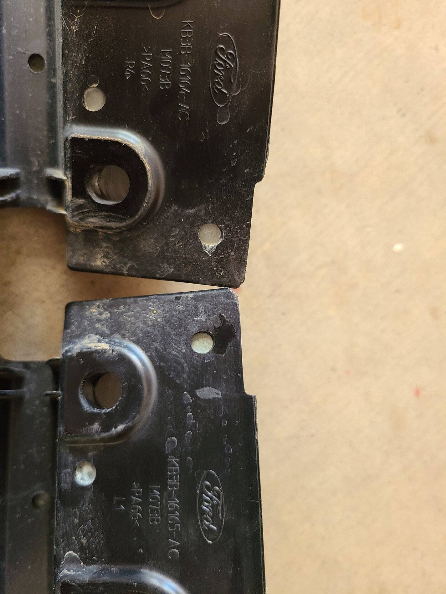

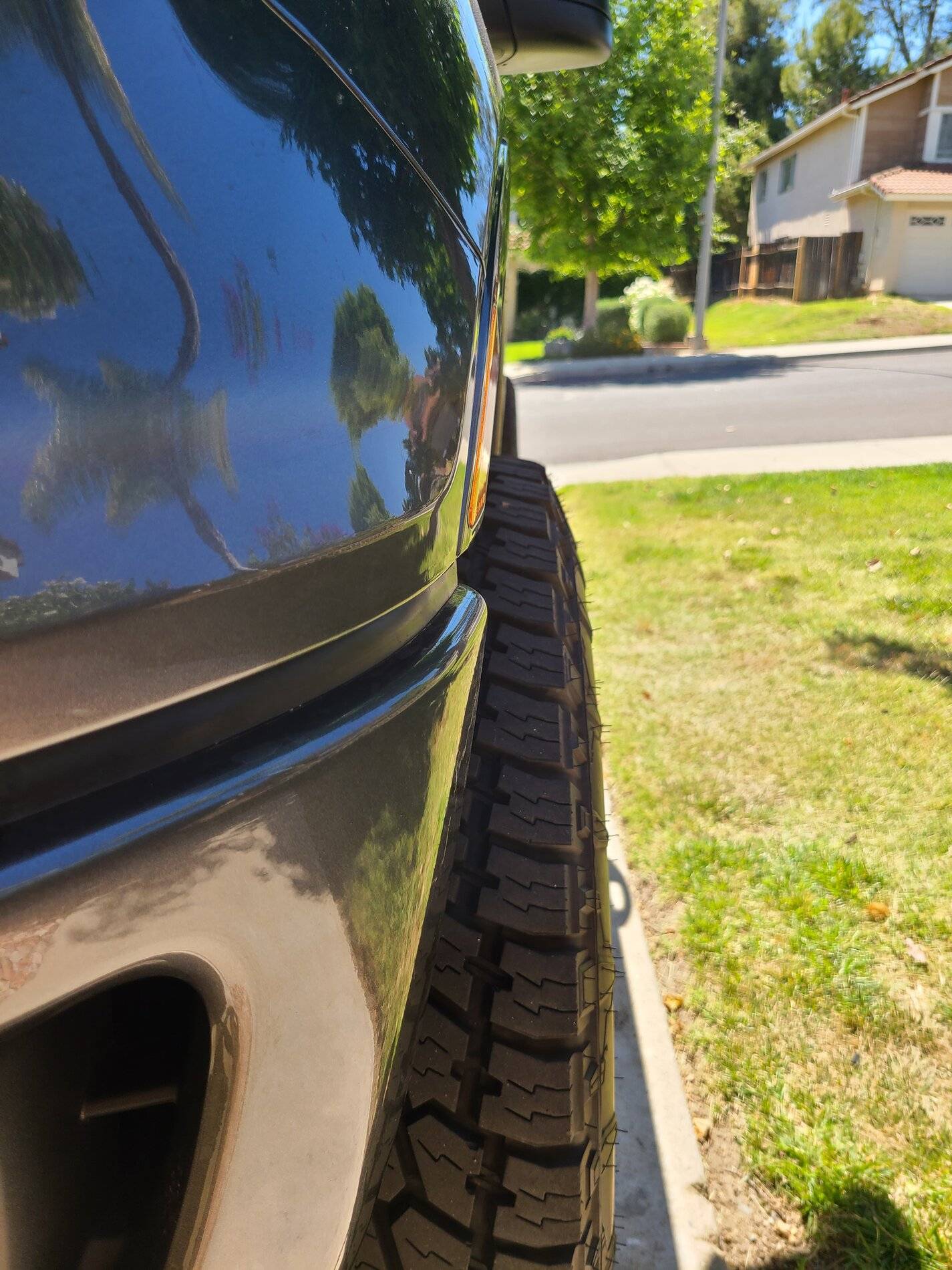

Here's mine, I have a 295 /70R17 with 0 offset, the bars are deleted and the plastics block behind the front tires is gone as well, I cut the felt liner but you don't have too, some of the guys here can chime in. The plastic block has 4 screw at 13mm. I had a bit of rubbing on the fender flare and I'm going to shave that off a bit

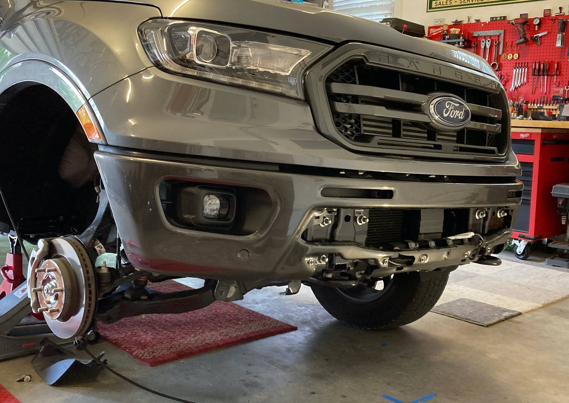

One more question for you, any advice on the removal of the stock ones?
bfastr
Bob
Apr 20, 2021
244
996
Nashville
2021 Ranger Lariat
I just installed the Readylift beams myself, today. they are awesome.
The printed instructions walk you thru the rear beam removal.
For the front, remove the lower valance. 5 bolts on bottom, and a bunch of clips, also some pull pin clips under the upper opening thing. just pull it off the front, then you will see three nuts ( on each side) holding the bumper on. loosen them all. but only remove two on each end, then run the last one out to the end and you have plenty of room to pull the bumper forward and the front bars will slide right out without the bumper falling off.
