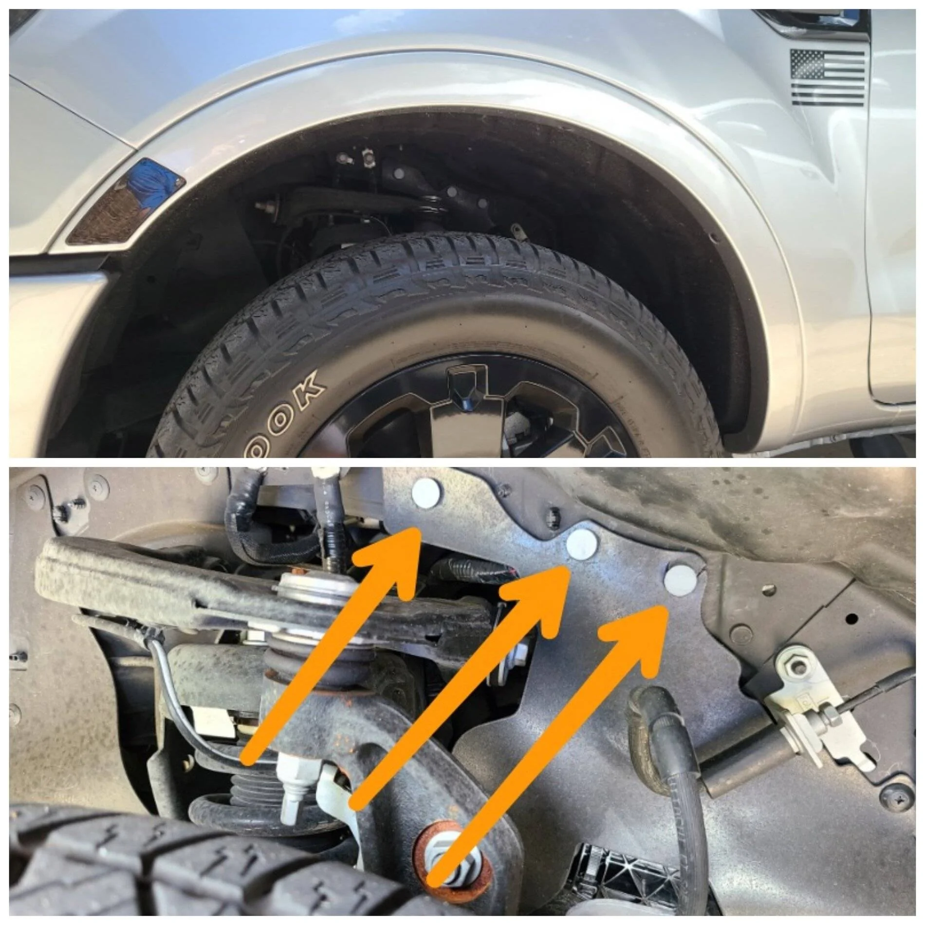

Pulling those pins to change the filter sucks. I might try some strong magnets epoxied to the liner.
Good call on the adapter Trigg. I forgot about that
I did just that (last oil change). I only needed three of those jokers pulled to get my business done. I was tired of messing with them.
I used the super strong neodymium magnets on the frame of the truck, and then I "sandwiched" the liner between those, and some round, black magnets.
800-miles later... haven't moved a bit, holding like a champ ??

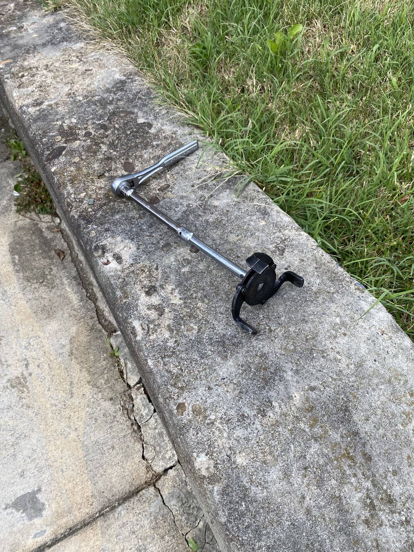

Can anyone confirm the oil filter cap wrench for the OEM Motorcraft oil filter FL910S? I've seen 14 flutes and 15 flutes and also 73mm and 75.5 or 76mm
14 flutes. Probably 73mm but 74mm appears to work no problems.

I just did my first oil change a few days ago and removing the oil filter was very painful. It was on TIGHT and there's not really any room in there to use a strap wrench or a band wrench (all I had at the time). I ended up struggling with the band wrench for over 15 minutes before getting the filter loose enough to twist off by hand. I ended up buying a 76mm 14 flute cap wrench for next time. Fits the Mobil 1 M1-102 filters I use.
Did you use 3 or 6 maginets (3 on frame, 3 on flap)? What size are they?
