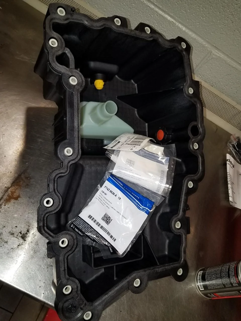

I thought this would be a good place to post this. Me and another tech were discussing the 2.7 oil pan on a F150 he was working on. Ford makes these out of a polymer plastic and are having leak issues. Our thoughts were because they don't use a gasket, just a sealant.
Also, they're 2 different materials which expand and contract in different ways. As far as the new Ranger's 2.3 I can't say what's on that.
Just don't be too surprised if you look under there and see plastic. Hope they got it right.

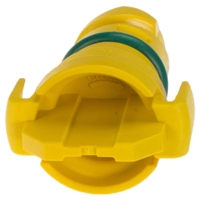

And someone mentioned a drain bolt? Well the yellow part in the picture is it.

Same style drain plug that 6.7 PS diesel uses, My 2.7 has 67k now and no issues yet.
