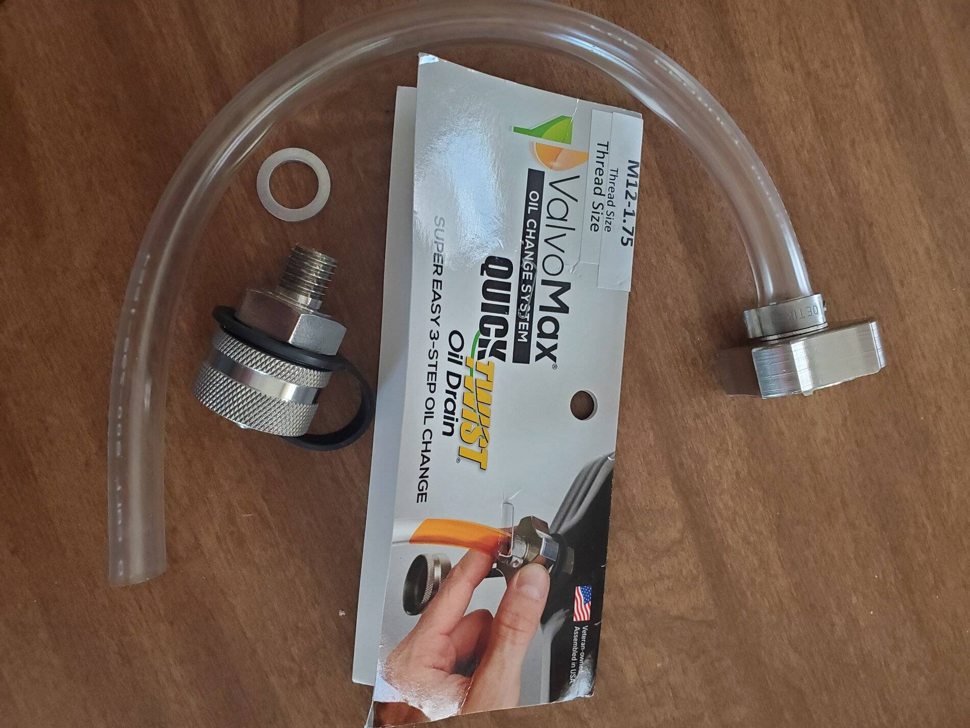

Did you need the extension as mentioned for the other valve? Thanks!

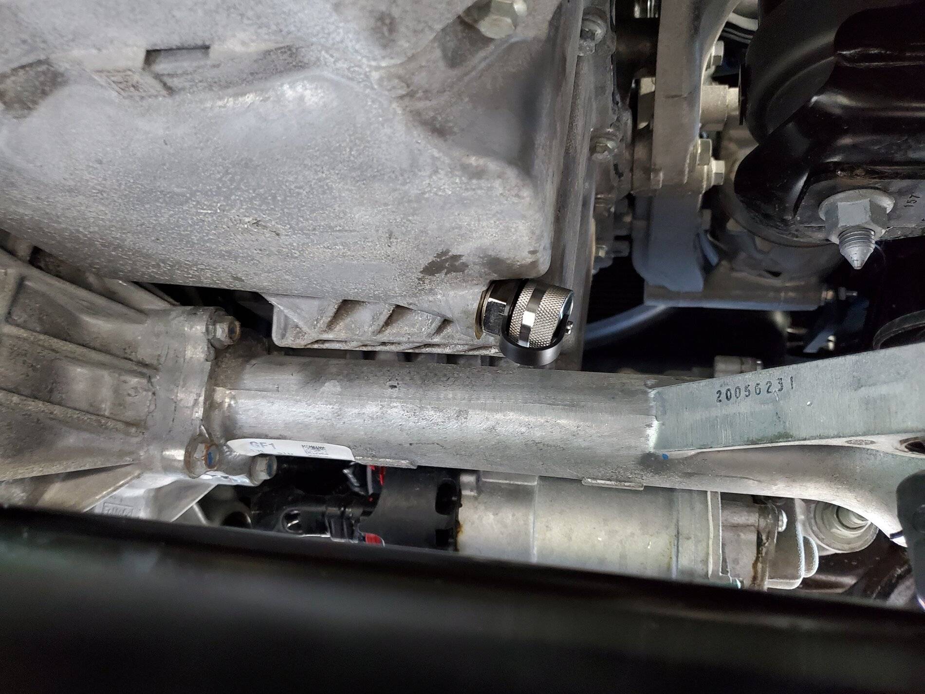

No the Valvomax valve simply replaces the drain plug no extra joints to leak. See picture.

I just wanna make certain the size is M12-1.75 that your link takes us to because Amazon says it dosen't fit the Ranger. It says the M14-1.50 does. I don't trust Amazon.
This is yhe one I got. M12-1.75 is correct

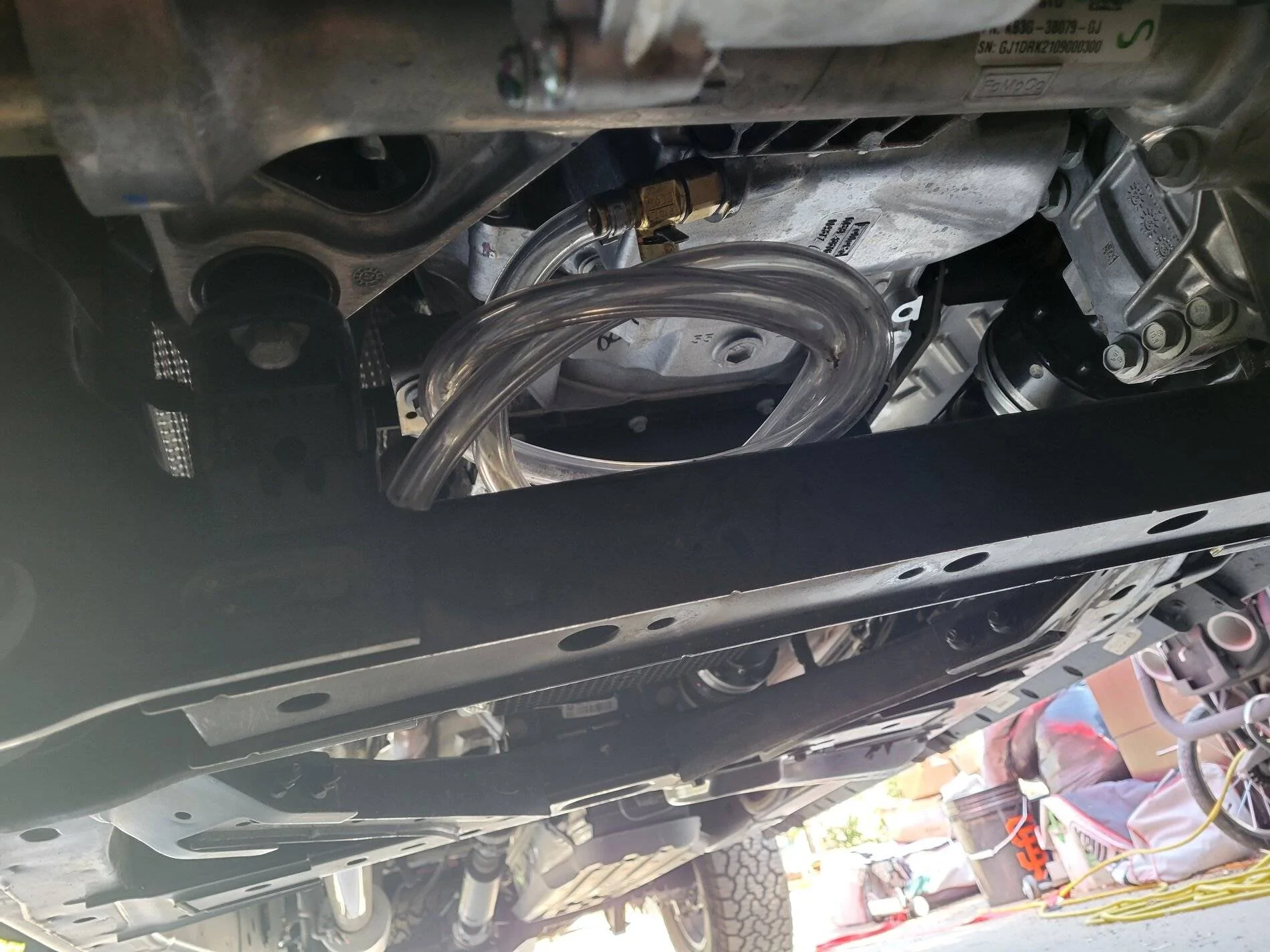

For the Fumoto attachment, do you all leave the leave the tube attached or pull it off each time? I've watched a couple videos and it seems like you are suppose to remove the tube when done and close the cap back up.
I leave mine attached. Here you can see it coiled up without the skid plate attached:
Once the skid plate is reattached, it sits basically on top of the skid plate. I attached the hose to the valve using an oetiker clamp. I think it was a 17, but might have been a 15.7. I use them all the time for business, so used what I had laying around.

In all seriousness, that is just the picture after it was first installed. I haven't drained oil into the tube yet. Just did my second oil change on my Ranger. Tried to install the Fumoto on the first oil change, but didn't realize I needed the extension adapter until I was doing the first change.
If oil in the tube causes me issues moving forward, I will put a ball valve on the end to close it up after the oil change.
The size is 12mm-1.75
You need to make sure and select the L4 2.3 engine not the L5 3.2 engine. That one uses the M14-1.5 valve. Our 2.3 uses the M12-1.75 valve.
